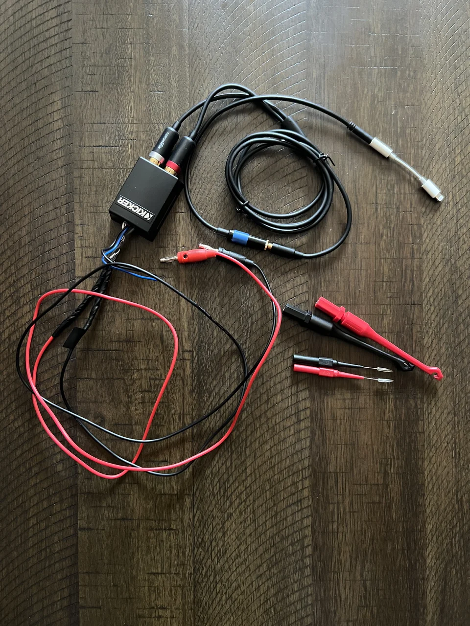

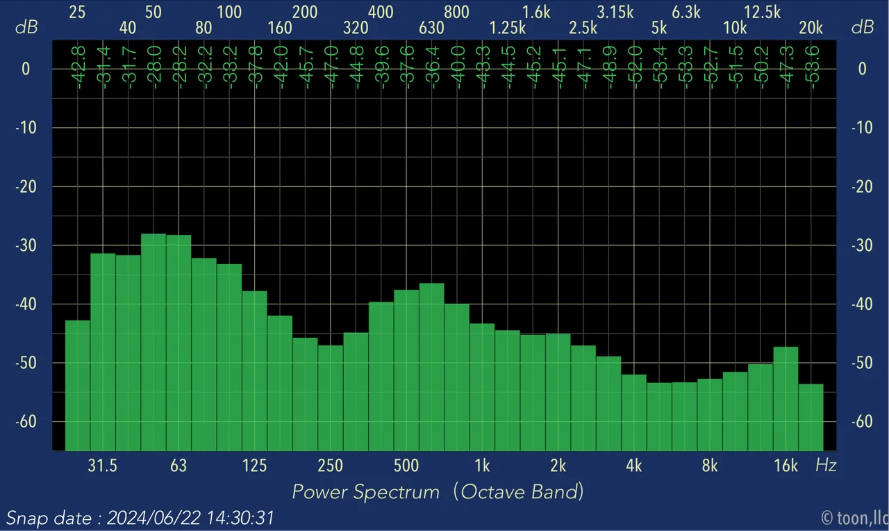

Here’s the full signal measured on a 2024 CX-5 with Bose audio with no adjustments.
