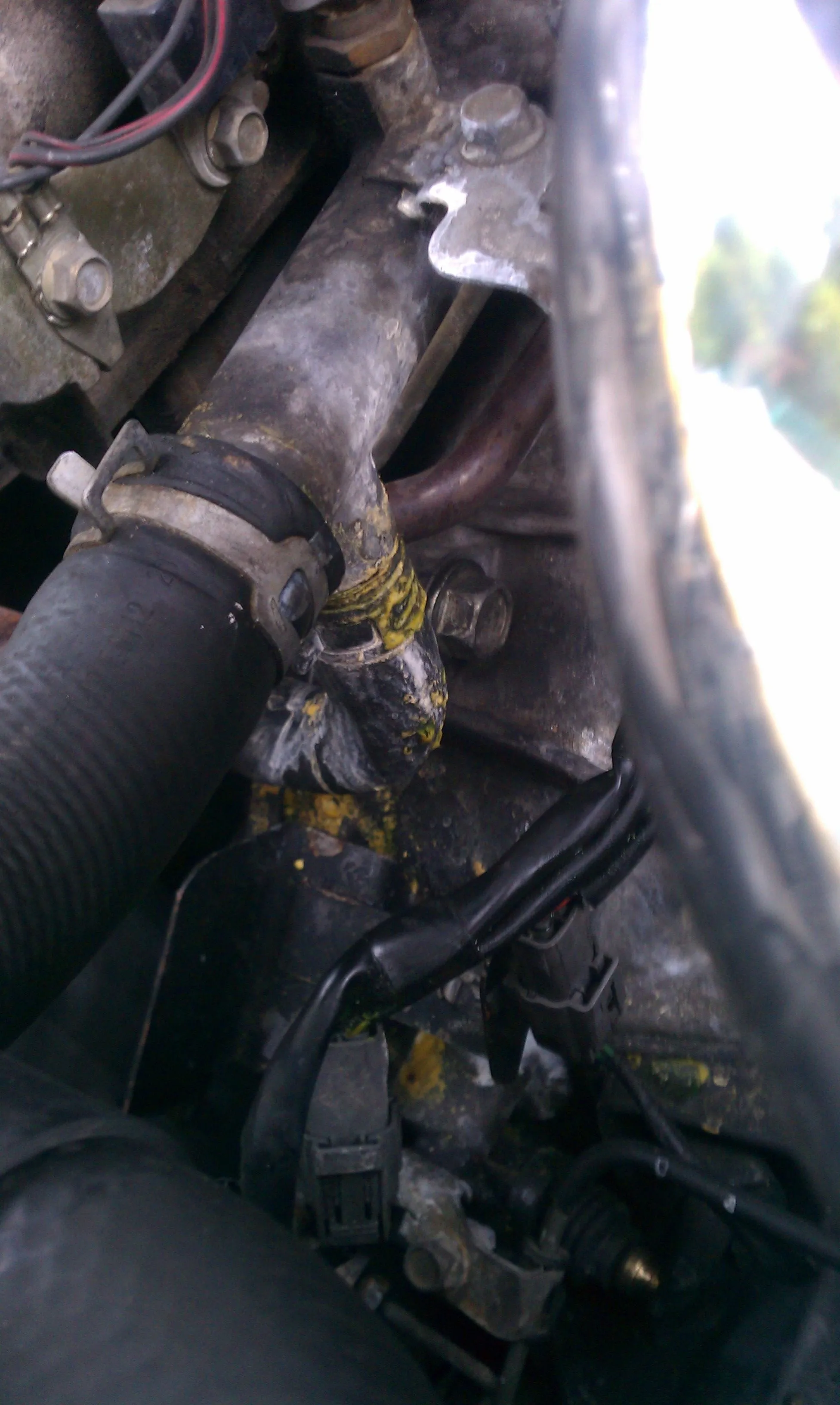

Hi, just recently noticed my upper radiator hose is leaking where the clamp holds it going to the motor. As well as the hose which connects to it going down.
I want to know if they just need to be changed? or does this mean there could be something obstructing them?
The temperature gauge is working fine and the car is not over heating but i'm afraid the hoses will snap off. The coolant is leaking onto 2 wire connectors which could cause a short circuit. I'm also having idle problems ( on another thread) but don't think these are related. I'll post a picture soon.

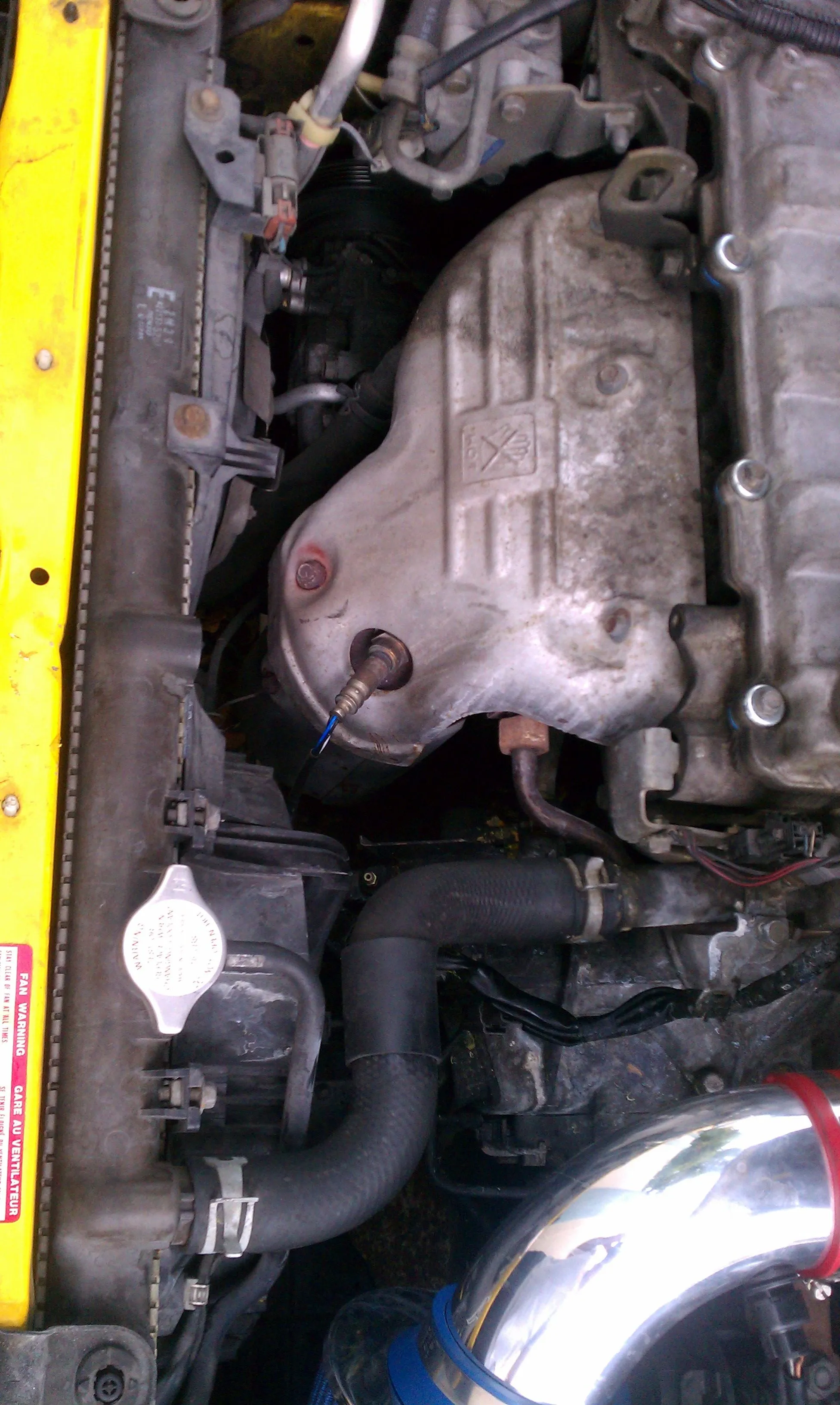

ok just had time to look into it. The hose leaking is the upper radiator hose and another smaller one which connects the upper radiator hose to the water pump I believe. Just could not find in the service manual the name for that hose any idea what it is?
I would say its about 3/8" or 1/2"

the upper hose is "Water Hose" - FP47-15-186C - $15.37
the other hose is "Water By-Pass Hose" - FS01-15-288A - $3.81
prices are from OnlineMazdaParts.com
