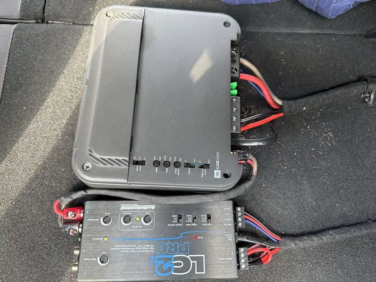

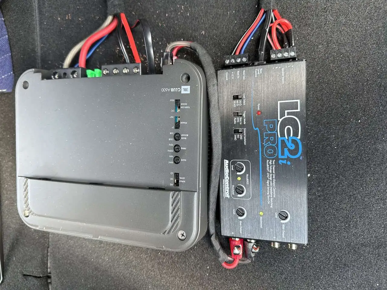

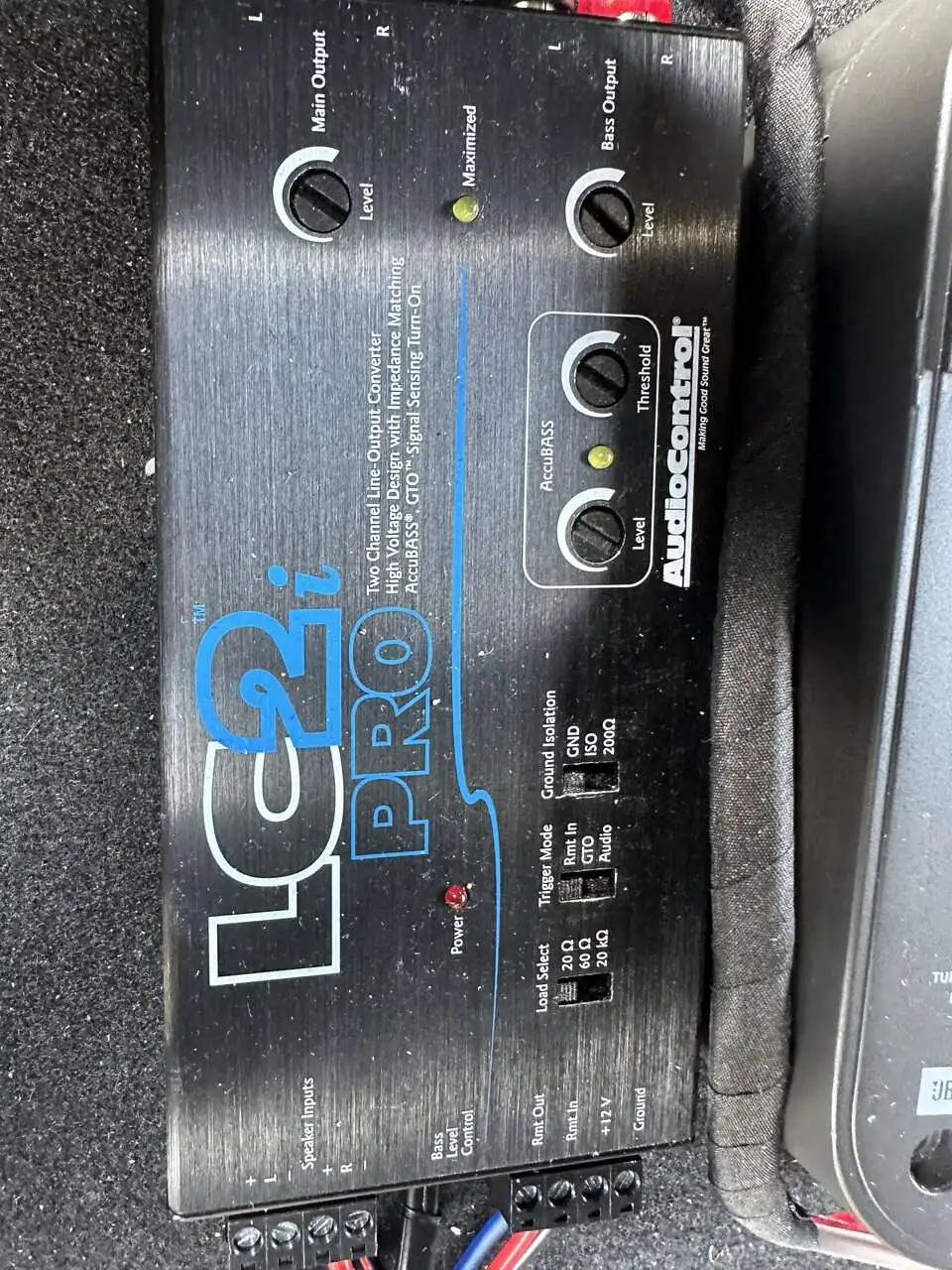

I will get some pictures of the loc and JBL amp settings per the shop that fixed the issue as well the fine adjustments nubs that came with the amp and LOC.
“Theblooms” the JBL amp does not a built in LOC. as mentioned above pictures to show settings. I’m going for surgery and will have the pictures by Friday.

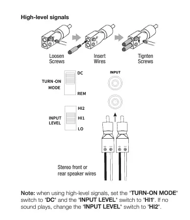

Well, firstly, good luck with the surgery. I hope it's minor.
But yes the JBL Club A600 does indeed have a built-in LOC. Even clearly mentions it in the Owner's Manual. This is a screenshot of the page in the manual that describes how to use it.

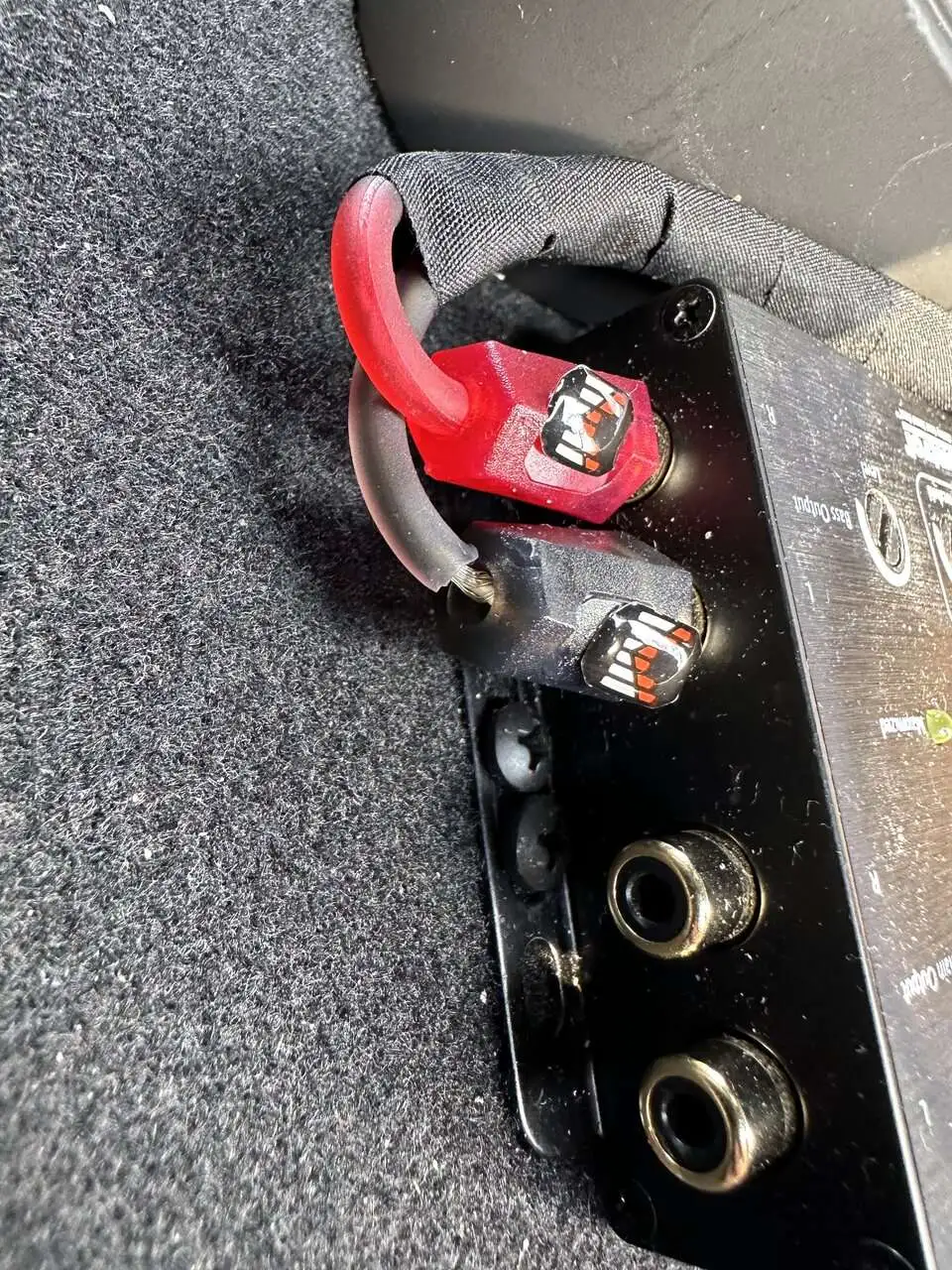

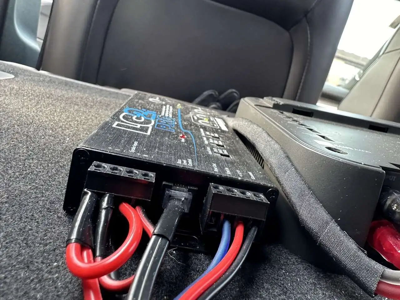

The LOC has bare wire in and RCA out.
The JBL amp only has RCA in and regular/bare wire out.
They threw away the boxes and manuals after they installed the system. Thankfully, the system sounds pretty good the way they currently set it up. Having the ability to adjust the knobs for the amp and the LLC helps me to tweak the music so it’s not overly base or not enough base.
*Mounted under the dash in the cabin (forgot to take pictures).

Oh Lord, that's a pretty hack job for a "professional".
Guess what? They're still using the high level inputs on the amp! And I have absolutely no clue why.
The fact they have bare wires showing, and didn't even bother to use RCA cables is just so, so wrong.
