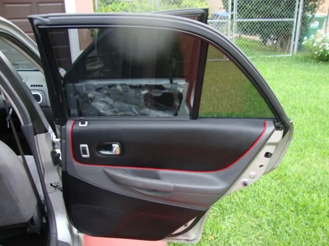

i had the idea of changing the fabric on the doors since i bought this car,the previous owner used to smoke and the car had few burn spots.
I was thinking of the black vinyls with red trim,then ,one day browsing the forum i saw this thread of "show us your interior" and i saw an awesome protege with the idea i had in my head,so i did it.

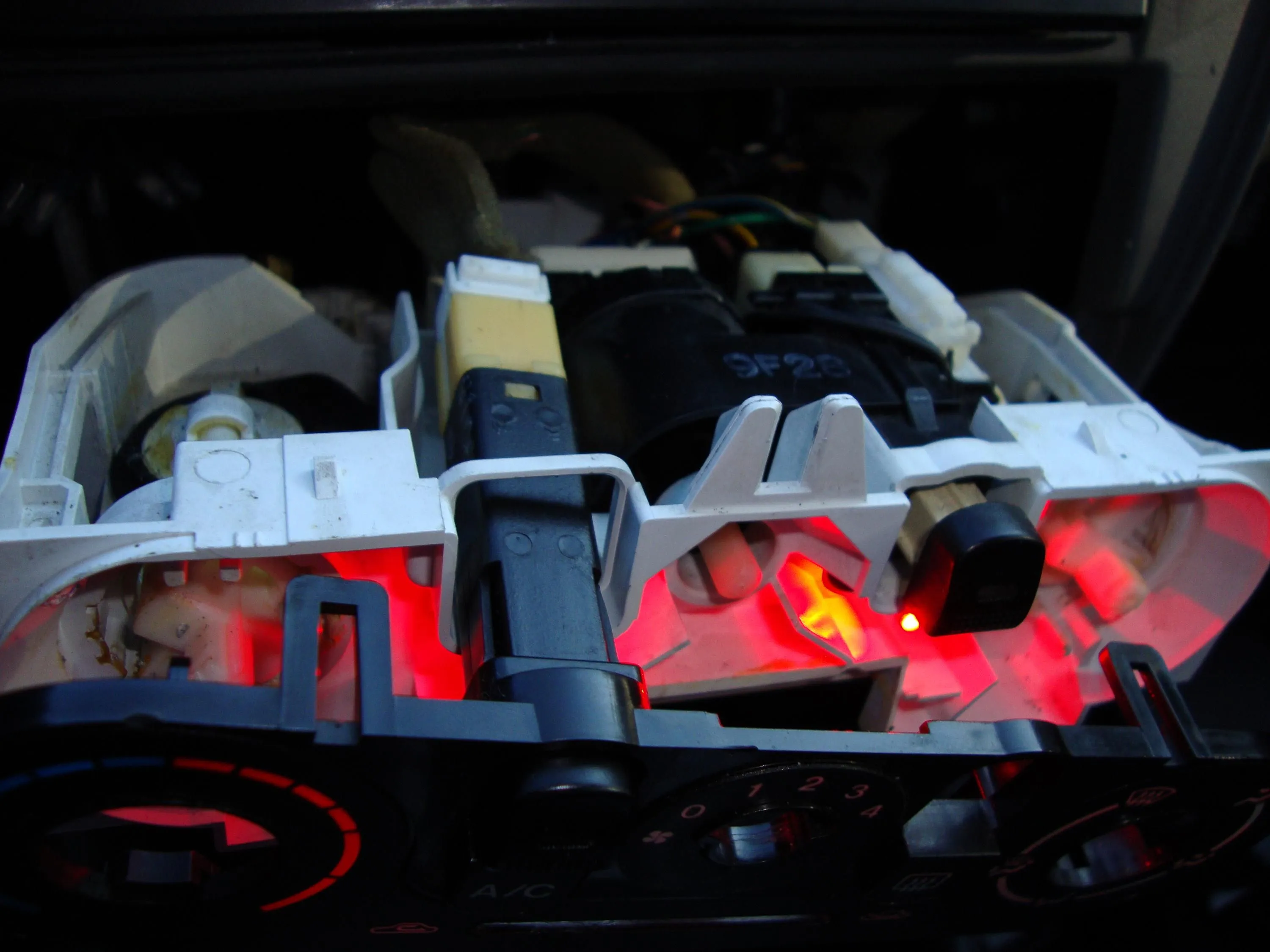

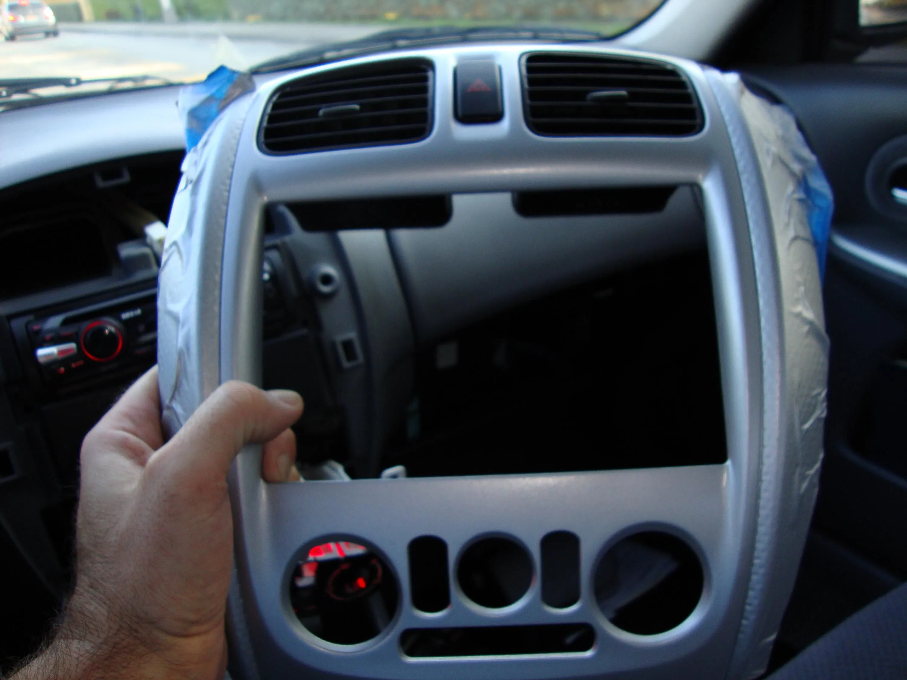

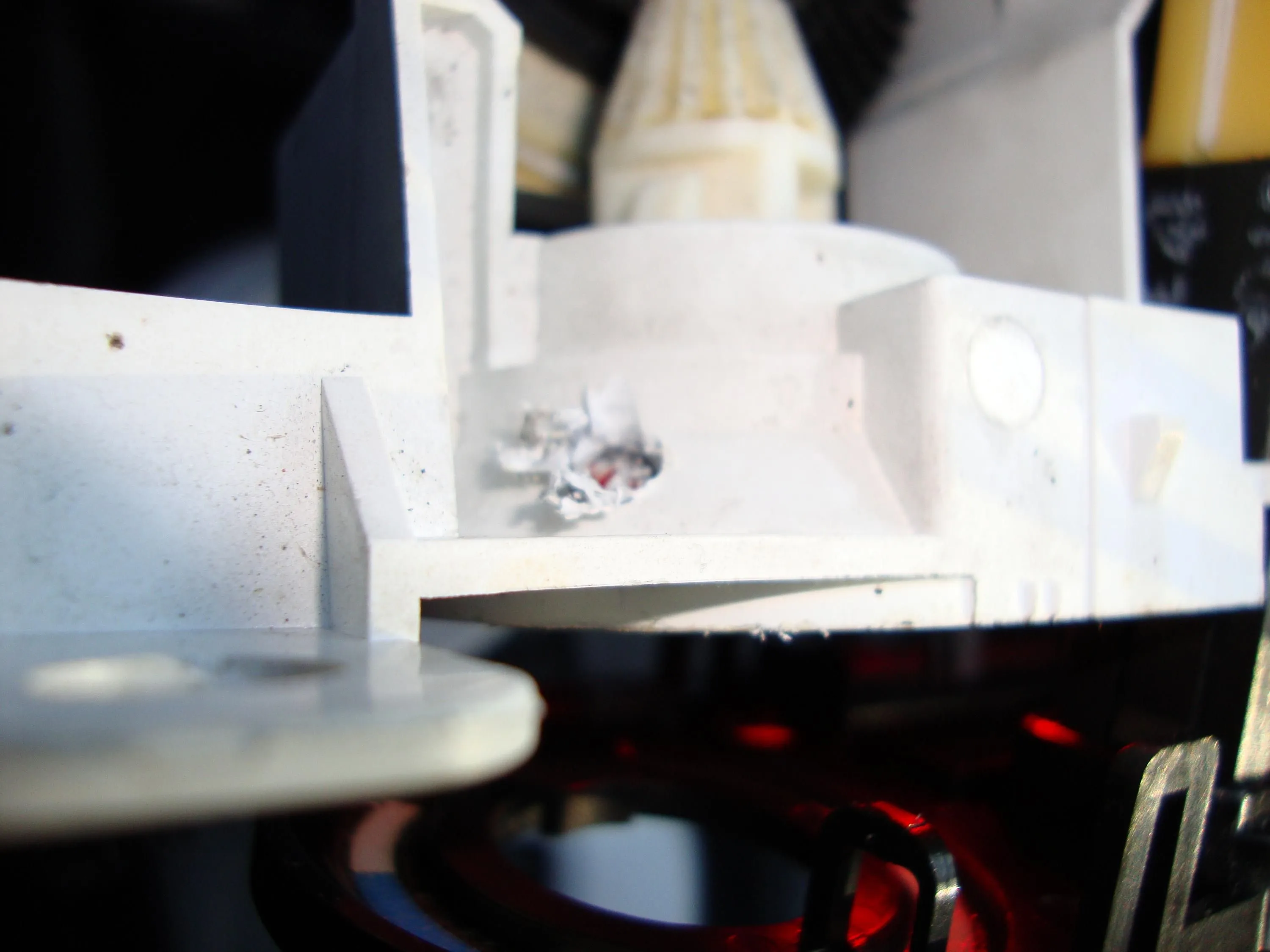

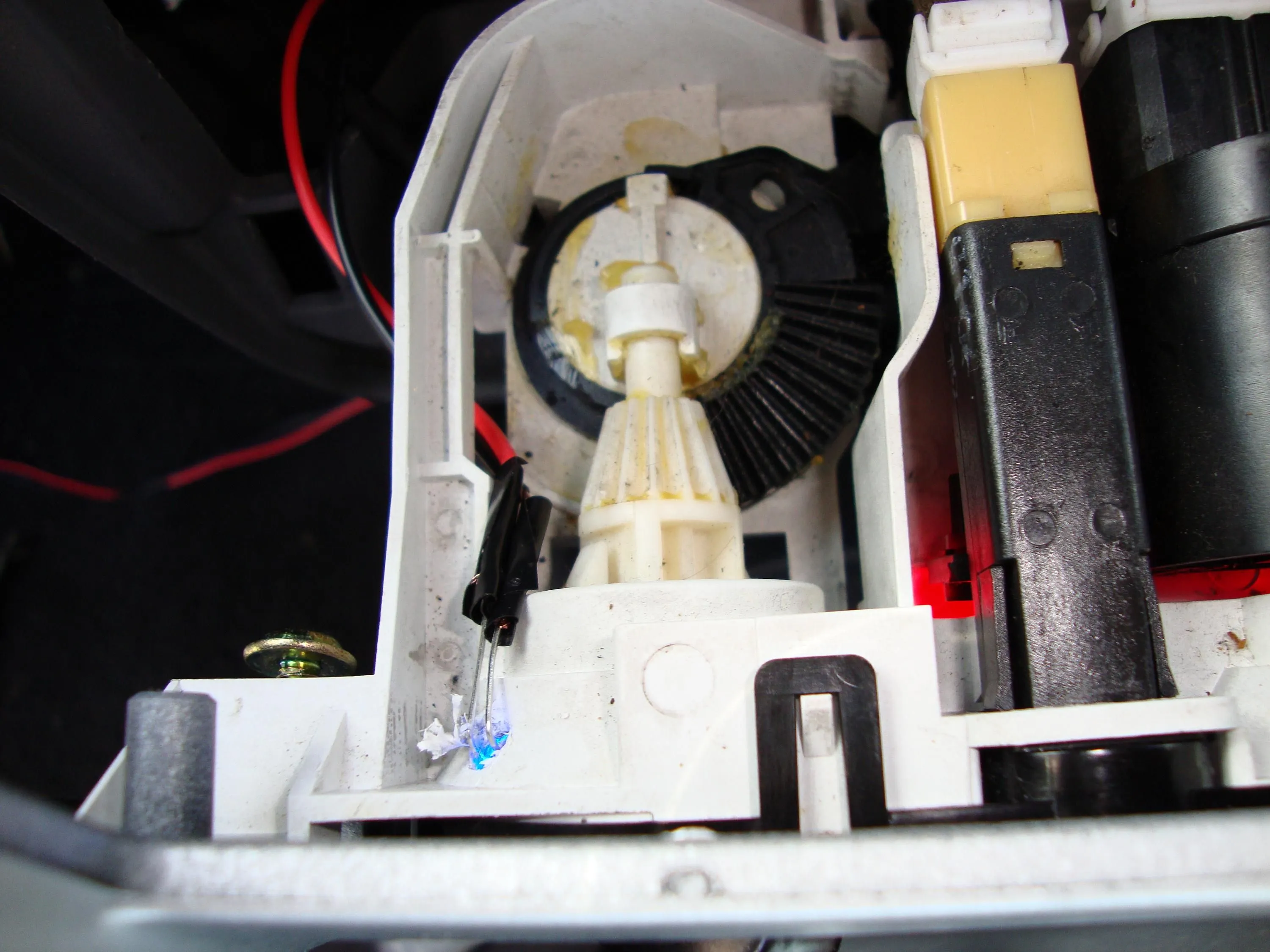

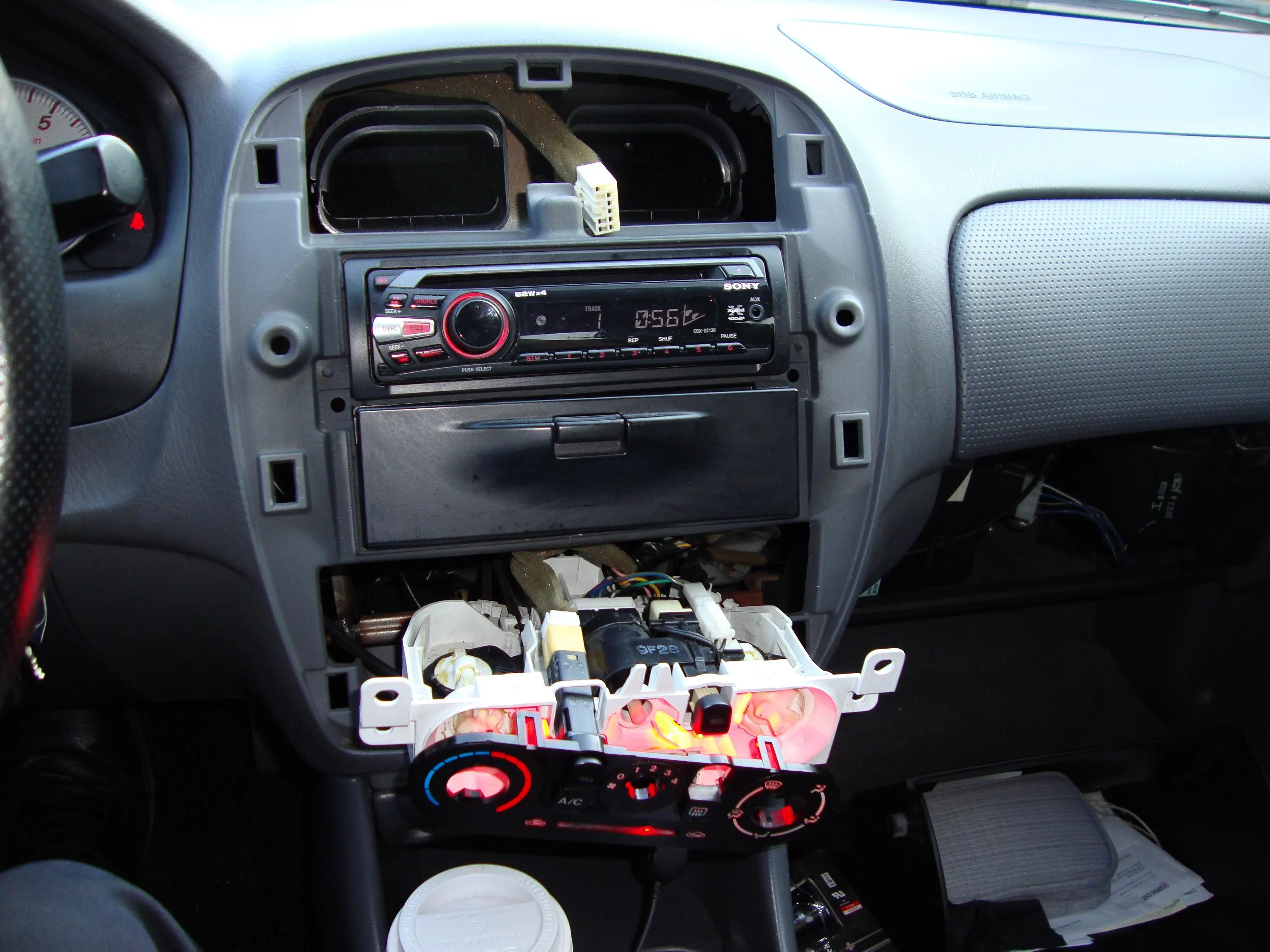

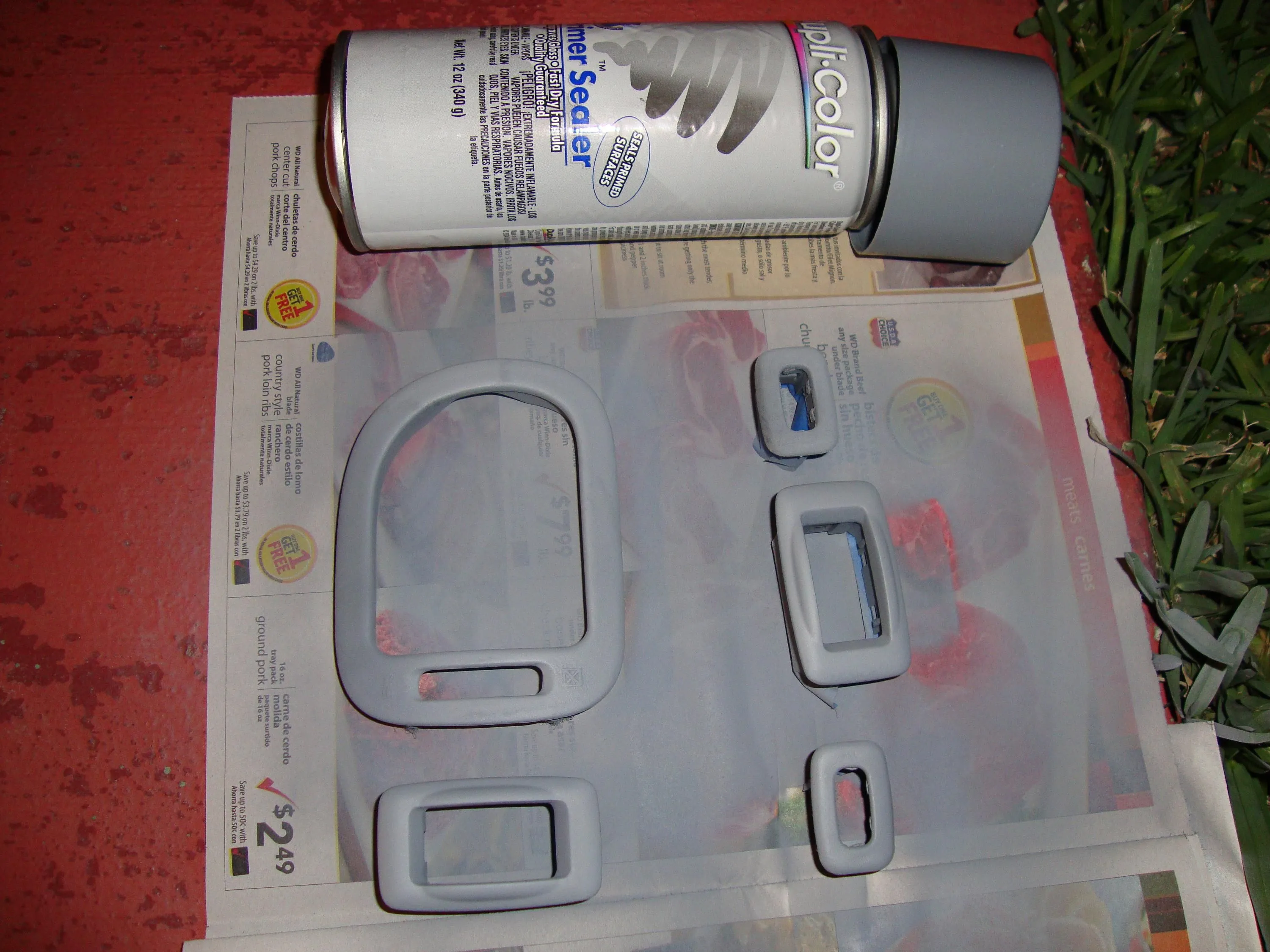

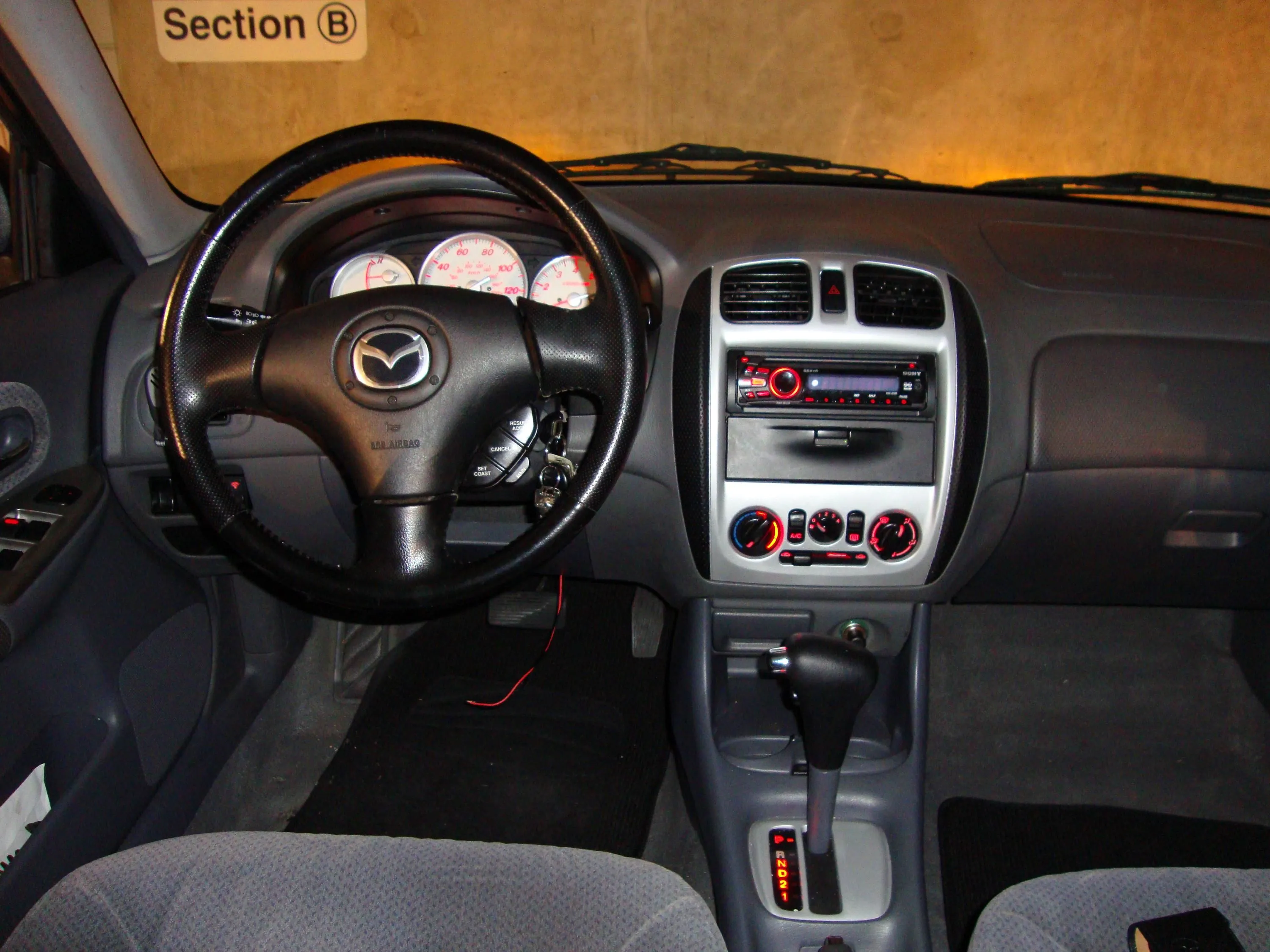

painted center console?hvac bezel in silver,changed the Hvac bilbs to red LEDs,drilled a hole on the side of the a/c unit(where the blue side is and added a blue LED.
changed the drive plate color to red by getting rid of the green tint with acetone,put a plastic red translucent tab on it and changed the bulb to a super red LED.
Got a black shifter form a local junkyard and replaced mine that was grey.

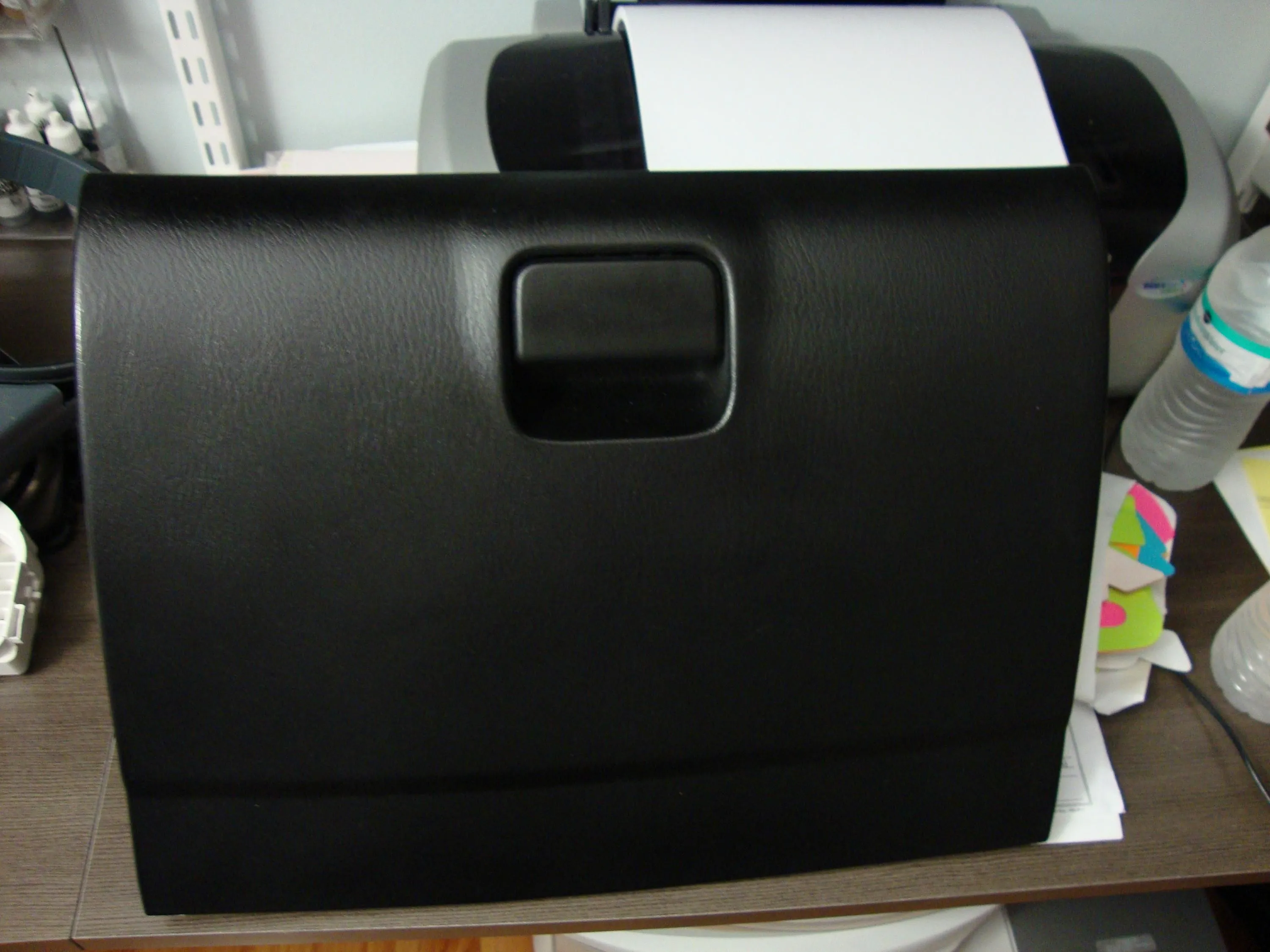

painted glove box in black.

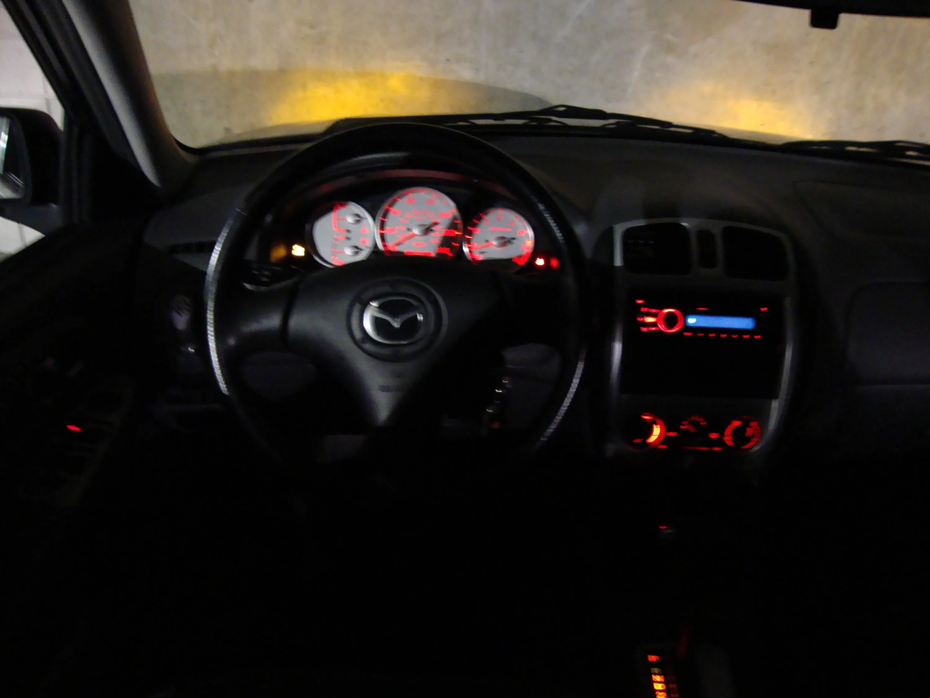

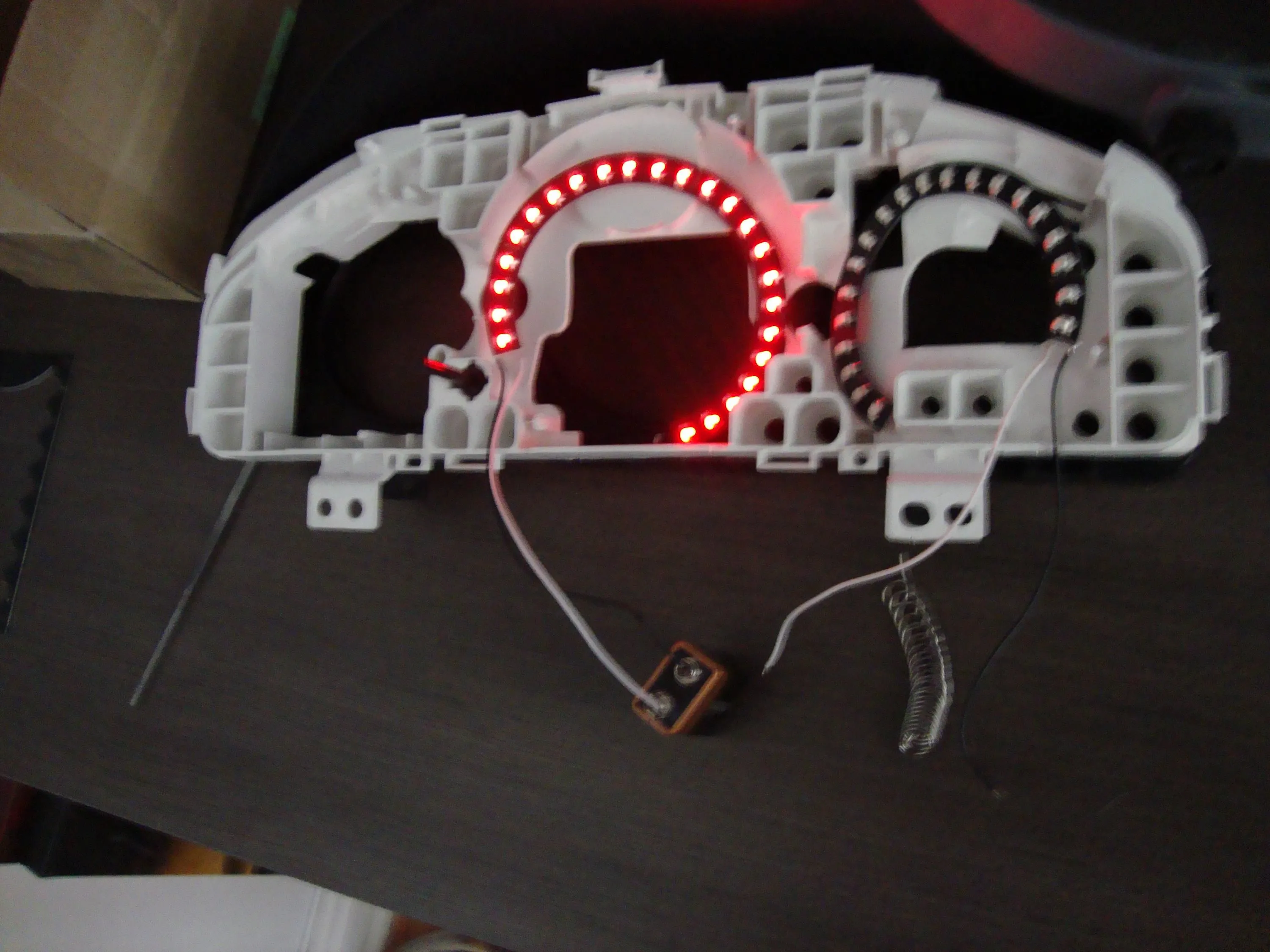

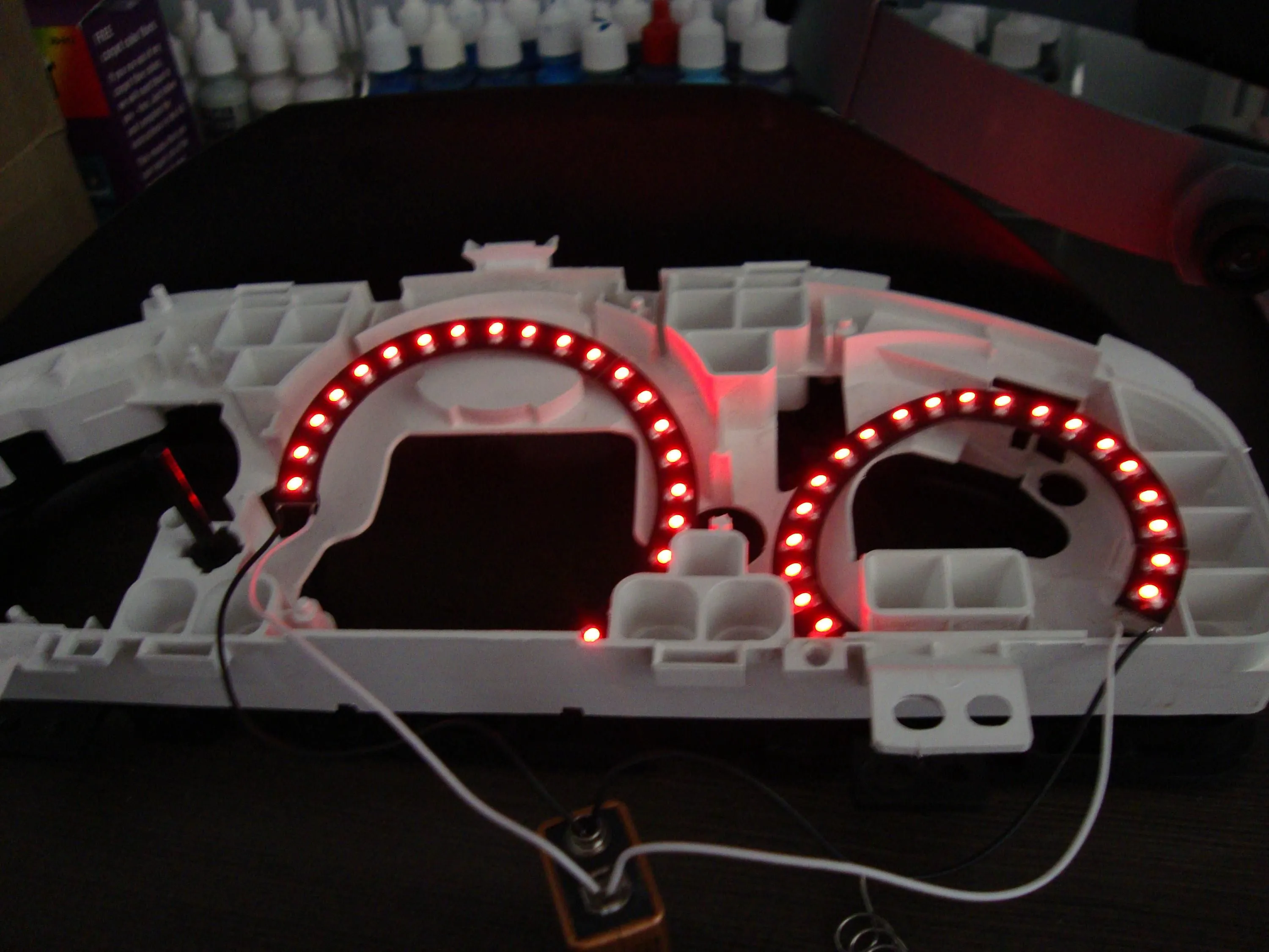

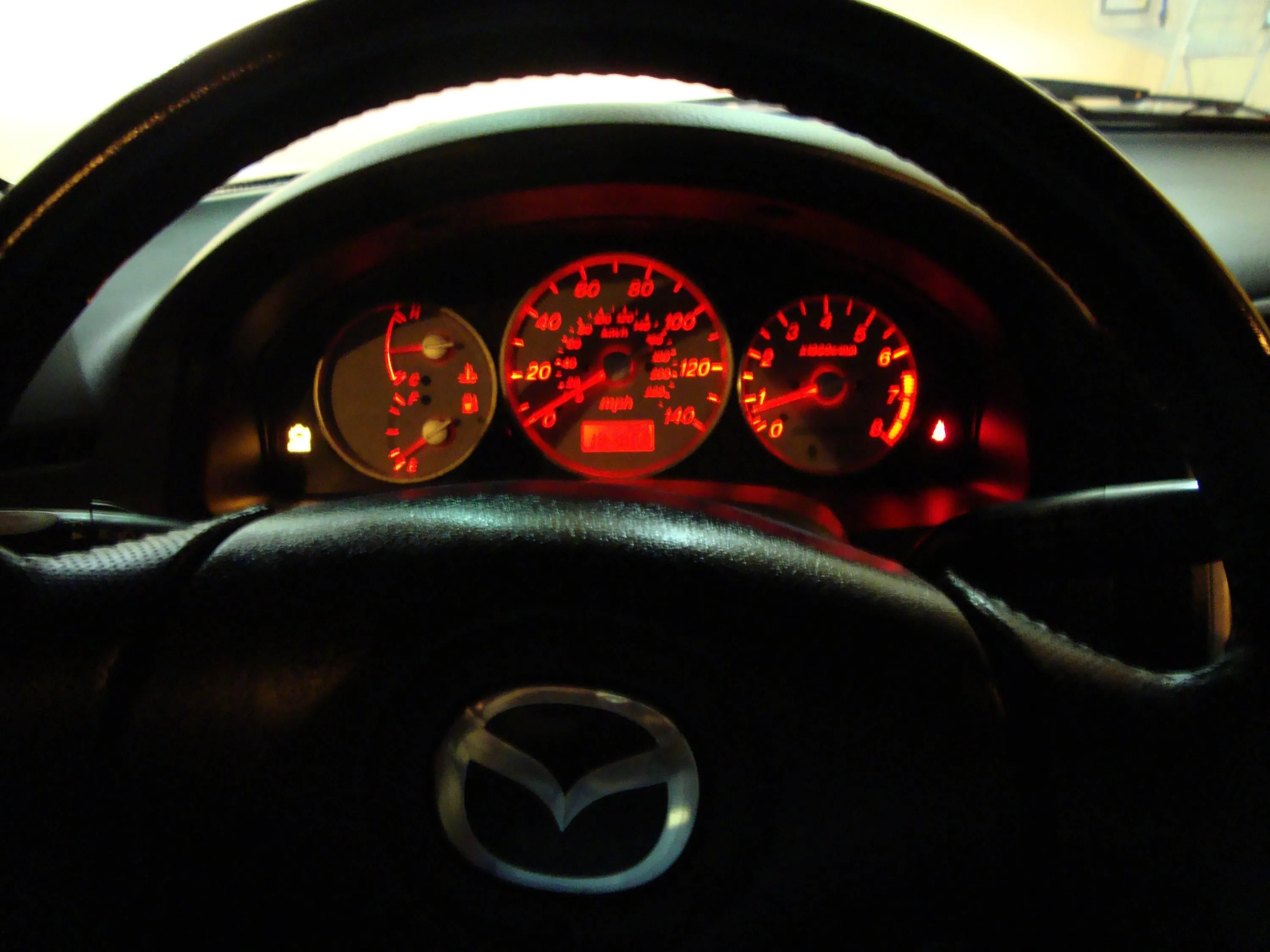

Bought a mazdaspeed protege gauge cluster and added all red LEDs.

Pics of the interior.
Forgot to mention that i replaced the steering wheel and airbag unit for a 2001-03.

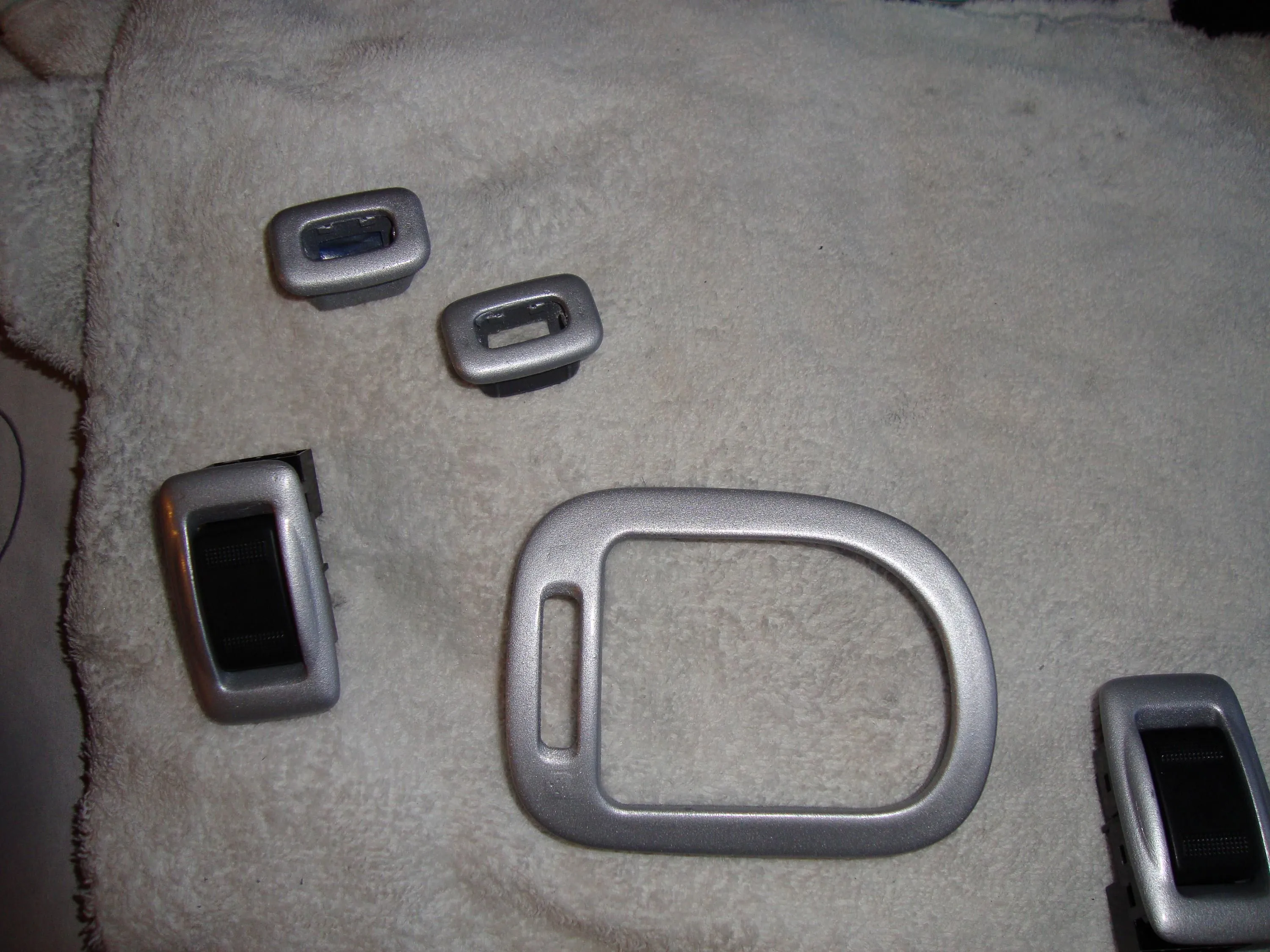

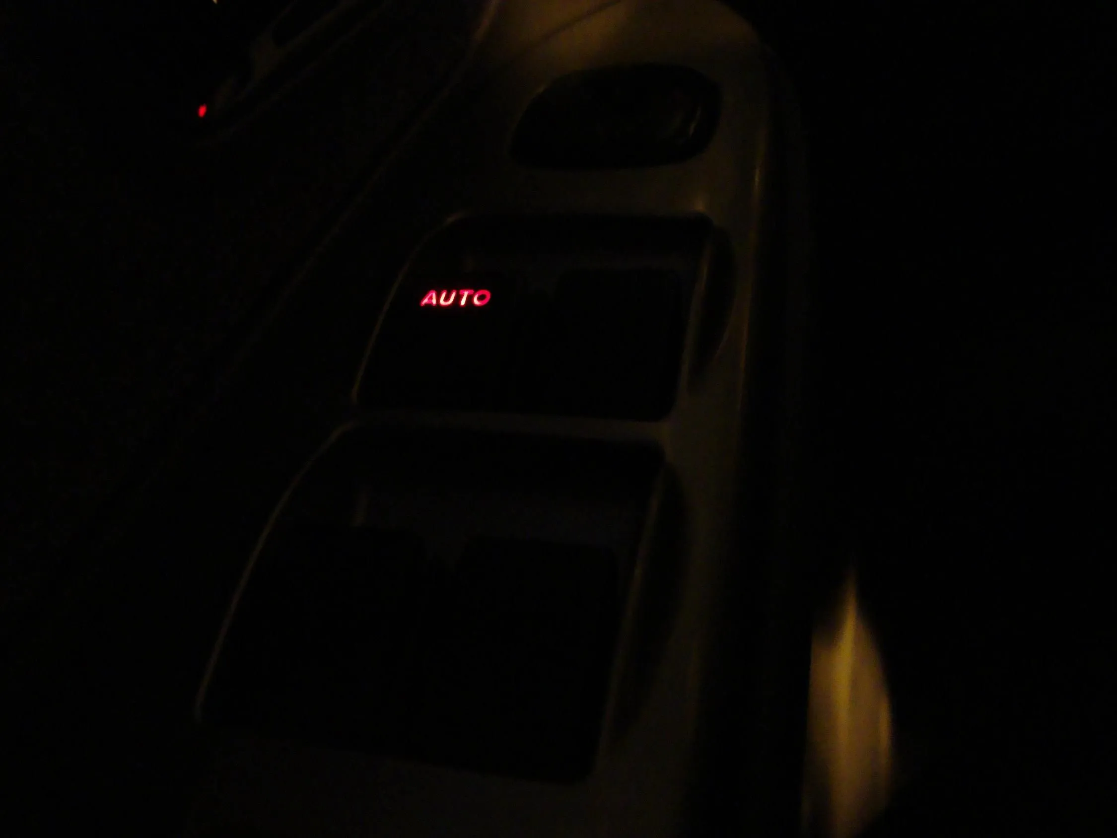

I used the zipwizard thread on this forum to learn how to change the LED light on the power widow swith,now is super red,love it!
oh btw do you have dave b rings on your instrument cluster?? i like the way the needles have the silver in them !!!

that looks awesome i was planning on doing the same thing to my bezel, what kind of paint did you use ??? is it the same one that u used on the sideskirts ??? T178???
That's right,is the T178 duplicolor.
I am re-doing the window switches since the color on them is slightly different than the bezel.
I will try a different primer,maybe the adhesive promoter only and see how it goes.

Just keep in mind that this link is for those who have 2001-03 HVAC units,i end up buying a console bezel and HVAC,did the whole LED change just to find out the wiring harness was completely different from the 2000 to the 2001-03.
So ,i end up selling that back and kept mine(2000 bezel and HVAC)

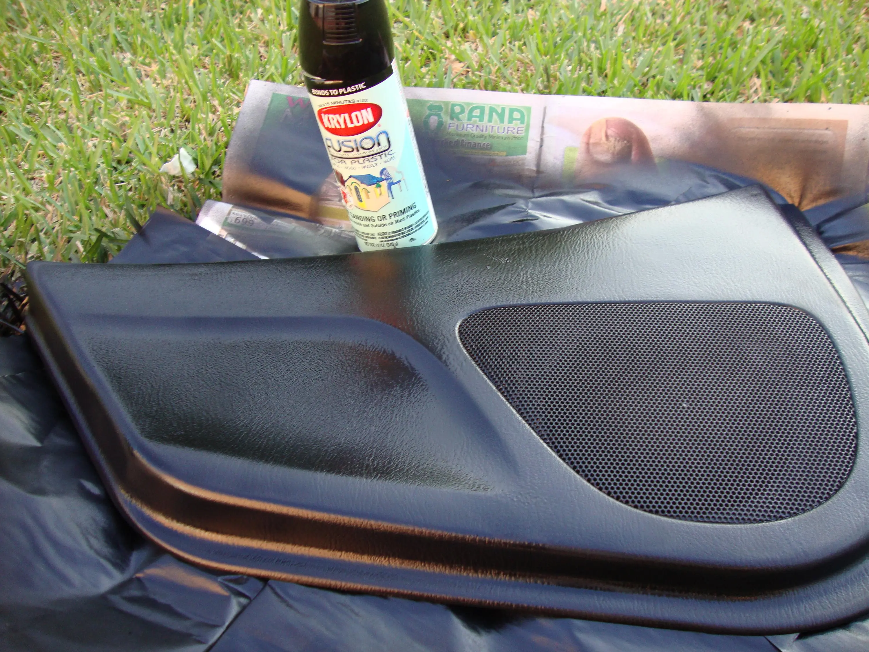

Painted my golve box,door panels(plastic part only) with Krylon fusion,satin black.
