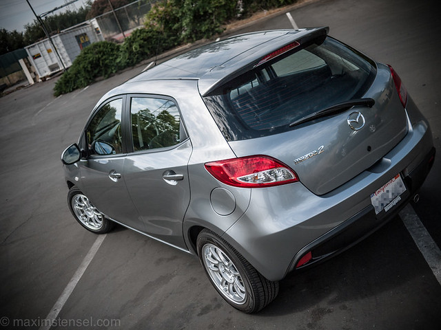

I just got the C1Ms put on my 2 the other day. I threw the stock tires on for now, they fit pretty much like kwaits92 said. They could almost use a bit of a spacer on the rear to even them out. But a guy could always get 30's for the front and 25's for the back if you aren't worried about tire rotations.

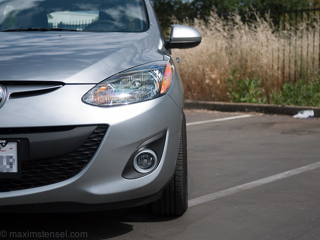

They stick out just a hair with the stock suspension. I figure once I put some H&R's in they should be just flush.

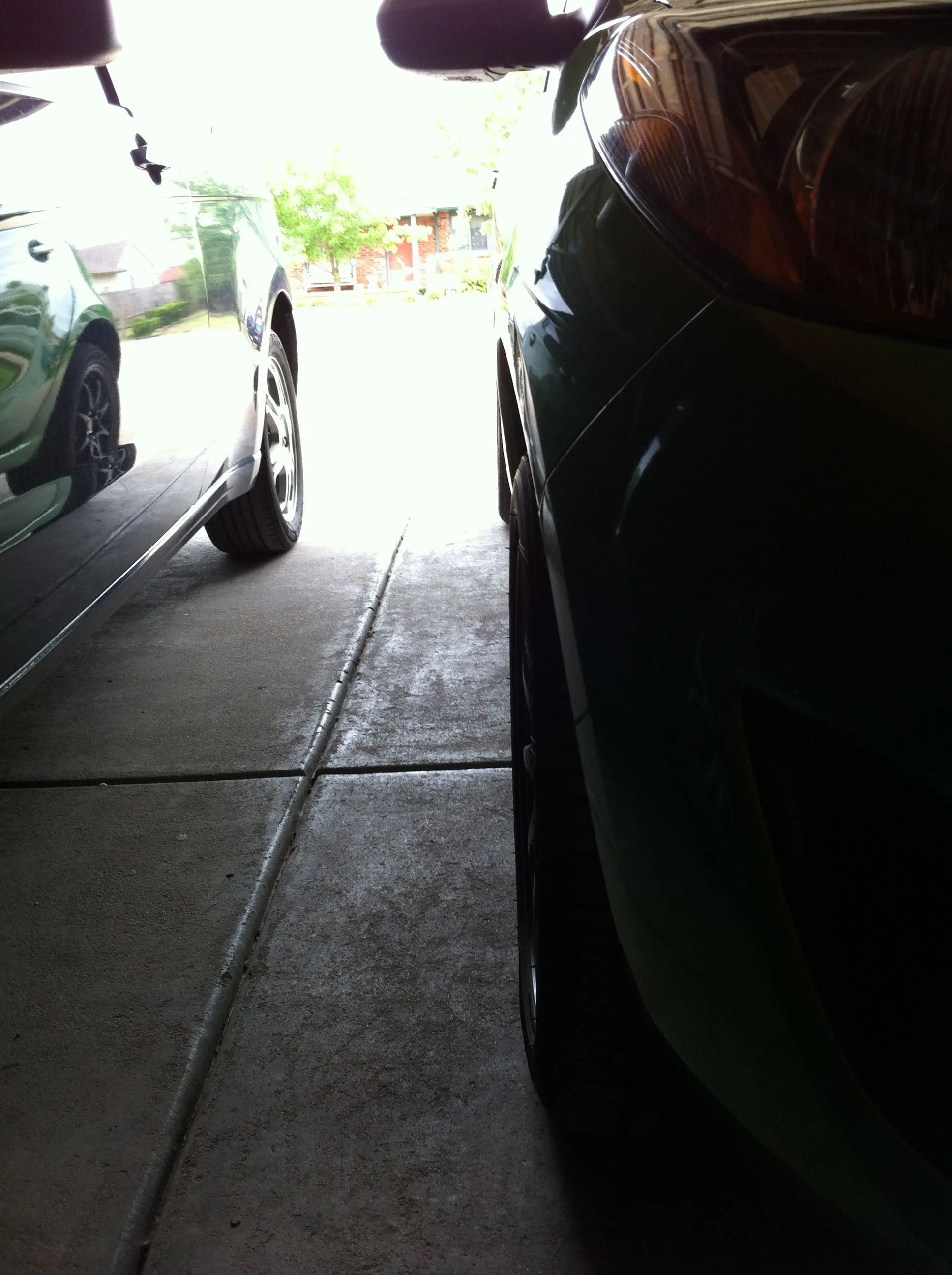

Syco, did you get the +30, +20 or +42 C1Ms? Any pics yet?
I went with the 30mm offset all around. I kinda wish I had gone 20mm in the rear though, just even out the stance.
Those actually look really good, makes me feel better about getting the normal C1s. Maybe I'll just go with them after all, then. What suspension are you on?
By the way, did you swap the stock TPMS into the wheels?
Still on stock suspension. I'll try to take some side pics today, I think the combo of shadows in the wheel wells and a black car made it look lower in that pic.

Wow, they look pretty good on stock suspension. I think seeing that is basically enough for me to be OK with the normal C1s. I don't need my car to be "stanced" or anything.
