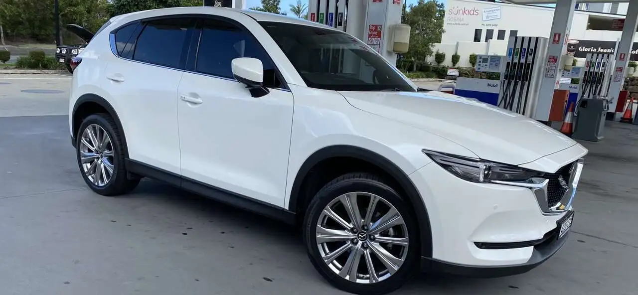

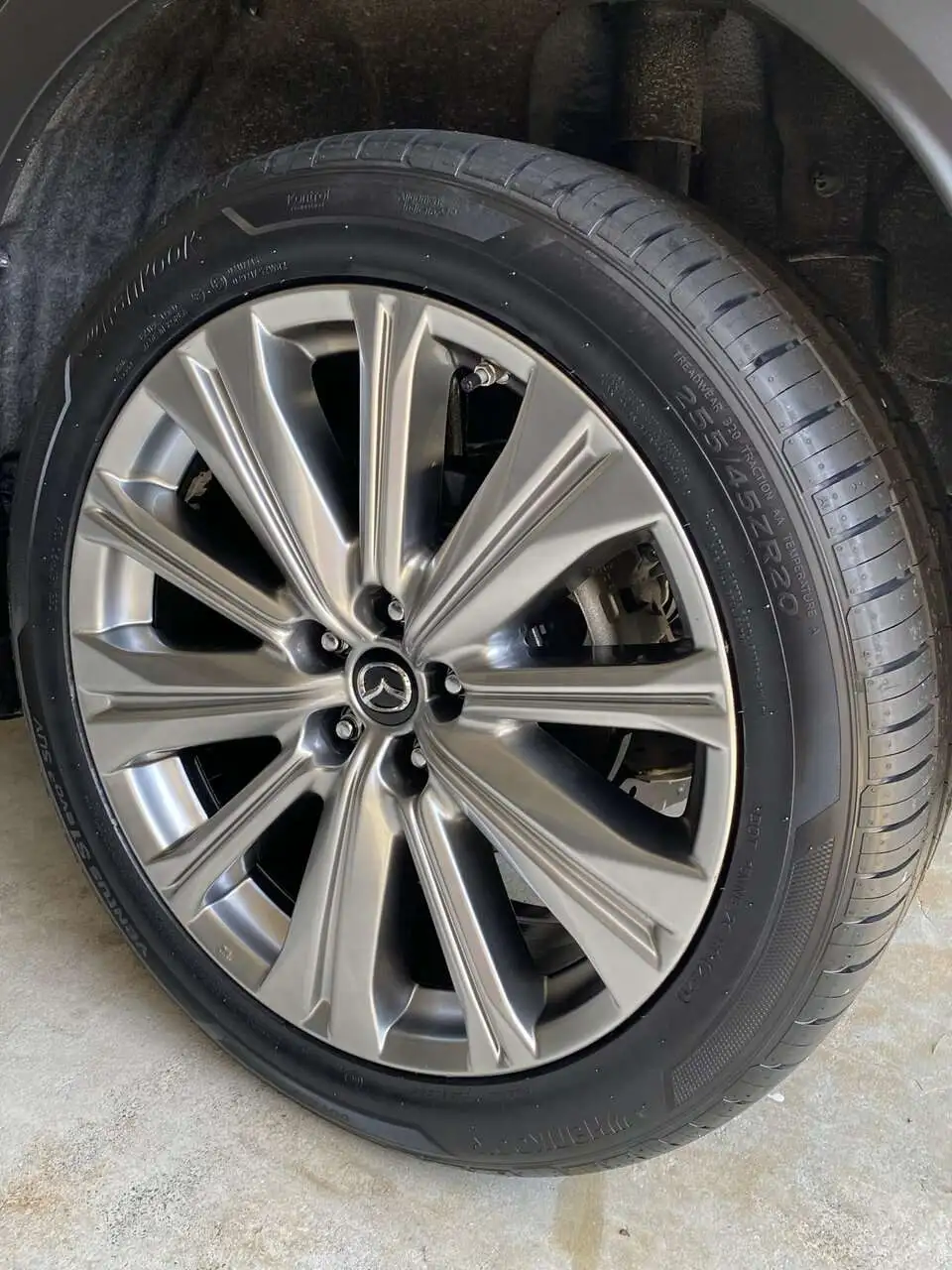

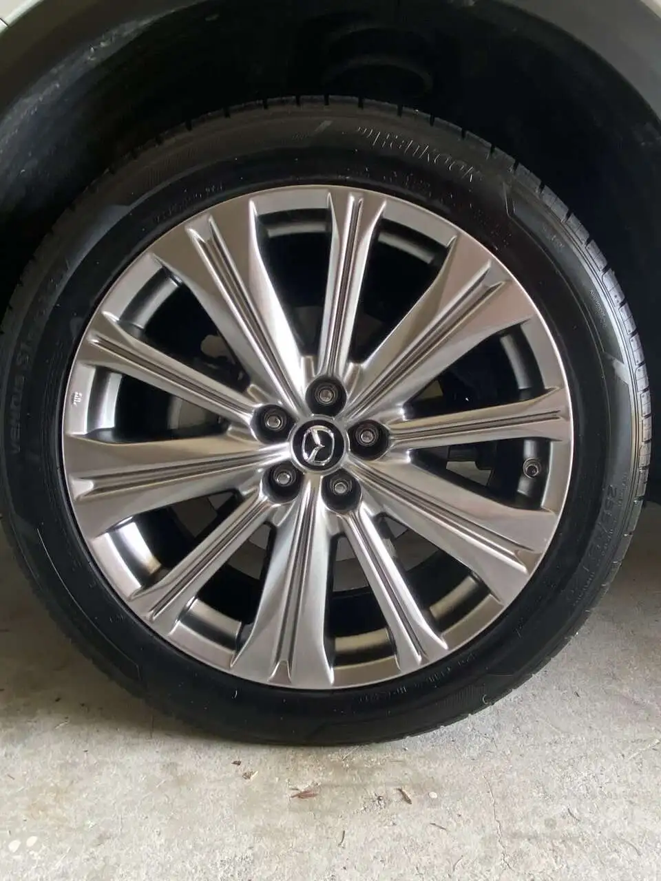

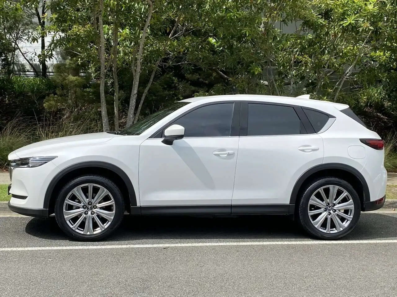

I’m rolling with CX-9 20”x8.5” rims on my 21 Akera with 255/45/20 tyres I think the offset is 45 and have no issues whatsoever.

Also, did you just simply replace the wheels or you had to use spacers or something? I'm about to get the same as yours also from tire rack. Been loyal customer for 4 years now. Best place for tires.

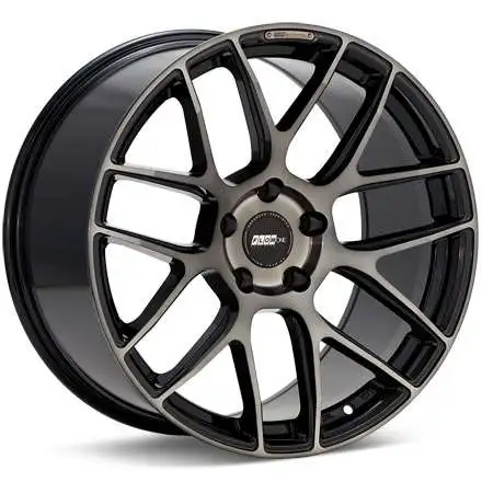

The color on the car looks gloss black, but the wheels photo you shared is machined. Can't tell for sure which ones are on it. Gloss black looks better on white than machined , but only comes in 18 and 20in

I can't tell in the picture of your car whether it's Machined Black or Painted Black. 19s come only in machined , so i don't know how it would look in person
So, which ones you have?
