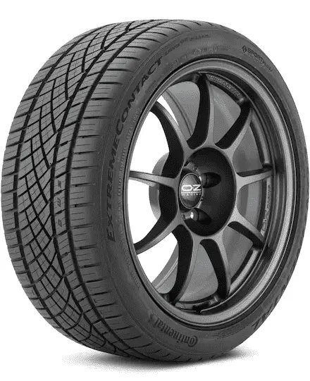

The tire I've settled on (and this was hotly contested between it and the Goodyear Eagle Exhilarate) is the Continental Extreme Contact DSW06 in size 245/45R20
It's almost identical (2 revs per mile difference) to stock, just 10mm wider each way (.39") given the same offset.

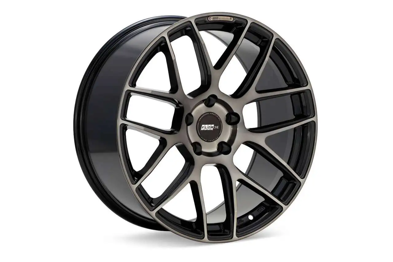

The OZ wheel was just the one on for the tire photo. The wheels I got are Flow One (flow forged wheel...why they are so lite weight).

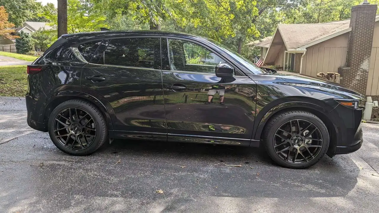

Here is a photo of the wheel and of my 2022 Turbo with them on.View attachment 312048View attachment 312049
Looks good for sure. Would like to hear your feedback in a couple weeks to see how the wheels are holding up especially if they see any kind of rough roads, railroad track ruts etc. You have me strongly looking at the Flow One wheels due to their light weight and lower price point when compared to Enkei and other well known name brands.
