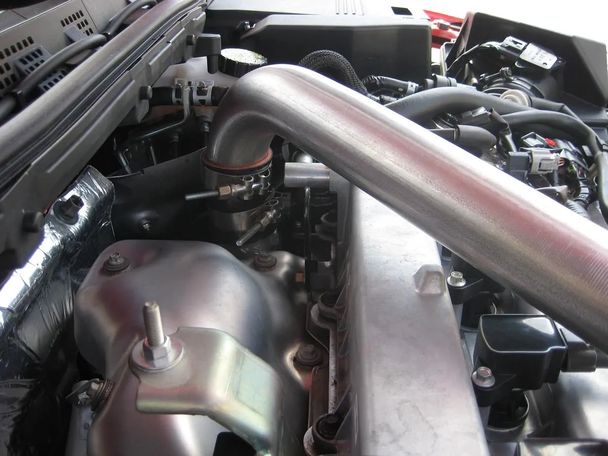

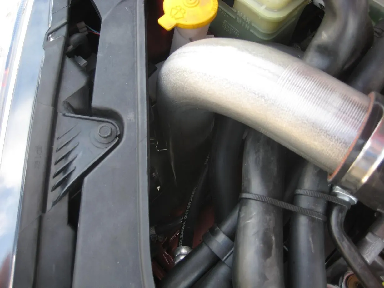

the cores came in today at exhaust depot....he has to test fit it again and then powerdercoat some pipes. hopefully get mine on next week...im stoked! Here's some pics he just posted showing manifold clearance issues and the hot side piping, just touches some rubber and shouldnt rub or have any negatives as far as i can tell...just a lot less piping!
