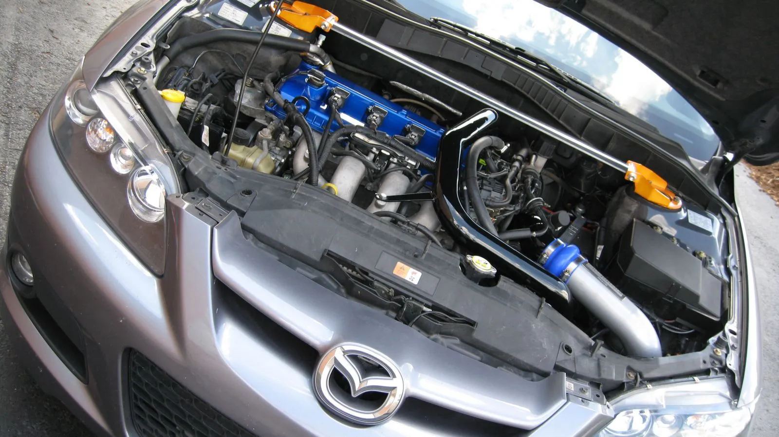

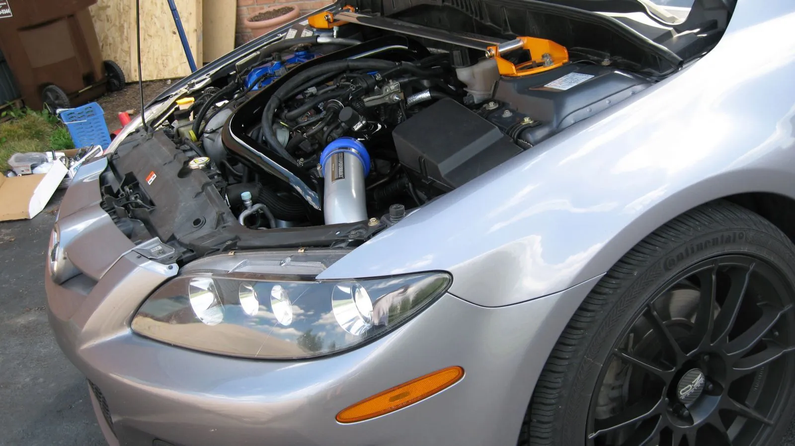

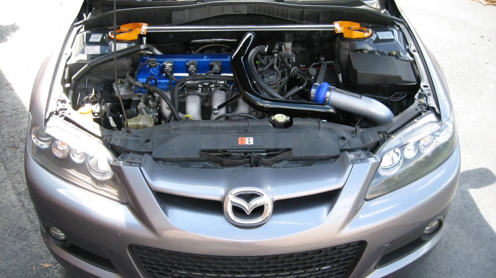

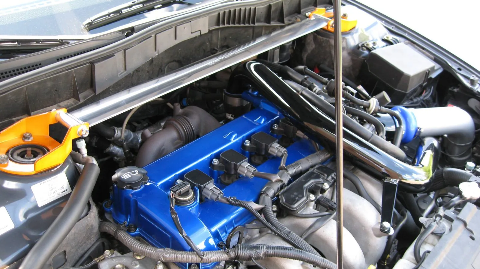

These are some pics I took today. The engine has 700 miles on it so far and I am now running castrol full synthetic. It's running strong and I have the cp-e ems plugged in using their base map. I have since purchased aem wideband digital gauge, aem digital tru boost, and aem digital oil temp gauge which will go in the center dash gauge pod that is made for this vehicle. At 10 psi this car rips. 22 psi is going to be scary. Dyno appointment is scheduled for saturday the 14th. I really didn't wanna get it done on friday the 13th. Anyways, i'll keep you guys posted.

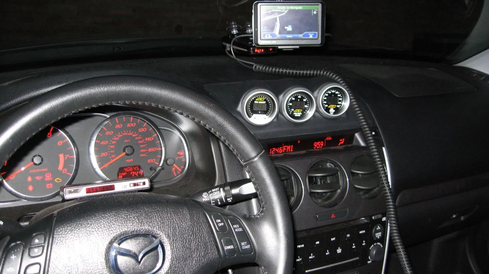

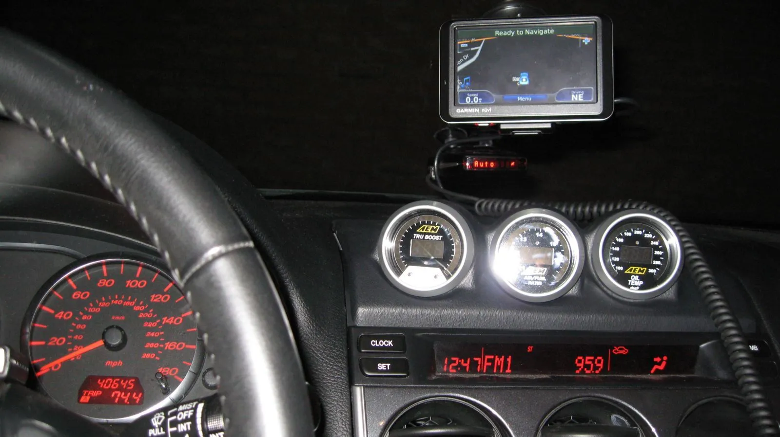

My dyno appointment is this saturday. Hopefully the boost clip feature in the standback will eliminate boost cut. I have a feeling that MAF isn't the only determining factor for this. If you guys have any helpful information regarding this, I would appreciate it. Other than that everything is running tip top. I installed my 3 gauges today: AEM tru boost, AEM air fuel, and AEM oil temp. Had to do quite a bit of custom work to the pod, but being very particular yielded a very good result.

Sky I was looking at your engine bay and I notice that the battery is missing! Where did you put it! Are you runing the stock TIP?
