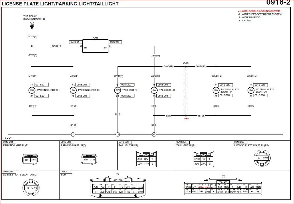

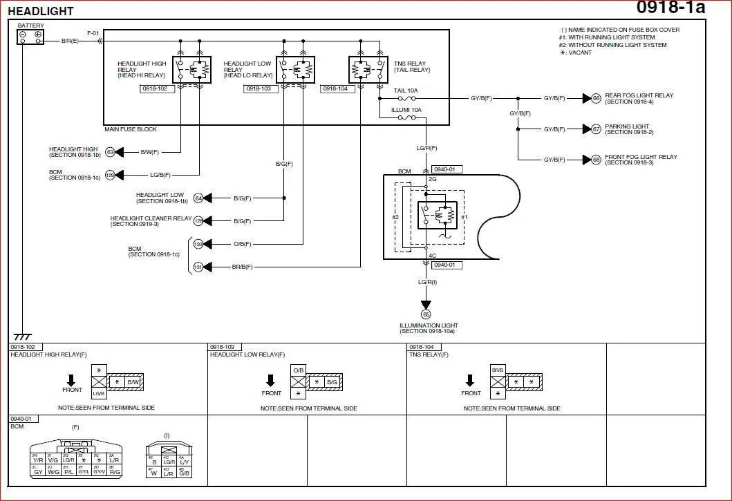

I took snapshots of the wiring diagram. should be
similar.
It appears, license plate lights, and tail lights are fed via the same fuse,
as well as rear-foglights (which we in N.A. don't have).
I use a radio or light connected to the fuse as I inspect the wiring.
When the light or radio turns off, then I have found the short.
Good luck!.
