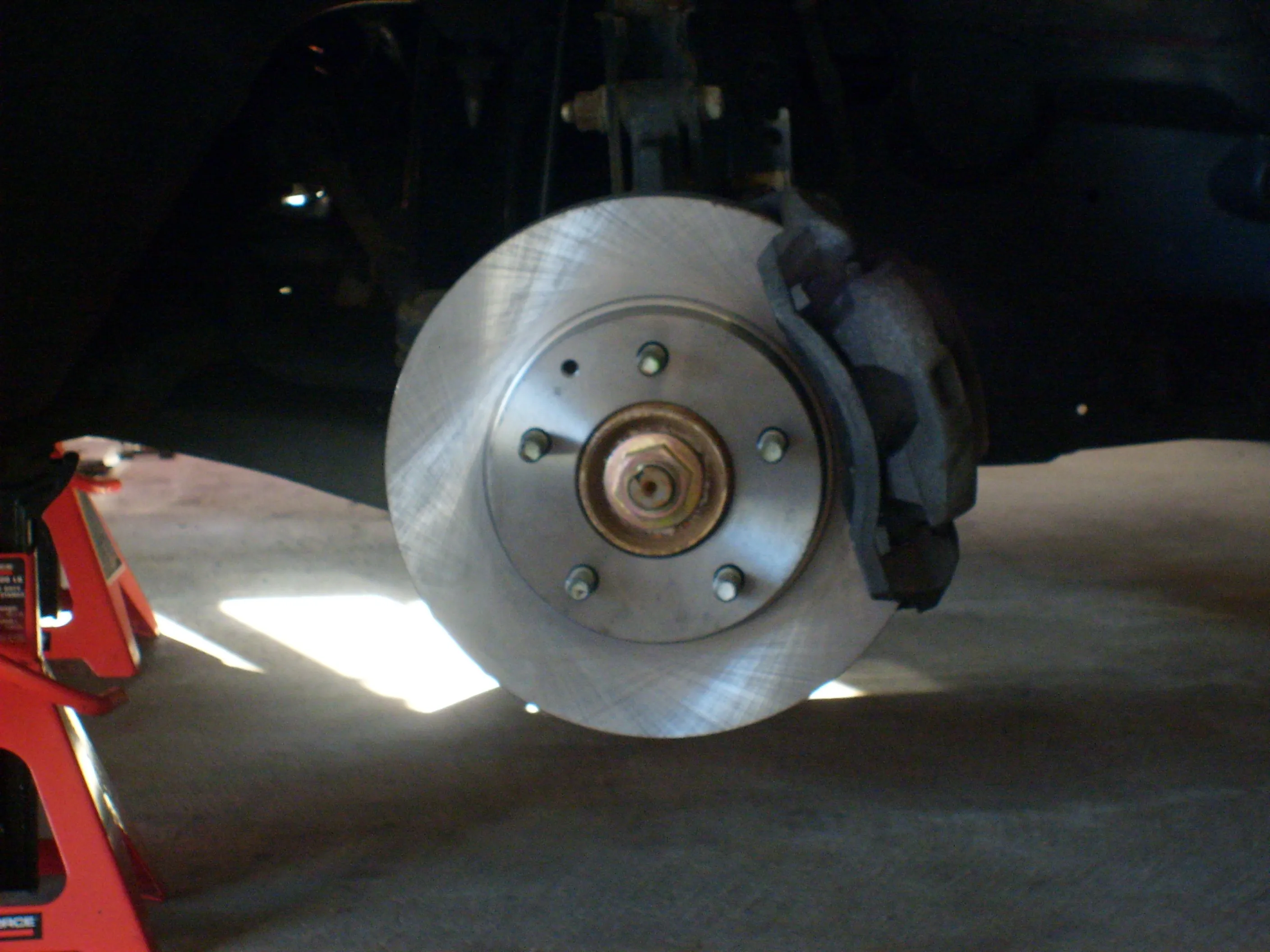

For daily driving stick with the regular rotors. No point in paying extra for the slotted/drilled. I installed the posi-quiets in the front and rear as well as the blank rotors from Tri-point on Saturday with a little help from Bruce (a223818) at the NEPOC Spring Cleaning Meet.
