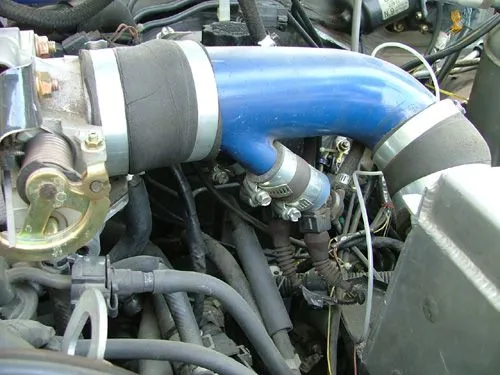

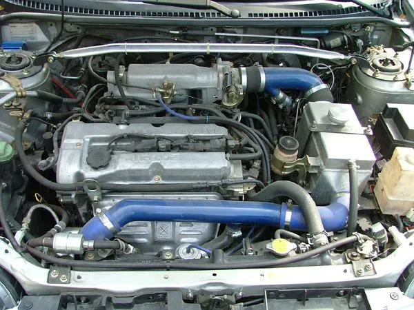

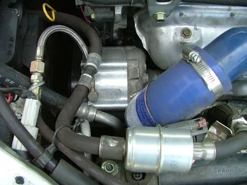

here are the pics of the custom superchared 1.6 zm-de. awesome

Supercharged?? where? that looks like custome pipes for air flowing with a metal airbox
Serpentine drive belt is over there on the left side of the picture. The supercharger gets its power from that. Air gets forced from left to right along that blue pipe in the front, into that metal box (intercooler maybe?), and then into the intake.
It seems like that would be dumb custom piping if there was no supercharger. If that car was NA, air would be traveling from a filter in a crowded location, 1.5 times the width of the car, and through what is probably a really noisy, bad sounding airbox.
Also, if you look in the second picture, you can see the blue pipe connecting to a metal device on the serpentine belt. Is it the AC compressor? Probably not.
I always though that the supercharger was that big block with a weird square shape.. but this car doesn't have that.. just a belt and a custom pipe
the supercharger is run by the belts and you can see it on the second picture. that box you see to the right is a water-to-air intercooler. and the piping is really good actually, it goes from the supercharger to the water/air intercooler and to the TB, no crazy bends or a lot of pipes going to the front of the car. throttle response must be insanely fast with that setup.

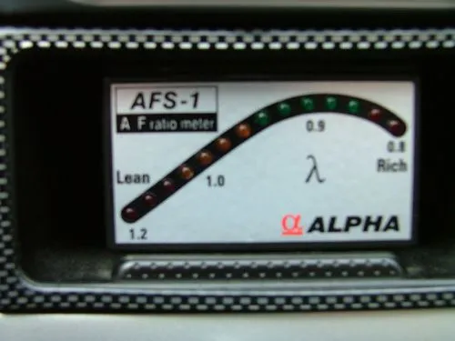

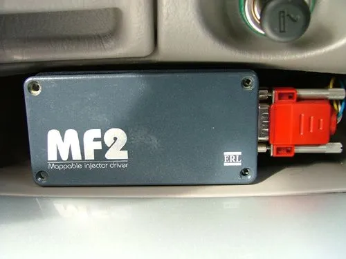

The guy sent about 3000. He got the different parts from the Uk. This is no supercharger kit for the 1.6 protege.
Well this is a custom thing. But they guy was using a rotex unit. He is also running two more injectors before the TB, to keep it rich and nice and cool, a signal conditioner (to bleed away boost from map sensor) and fuel management system. Got rid of power steering pump and put an electric one.
You have to source your own parts, do some fabrication and so forth..
