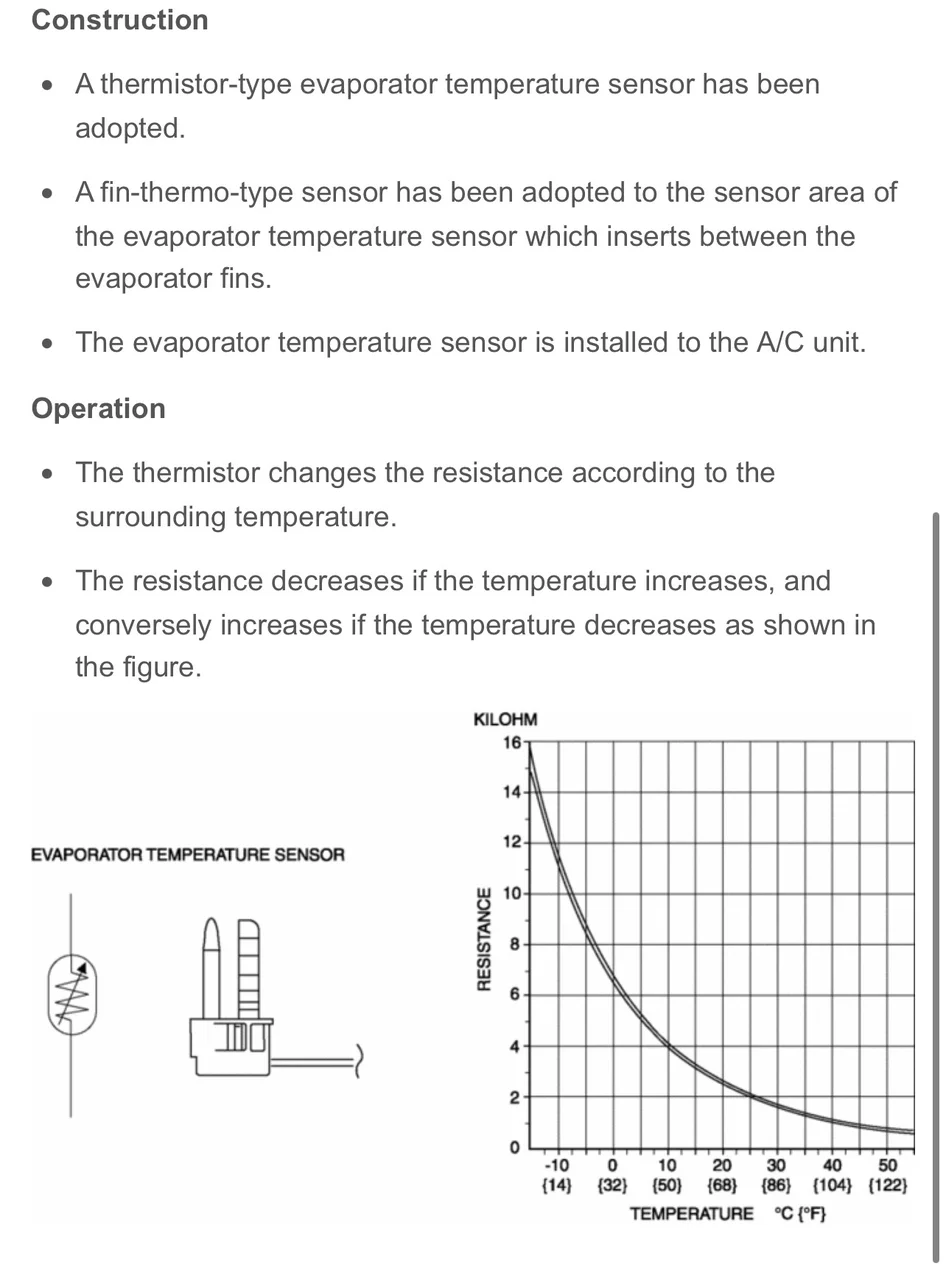

Update! I found an iPhone app that would work with the Bluetooth ODB adapter I have. Looked everything over and one thing clearly stood out. The Evaporator Temperature sensor is showing -19 degrees F! So the system must think my evap core is frozen solid. Now I just have to find where this sensor is on the HVAC box, and cross my fingers that it is accessible without removing the dash.
Thanks, I found it in the service manual and it looks like a complete quagmire, like dash-out, hvac box out cluster-eff. I did see a video online that might have shown the connector. I'm thinking I might just pull the connector and hang a replacement sensor in the cabin, or install a variable resistor in its place. Yes, it is cheating the system and might run the risk of freezing up my evap core. but there is NO way I'm pulling the dash on this for a sensor. I've done it on two other vehicles and it was NOT fun.
Good thinking. I like the idea of a variable resistor. Does Mazda service info have a graph of that sensor (possibly having temp vs resistance values) for enabling troubleshooting the sensor. That would allow obtaining a variable resistor of relevant resistance range and maybe give a good idea where to set it.
Not sure, haven't had a chance to dig into it that far yet. The sensor readout from the OBD was a temperature. But I assume the PCM is just interpreting a resistance value to calculate that. My first try though is just hooking up a replacement sensor outside the hvac box and letting it just read the cabin air temp. If that makes the computer energize the compressor I will prove my suspicion. Right now the computer thinks the evap core is -19 degrees!
