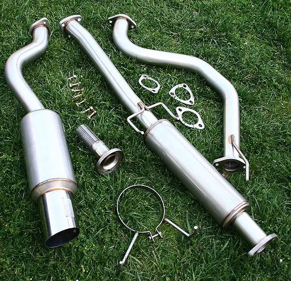

btw if we talk about aftermarket cat-back and not custom.. most of them don't fit on the 1.6.. just a few :(
I really like this one down here but hell wont fit on the 1.6 cuz of the bolt on thing for the header.. this one here is like a triangle.. the stock one has only two bolts
Its triangular cuz it supposed to bolt to the back of the cat that has a three bolt flange. Hence the name cat back. the only one i know were it bolt straight on to the header is the corksport exhaust system, that elimates the cat. On the 1.6 the stock cat is welded on the midpipe. just get a high flo cat off ebay and have the muffler guy install it with the exhuast. Those guys can make anything fit.
