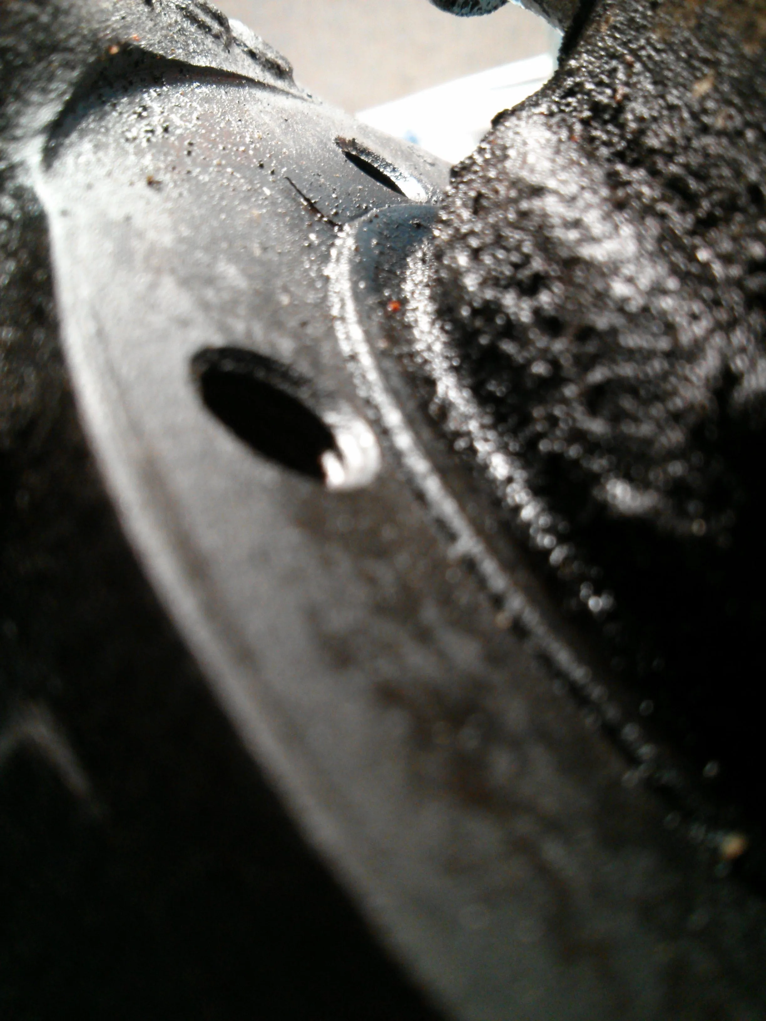

I may be picking up a turbo today and needed some advise beyond checking shaft play, cracks etc.
A picture shows that the core of the turbo which the shaft goes through looks like its completely black. I know that these area can get covered in soot, but how bad could it be?
Any suggestions?

a little shaft play is normal, especially on a bb turbo. I'd keep a look out for any oil on the compressor housing, that usually means the seals are bad. The black carbon build up is normal on the exhaust side, but if it seems really thick or caked on that might mean the turbine side seal is bad as well.

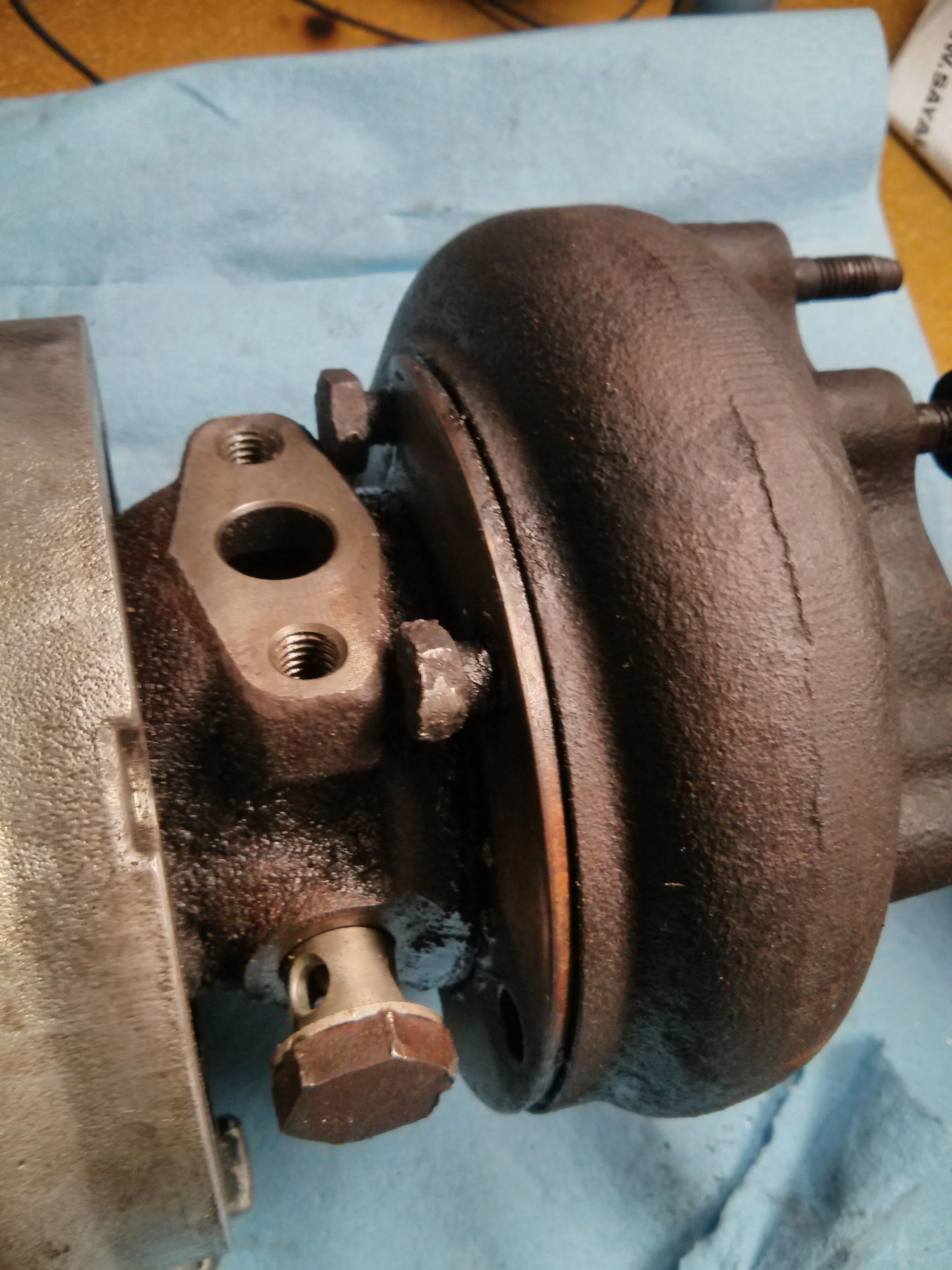

Here it is. The guy told me the engine of a car he was fixing had a hole in the side and the engine was replaced with a turbo.
I bet this is why the engine was replaced.
Somebody being rough with the removal?
Welded actuator?

Looks like the seal on the exhaust side is starting to go bad causing it to leak/burn.

What now? These 2 bolts can't come out until I pull off the turbine housing.
attachment.php
attachment.php
How am I suppose to take the turbine housing off? its practically glued on...

lol i ran into the same problem with the last turbo i bought. You can either take a grinder and cut the bolts off and then use an extractor to remove them or you can take some pb blaster, soak where the chra meets the exhaust housing and then take a rubber mallet and start hammering away. Just don't hit it too hard or you might damage the turbine wheel when the housing finally decides to separate.
