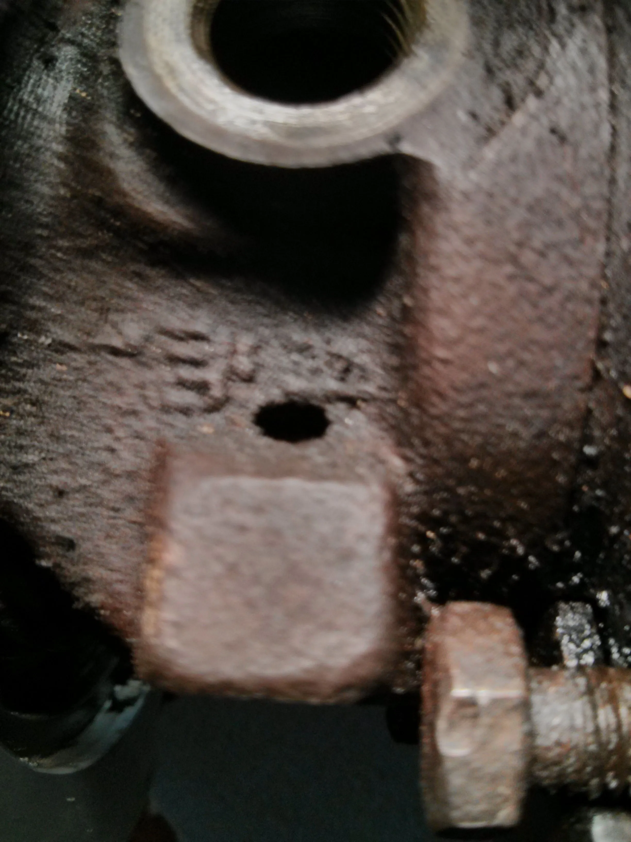

While cleaning the turbo from oil residue, I did see this... Kinda scared me, but it doesn't seem to be a completed hole, but rather a manufacturing imperfection. Anyone seen something like this before?
attachment.php
That's normal, just from drilling and tapping the hole for one of the oil return bolts.

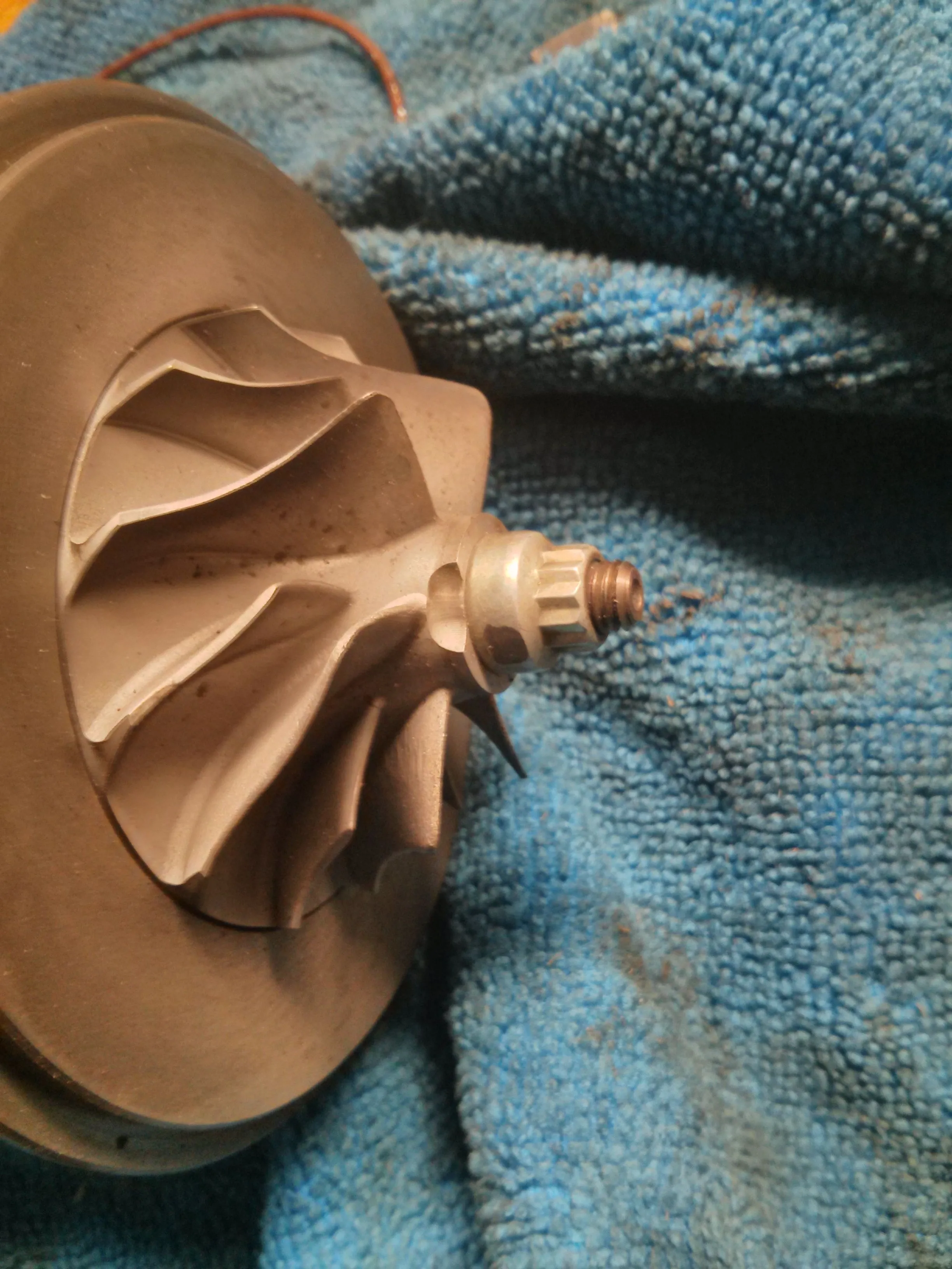

It looks like the turbo was balanced... Should I get it rebalance or just mark it and reassemble it? What should I mark, just in case common sense gets the best of me?
I also want to mention that the nut has been ground down in 2 areas, is it ok to replace it or do I need to reuse the same nut?
attachment.php
Also looks like they balanced with the compressor housing on and carelessly, what do you guys think?

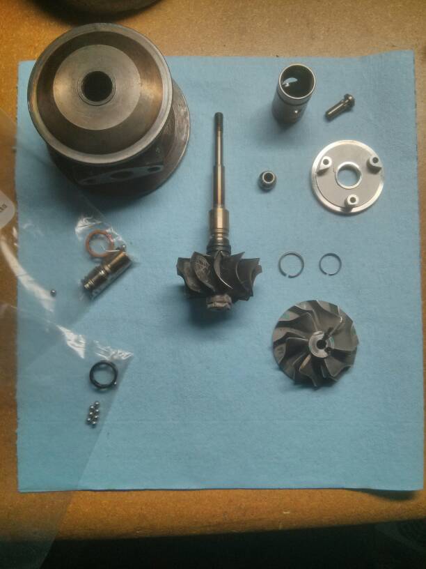

Well, I got it apart as far as the compressor wheel, but the turbine shaft does not want to come out... I don't want to go too hard on it because this part is sensitive. I have already tried putting the nut back on and tapping it with a hammer and it seems like it moved a bit, but still no luck. In fact I got a little scared as there is binding in the shaft when i spin it!
Also, The little plate behind the compressor wheel has 3 bolts with allen head screws that I am not having luck removing either.
Well, I rebuilt the turbo.
New seals are on.
But of all things, I can't seem to remove the sheared bolt off the turbine housing... I drilled at it, tried screw extractors, I am at the point where there is not much of the bolt metal left... Any advice here?
