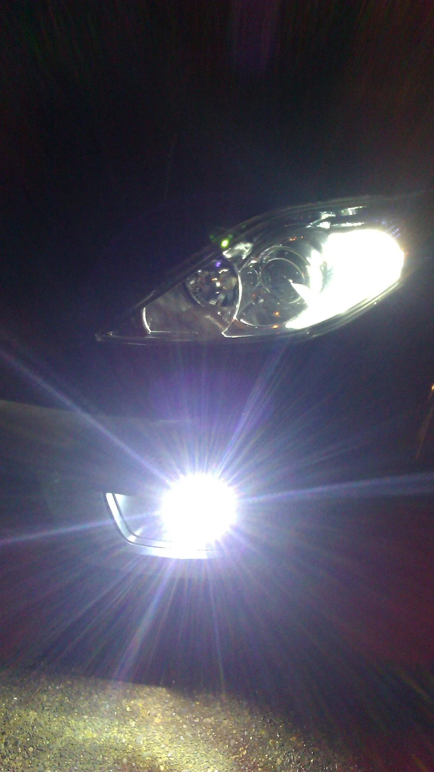

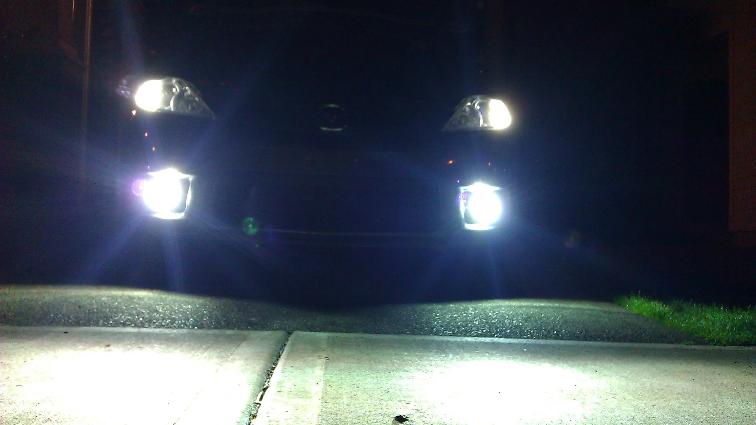

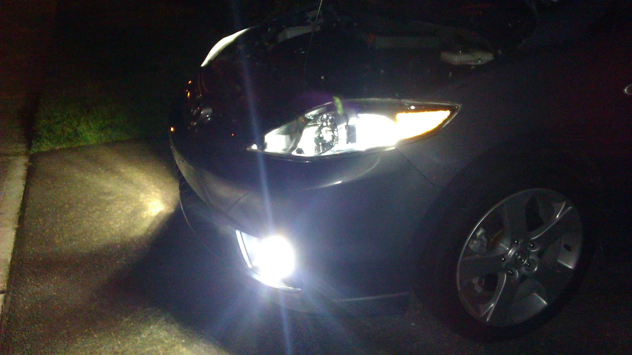

Photos please! Very interested in these switchback turn signals.
Here are a few photos taken with my phone the day I did this mod (only the side markers and fogs are on). Might take a video too and post it on youtube or something with a link to here once I receive the smoke LED side markers to complete my LED set up. The turn signal switchback LEDs are white unless the turn signal is activated. Then the white goes off and only amber is blinking. About 2 seconds after the turn signal is deactivated, the bulb goes back to white.

this is how the Type 2 switchback LEDs work (I bought them from v-leds.com, but mine are 92 M-SMT, and the ones pictured in the video are 60). As I said earlier, I will try to post a video of mine sometime soon.
By the way, while installing the HIDs into the fog lights, I ran into the same problem as I did in my CX-7 a while back - the bulbs are too long so they're hitting the glare shield. Something had to give, so on my CX-7 install the small guards for the ground wire on the HID broke. This time I decided to avoid that, and removed the glare shields altogether. It looks bright when looking directly at it from a close distance, but it's actually not too bad since the fogs are aimed pretty low. No complaints from other drivers so far...
