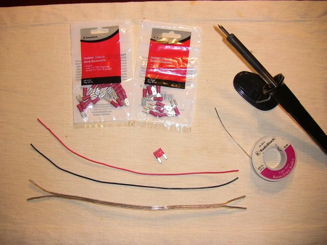

Get yourself the following together:
1) 1/4" and 3/16" blade connectors in male and female.​
2) 4 pieces of wire (6" - 10" in length)​
A) 16 AWG pair (speaker) wire - gets the 1/4" connectors
B) 22-24 AWG power/ground wires - gets the 3/16" connectors​
3) 10A mini ATM fuse​

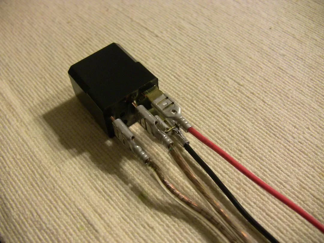

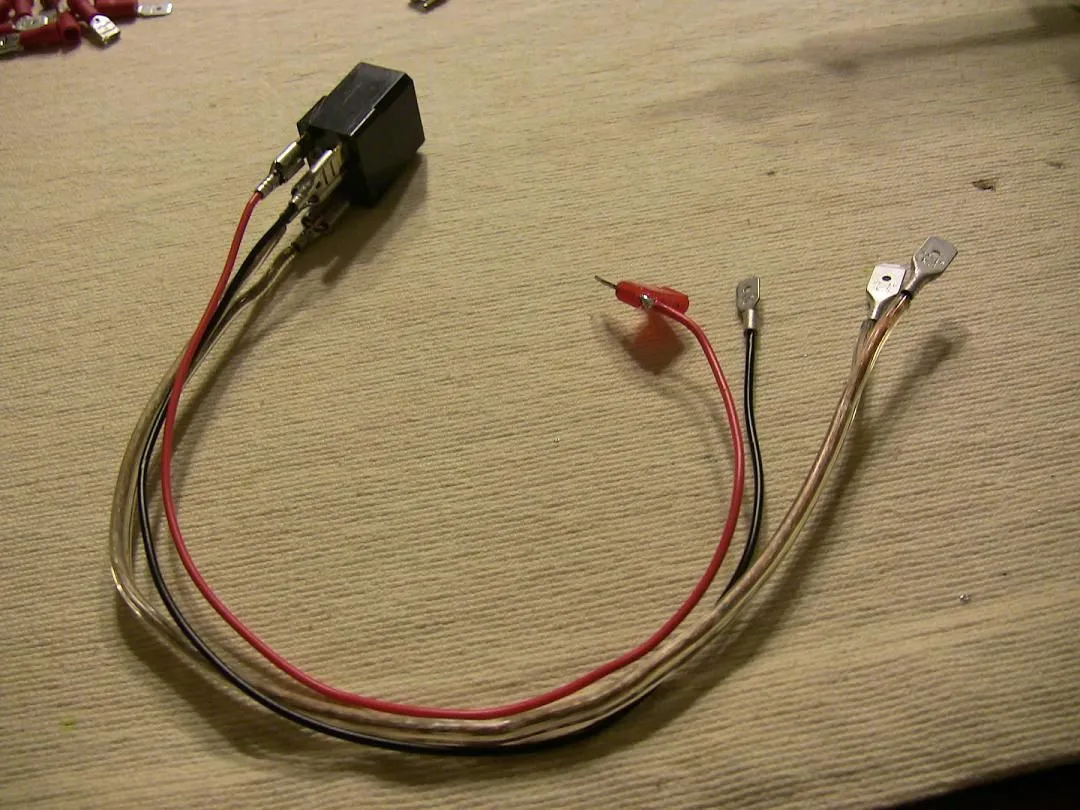

You can crimp the connectors on, I chose solder. Snip the corner off the 10A fuse and solder the other end of the power wire to one of it's legs. This simply activates the relay, so very little current passes through it. Pull the fog relay out of the Fuse Center under the hood and connect your wires to it like this:

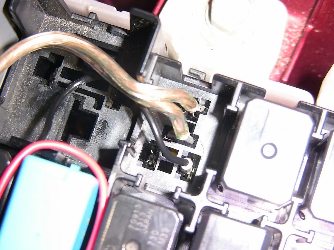

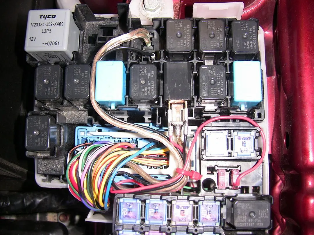

Now get back under your hood and connect it all up like this. Notice the orientation of the fuse. This ensures that the current you pass through the power wire comes from the fused side of the circuit. I used 10" wires, therefore there was some tucking/zip-tying to do. The relay now rests in the empty spot you see.

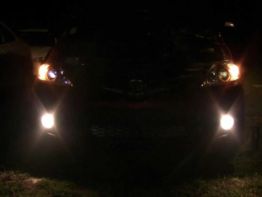

Final Result. They now come on with the parking lights. Switch works the same as before and the high beams cut them off. I call this 'Option 1' because I think I may just clip off the power leg of the relay and change the source of it. This way there's only 1 wire and not 4. Plus I will have mine running as DRLs instead.
