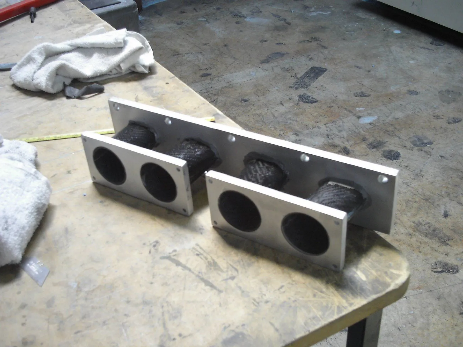

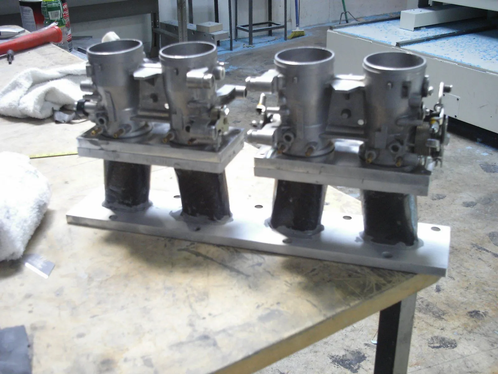

Hi guys, I am new to the protege world. I have done a bit with miatas and spec miatas but this is my first fwd. Needed something with a bit more room. Anyway, here is the plan so far. Got a 95 Protege with a blown Z5 and am swapping in a BP I had lying around. I rebuilt the BP to stock and built a megasquirt to run it. I am running the ms setup with ignition from a miata(CAS and dual coils) and built a diy IRTB setup for it. I am running smallish 38mm throttle bodies to try and keep it reasonably streetable as I want to use this car as a DD eventually. I built a carbon/aluminum intake manifold for the IRTB's and am working on a header now. Here are some pics. there are more if you go to http://picasaweb.google.com/mgriffin.michael/Carbon6061IRTB
