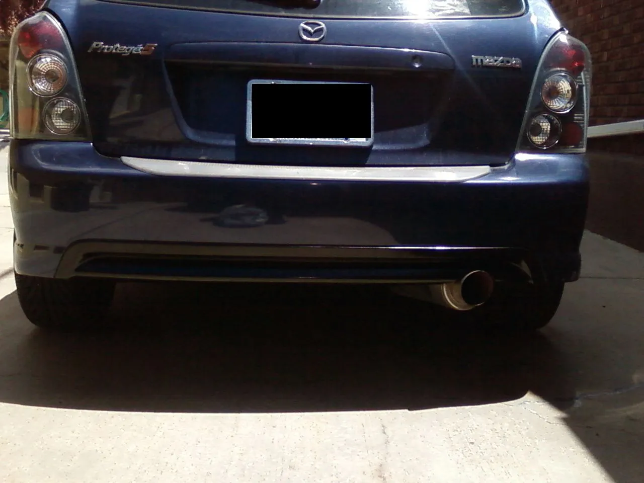

Im painting my rear valence black tomarrow...Im interested in adding 2-3 layers of clearcoat. Good or bad idea? Any other tips, advice, or suggestions are welcome...

you double posted by mistake but to answer your question, I don't see why it would be a bad idea. Just make sure to wait 24 hrs before applying the clear. If you apply it soon after the paint, it will make it eventually crack.

For somethings that small, should 2 layers be enough?
lol I have no idea how to delete it. Maybe the moderators will take care of it. It really isn't a biggie. I think 2 coats should be enough. Of clear though not the paint.

i wouldn't do it. i like the smooth look of one color bumpers, just get the bumper scratch guard if you want contrast. factory paint owns ALL!!
never heard that one before.. more like wait 20 mins before you apply the clear coat and 10 or so between coats depending on the temp where you paint it and if your using strait clear or ruduced like fast or medium reducer.. if you wait 24 hrs before you put clear on your going to have to wet sand the whole thing down real well, then clear it.. or the clear will flake off.. since the base coat and clear cannot bond together as one is dry.. even if you wet sand it there still a chance.. and id suggest a plastic adheasen promoter before the primer if you take it down to the plastic.. U-tech Dupont Duplicolor all have been good to me.. ive had bad luck with Crossfire...
Ummm..No.
Waiting 24 hours or more will cause ou adhesion problems if anything depending on what type of paint you are using..Cracking will be your LAST worry.
I agree here...The black lip on the Midnight Blue will not stand out like on a lighter color car and IMHO will not look good.
I say leave it alone..you will be better off in the long run and it looks better on that color to have it Monchromatic(one color).

I think clearcoat would look good on your valence if you do paint it. The glossy look would fit better with your rims and taillights than flat black.

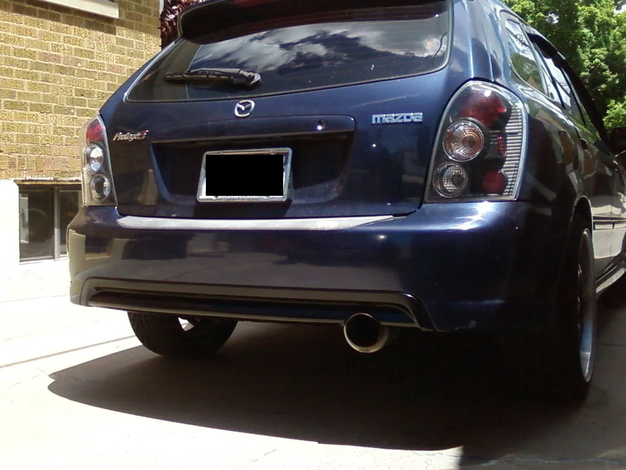

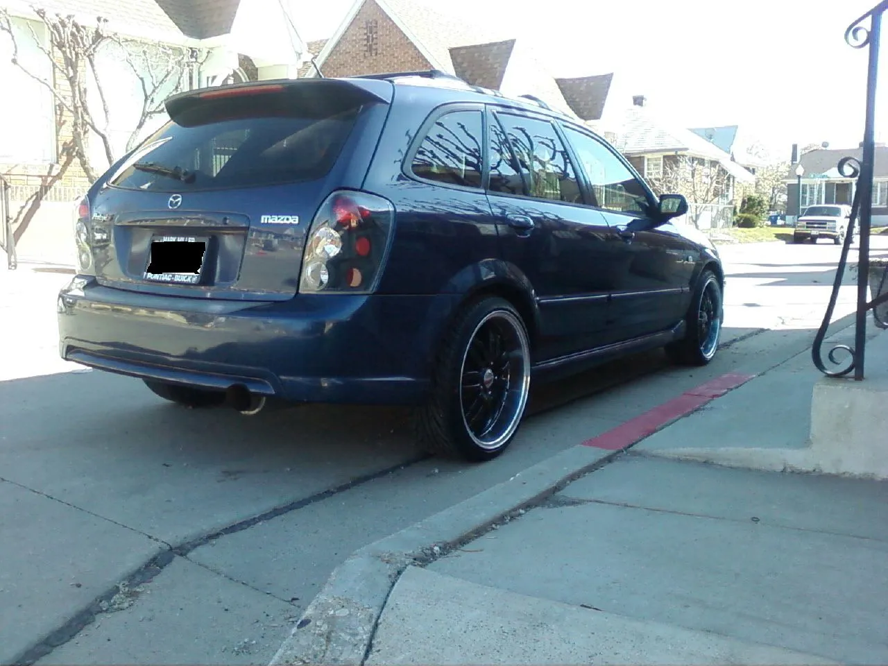

Update....Heres some photos of my ride.:D
I used Duplicolor semi-gloss paint for the rear valence. I wasnt too sure about adding clear coat, so i didnt. I went with 2 coats of paint and I think it turned out pretty good. (cabpatch)Not too noticable on midnight blue but adds a little bit of flavor to it.
(Working on the bumper guard later Thursday, just waiting for my Black WOW to arrive. Hopefully it helps)

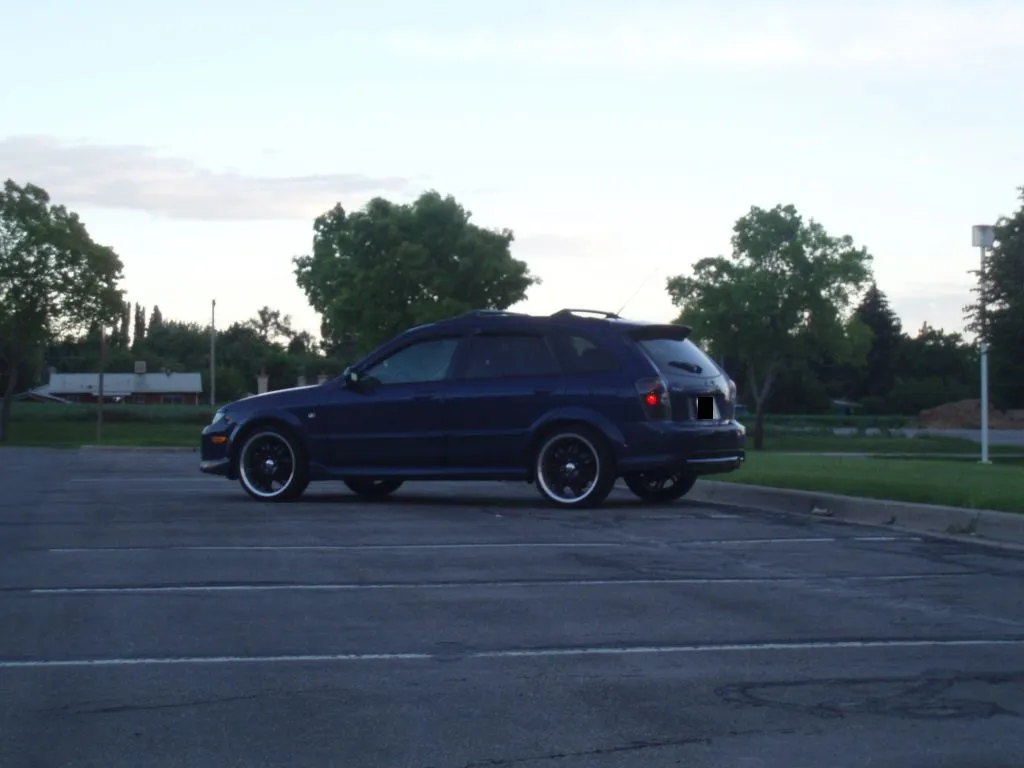

Heres a few better pictures from earlier today....
