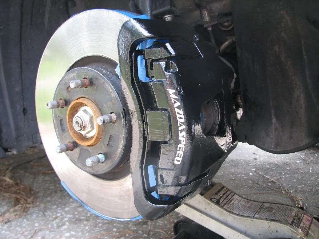

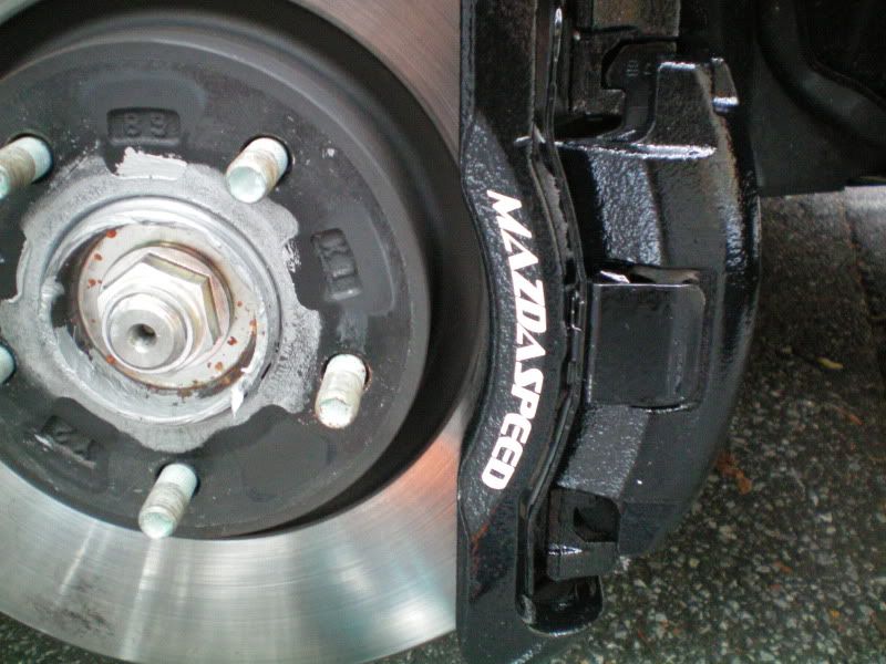

Just thought I would share my first (of many) mods......

The reason I went with black was i was afraid I wouldn't be able to match the True Red and plus I wanted to be stealthy. Here's hoping the decals last!

set the sticker into the just tacky paint
LOTSA paint left, I coated very well and could do a second car easy (Bill?)
preclean with standard cleaners and save the kit can for a final go over
stickers are a pain! wow gettin off the backing and onto the release each little part. using a sharp peel angle helps, but no guaranty

one process I saw that looked really good was the guy laid down a primer. he than laid down a coat of white, applied the sticker. Laid down a few coats of red than removed the sticker. The white really stood out and didnt get all busted up later on like some of the stickers do.

Got mine from here. Ordered the MAZDASPEED one in white (for the fronts) and then just the slanted "3" for the rears. Got the idea from KRYSTM. Hopefully it'll look slick on G2 black paint when it's done :)
EDIT* They're done!!!
i kinda dig the painted calipers... a nice red poking out from our rims might look nice..... questions:
how in the hell do you get those decals to stay on there, and handle the heat of the brakes? i figured the heat would just melt them off... or do you put down a white coat underneath, and then peel off the decals after you do the red?
can you take the paint back off if you feel like it? acetone, or something?
Most people use decals. I haven't read any stories of people's vinyl decals melting off. I suppose they could if someone were tracking their cars regularly, but it seems that most people who put them on don't really track/don't put their cars through heavy duty use.
I have tracked my car once with the decals & they are fine. I am going to the track again sep 19th, so will see how they hold up to 2 track days a couple of months apart. I also did not clear coat mine.
I have had my decals on for a year now and i haven't any kind of peel.
They just get dirty.
