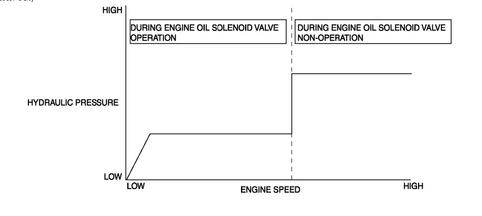

OP,
do you have access to a service manual??
The "Service Highlights" section has LOTS and LOTS of info about the oil pump of the CX-5.
One component that sticks out is the Engine Oil Solenoid valve.
It's a valve that closes when RPM is high and it increases the oil pressure.
attachment.php
This valve being stuck closed would explain why you get good pressure at LOW RPM but not at high RPM.
This valve is attached to the outside of the engine block and a competent mechanic should be able to replace it in 10 minutes flat.
