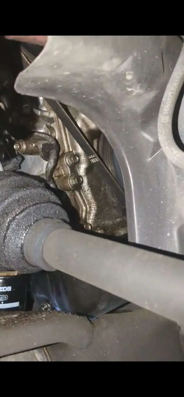

I have a 2019 CX-5 with 71k miles and a few weeks ago I noticed a tiny drop of oil here and there on my garage floor. I check the oil level and it was and still is perfect. Even though the oil drops were burly noticeable it bothered me so I took it to the dealership and they did an inspection and found that the Timing cover seal is leaking and the cost to repair is $1500. Does anyone know if i need to fix the leak asap? or i can wait? Is this common in Mazda? I read online that sometimes the fix is not 100%. I am so disapointend in Mazda I thought Japanese-built engines are among the best in the world.
For reference, I bought this car for 3 months and it had no leak and it ran perfectly. I did get a second opinion from a local Japanese mechanic who basically quoted me the same price. Any thoughts on what do to do. Obviously, this car is out of warranty and has no extended warranty.

They tried their hand to fix mine under warranty... it came back as weep/seep during the winter months. For some reason warmer temps it just dries up.
It has never resulted in any noticeable oil loss between changes for years now.

The repair is covered by the 5-year power train warranty provided you also meet the mileage criteria. I have a 2018 and the timing cover leak was repaired earlier this spring. In Canada the warranty is 5 years with unlimited mileage. The timing cover leak is a known issue for the 2.5 (non-turbo) engine. I would discuss it further with the service manager and/or Mazda corporate.
I looked at the timing cover area from the top of the engine yesterday and it appears that there are a few drops of oil there again. My guess is that when I do my next oil change in the fall that I will see additional small amounts of oil dripping down to the top of the oil pan like I saw before the repair. The leakage is very minimal. Just enough to notice that something is leaking. Between oil changes there has never been enough leakage to see any indication of oil loss on the dip stick.
IMO when they do the repair they don't allow enough time for the gasket sealant to properly dry before they ship the vehicle out of the garage thus, the repair doesn't work. I have until March 2024 before the power train warranty expires for them to perhaps get a second change to repair it properly.
Might be buried in my old rear main seal thread
Wow so they fixed it and the leak came back? I agree I think it has very little effect on oil level. My concern if the leak gets worse I live in Vegas and the temperature right now 110 and it is leaking so should expect it to leak more during the winter months?

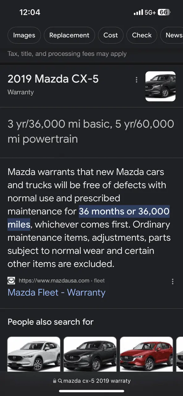

Wow the Mazda warranty in Canada is amazing. Here in the USofA I am definitely not covered.. 3 years or 36k miles.
So you have a similar leak and you’re not concerned about doing it anytime soon even though it is covered? I am leaning toward just leaving as is for the next 6 months and see what happens. The fact that the fix not 100% seal makes me skeptical of even trying to fix.

^^^^ Prior to the repair I monitored the leak/seep for about 8 months. I had the repair done at the same time as the fuel pump recall.
As I had mentioned previously, there was no visible oil loss on the dip stick. The oil on the bottom of the timing cover and the few drops that dripped down to top of the oil pan was barely noticeable. My guess if the dealership was doing the oil change they wouldn’t have noticed.
I am going to monitor the seep for the next few months and I will likely get it repaired under warranty at another dealer before my warranty expires in March 2024. Perhaps they will do a better job.

Your 2019 CX-5 has 71K miles, it’s definitely out of 5-year / 60K-mile powertrain warranty in the US.
There’s a TSB for this timing chain cover oil leak problem, and the procedure is complicated. That’s why the failure rate of this fix is high. Some here had tried twice and the area still weeps.
If I were you I’d just leave it along without warranty. Check the oil level more often, and look the leak area often making sure it doesn’t get worse.
Try to use high-mileage full synthetic 5W-30 oil (I definitely will use “Mazda approved” thicker 5W-30 oil instead of 0W-20 in Las Vegas) and see if the condition improves.
