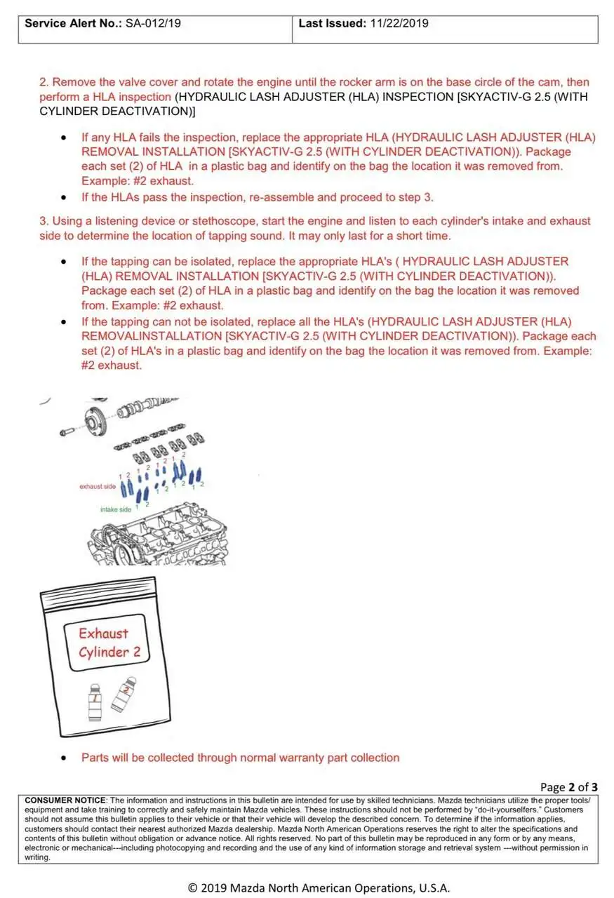

In the service alert it does provide instructions on how to test the HLA's to find the noisy ones, but given they re-designed the for a reason....you would think they would do them all.

He must be talking about “Switchable” Hydraulic Lash Adjusters used on cylinder #1 and #4 with the total of 8. But the Service Alert does mention all 16 HLAs, including the normal ones, should be replaced if needed.

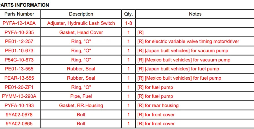

According to the service alert there are 8 switchable HLA's. I only got a glance at the parts order list and didn't see the quantities, but did look about as long at he Service Alert part list snipped below.
I'll find out more when the parts arrive and the work is scheduled.

He must be talking about “Switchable” Hydraulic Lift Adjusters used on cylinder #1 and #4 with the total of 8. But the Service Alert does mention all 16 HLAs, including the normal ones, should be replaced if needed.
I'm not seeing a reference to anything other than the switchable HLAs, in my most recent 'tapping noise' TSB (#01-002/21 on 04/30/21)
