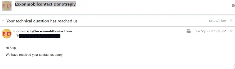

I have a technical request out (see attached) to one of the oil filters manufactures with the exact question of their application single number for the MAZDA. I will also send them the translated report information provided by sinistriel.
Perhaps an answer will come soon and at least for one oil filter manufacture can introduce more informative information and not speculation for a few MAZDA Turbo and NA engine oil filter aftermarket brands
I also interpret the exact meaning of the he Magnuson–Moss Warranty Act (P.L. 93-637) using a aftermarket product that any aftermarket company listing for the use on a specific application part an auto manufacture cannot void a claim of warranty. So, ask yourself why would several different oil filter companies list a product for use that could have them being sued for damages? If it were only a single company, I would be cautious, but it is no less than 5 oil filter suppliers that I looked up? Anyone can do the same and all top tier companies.
The BMW and Chrysler engine I referenced has high volume oil system similar like new MAZDA I never said which model production car nor engine. My conclusion was that MAZDA thus far has not shown by way of technical information like the flow rate and or pressure data why they offered a separate specific Turbo oil filter anywhere? And what I found on this forum the repeated information from yrwei52 while it is good is not a technical and a universal directed cautionary which is often applied by auto manufactures to indirectly suggest not using aftermarket replacement parts. In other words, it is their way of making some believe that if you don't use OEM you may have problems?
I will post what they answer to, and all the contact information should any feel the need to verify it.
