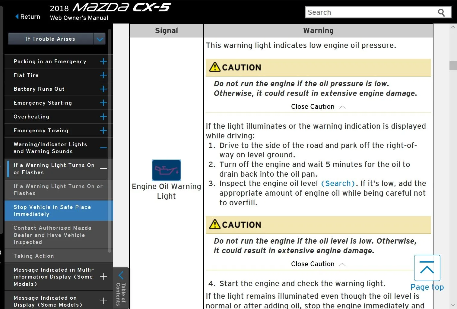

Are you saying the red low oil pressure warning light came on? Usually this means you oil pressure is too low, but it doesn't necessary mean your oil level is low such as when oil pump is failing or you're playing with rod end bearings like Chris_Top_Her. In your situation it seemed to associate with oil level. No matter, either way this definitely means something is wrong to your engine. Take some pictures when the low oil pressure light is on and present them to you Mazda dealer. Do it ASAP.
No, there's no oil level sensor on CX-5, or we'll see the amber low oil level warning light in our instrument cluster.

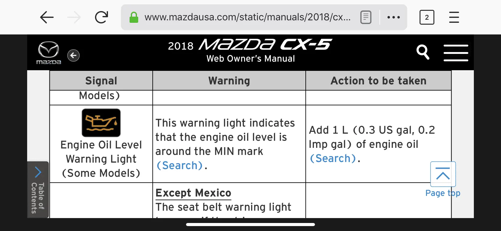

Yes, there is an oil level sensor. It*s in the manual for the 2018 models.

But it does say Some Models. My 2016 CX-5 owners manual has Memory Seat section and says Some Medels too. But the fact is its not available in any of the models at the time. My 2016 CX-5 GT AWD doesnt have this Low Oil Level warning light icon in instrument cluster. Unless you see this icon when you turn the ignition on, you dont have oil level sensor.
Still we dont know the warning light OP saw is from Low Oil Pressure or Low Oil Level.
And I should mention what I said is only for US CX-5. I do aware the Low Oil Level warning light sometimes does available in other markets, even on gen-1 CX-5.
CBut it does say *Some Models*. My 2016 CX-5 owner*s manual has Memory Seat section and says *Some Medels* too. But the fact is it*s not available in any of the models at the time. My 2016 CX-5 GT AWD doesn*t have this Low Oil Level warning light icon in instrument cluster. Unless you see this icon when you turn the ignition on, you don*t have oil level sensor.
Still we don*t know the warning light OP saw is from Low Oil Pressure or Low Oil Level.
All manuals have "some models" stipulations, you're not going to create a different manual for each individual trim level and package option, this isn't anything new. OP stated twice in his first post that he saw the low oil light. Yes, I've asked OP to clarify that it is in fact the low oil light and isn't confusing it for the low oil pressure light, but until that clarification occurs we should be basing our recommendations on the facts given. In this case, he is seeing a low oil light.
And you're correct, your 2016 CX-5 doesn't have an oil level light, it also doesn't state it as an option in the manual. This is different for the 2018 models.
Not necessary. Our Low Oil Pressure warning light won't say "Some Models". Whenever the manual says "Some Models", it simply means the feature is optional, sometimes it's not even available like the Memory Seat feature I mentioned earlier.
Low Oil Level warning light may be available for 2.5L with cylinder deactivation. But until someone posts a picture of such icon from its instrument cluster, I really doubt it's available on CX-5 for US market.
On a side note, it's interesting to see when Low Oil Level warning light is on, Mazda says the oil level is around the MIN mark and we should add 1 liter (1.05669 US quarts) of engine oil. This means the oil capacity should be 5.3~5.4 quarts for our 2.5L, not the specified 4.8 quarts. ;)

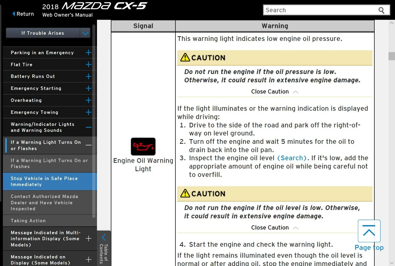

attachment.php
