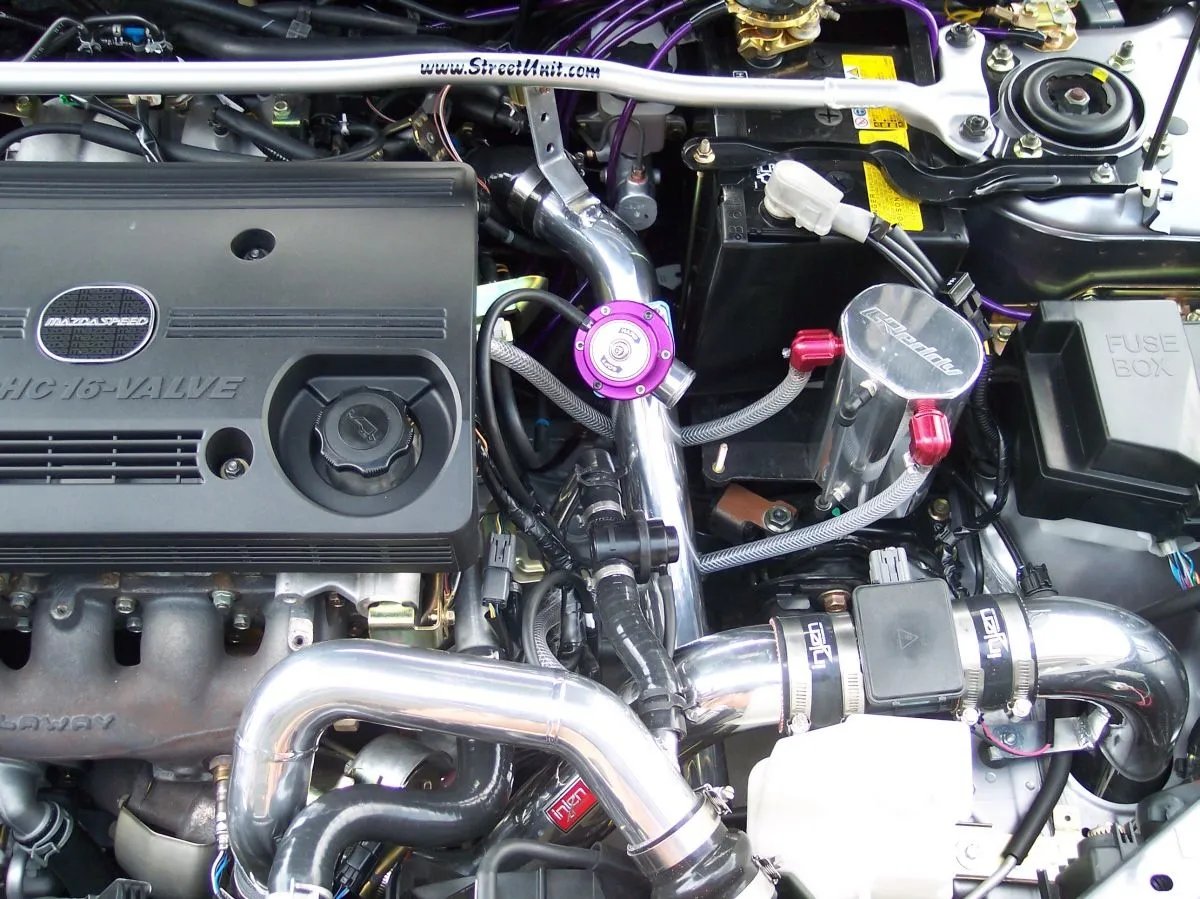

Here's mine at the bottom. It has 'mazdaspeed' engraved on the side which you can't see in the pic. I like it MUCH better than the plastic collant holder. Not sure why they call it a oil catch can cause it only catches coolant. lol You can see the collant passing through it.

Knock on wood, my car has never leaked any oil. When I put the catch can in, I didnt see any oil from anywhere. I know its supposed to catch the excess oil, but never saw any to catch??? Oh well. It serves a purpose right where it is and looks pretty good. I dont think it's really needed, more of just an engine dress up.
You can use it on the PCV system to catch oil blow by, or like LaraCroft is as a coolant resovoir tank that looks nicer. :)
Besides engine dress up, the oil catch can collects oil, moisture, and crap that causes sludge and carbon build up in the engine and intake system. Over time you will see the inside on the can fill up, not right away. It is a product that will help the car in the long run.
It can also be used as a coolant resivoir.
