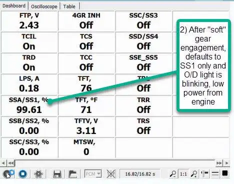

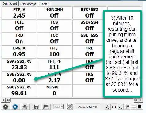

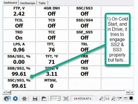

If I start out cold, SS1 is engaged fully but not SS2 or SS3, but at first it does try to turn them on.

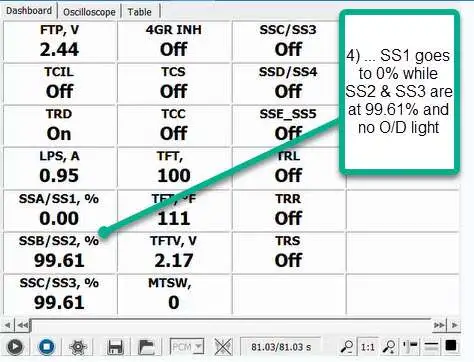

Once it's warmed up, SS1 is slightly engaged for a hot second then SS2 and SS3 are fully on so that seems like the proper condition.

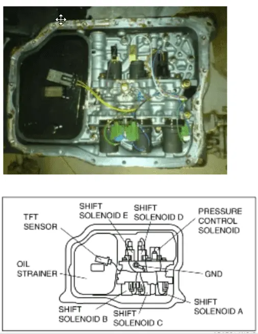

From what I can see from the Solenoid Apply Chart (PDF) that looks like SS2 and SS3 are Shift "D" and Shift "E" respectively.
I assume that means that SS1 = Shift "C" but the only time that's supposed to be engaged is when it's in 4th gear... the Over Drive gear maybe?
Can anyone confirm what's going on here? I'm going to replace out the Input Speed Sensor since it's accessible but other than that, I can only think of bringing it to a transmission shop for a diagnostic and maybe a new transmission filter. But since the solenoids are right there when you open the pan (picture), maybe it's a good time to replace those too.

Something I discovered today while diagnosing with FORScan is that when the vehicle has this problem, it starts in 3rd or 4th gear. That means something is triggering the computer to do this. Other sensors seem to be okay, like the transmission fluid temperature sensor and the turbine speed sensor, so I'm thinking that the problem may be with the range transmission sensor. I'll swap it to see if it changes something.
Edit: I was looking into the data that you posted before, and yes, that's exactly what my vehicle is doing, so both vehicles have the exact same problem.
Yes, it's being dropped into limp mode. Other vehicles have different indicators but the result is the same. Good luck with the range transmission sensor!
