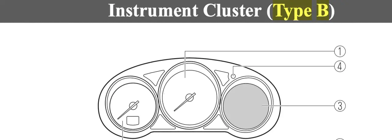

Then does the speed limit sign show up somewhere else (the center console?) if I have something else on the Infotainment Screen? I have "Instrument Cluster Type B" I think--round display on right with all the optional screens. Thanks.

So I have this display and it doesn't even list TSR as what will show up, only these items:
Odometer
Trip meter
Engine coolant temperature gauge
Fuel gauge
Outside temperature
Distance-to-empty
Average fuel economy
Current fuel economy
Maintenance Monitor
Blind Spot Monitoring (BSM) Display
Distance Recognition Support System (DRSS) Display
Mazda Radar Cruise Control with Stop & Go function (MRCC with Stop & Go function)
System Display
Traffic Jam Assist (TJA) Display
Lane-keep Assist System (LAS) & Lane Departure Warning System (LDWS) Display
Cruise Control Display
Compass Display
Message Display
It DOES list TSR on Instrument Cluster Type A. So....maybe it will only show up with the Nav Screen on. 🤷🏼‍♀️

For some reason mazda may have disabled the tsr icon to show on the non digital cluster. At least thats how it is on my 2018 with hud but non digital cluster.
I think that is the case. I have a 2023 Preferred trim without HUD and a non-digital cluster. So the TSR seems to only show up on the Nav screen. It's not a big issue--I've been driving for 50 years without TSR. 🙃 Just trying to understand all the features I actually DO have.
There is a way to activate it in the non digital cluster but its not publicly shared unfortunately.
I tried for my 2018 but the guys that know how want $$
