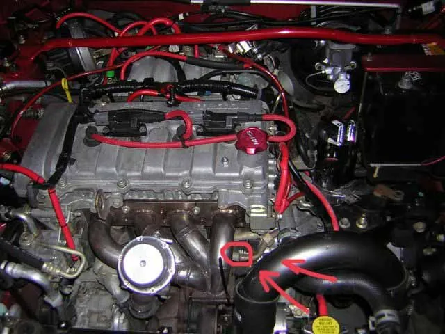

I had the same issue when I went turboed but I for got to plug off this :
