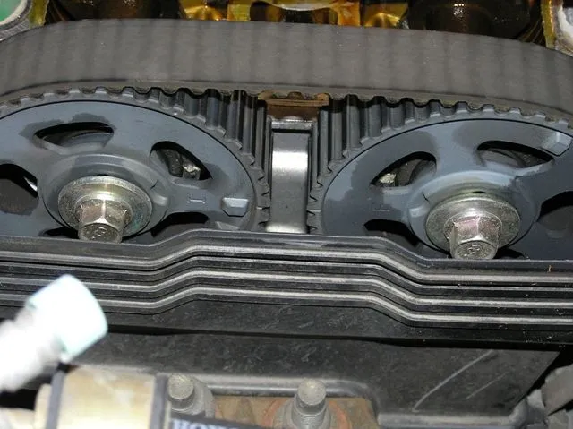

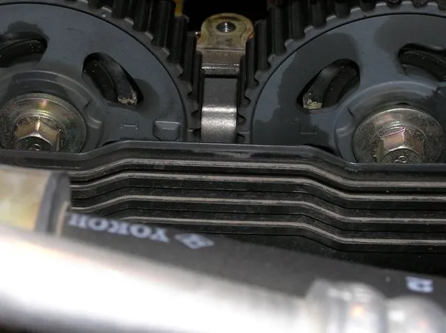

I believe the manual is correct. The photos of a head in the previous posts appears to be correct. My photos show the relative positions of the cam sprockets from an engine that runs well. The notches in the sprocket rims need to be aligned, not the I and the E. In the other cam photos earlier in this thread, the valves are closed, as they should be, with the exhaust valve about to open with CW rotation of the engine. (Note that I have revised this post after looking at the cam photos and trying to confirm the engine rotation relative to the cam operation.) I believe that what happened on Jesus-man's and another engine was that the cams were installed 180 degrees off from the 'distributor' positioning, which is easy to do without a distributor rotor to check which spark plug will fire next.
I am trying to solve a noise and fuel economy issue and checked my cams as part of a list of things that could be the source of the issues. The engine runs good. The cam positions on my car do not appear to be an issue. If there was a problem and the engine was able to run, I would not expect either cam to be off more than one sprocket tooth.
I took a look at Jesus-man's description of the cam lobe position and his description appears to be incorrect. The #1 exhaust valve will be the next to open. TDC is the top of the compression stroke. The piston will travel downward and the exhaust valve will open somewhere near the bottom of the expansion stroke. As the piston travels upward, the combustion gases will be forced out. Near the top of the exhaust stroke, the exhaust valve will close and the intake valve will open. As the piston travels downward, air and fuel will be drawn into the cylinder. At the bottom of the intake stroke the intake valve closes. The piston travels upward, compressing the air and fuel. Near the top of the compression stoke, the spark plug fires once more, completing the 4-stroke cycle. This description is consistent with the manual and the photos of the lobe positions in earlier posts.
I probably just added to the confusion.
