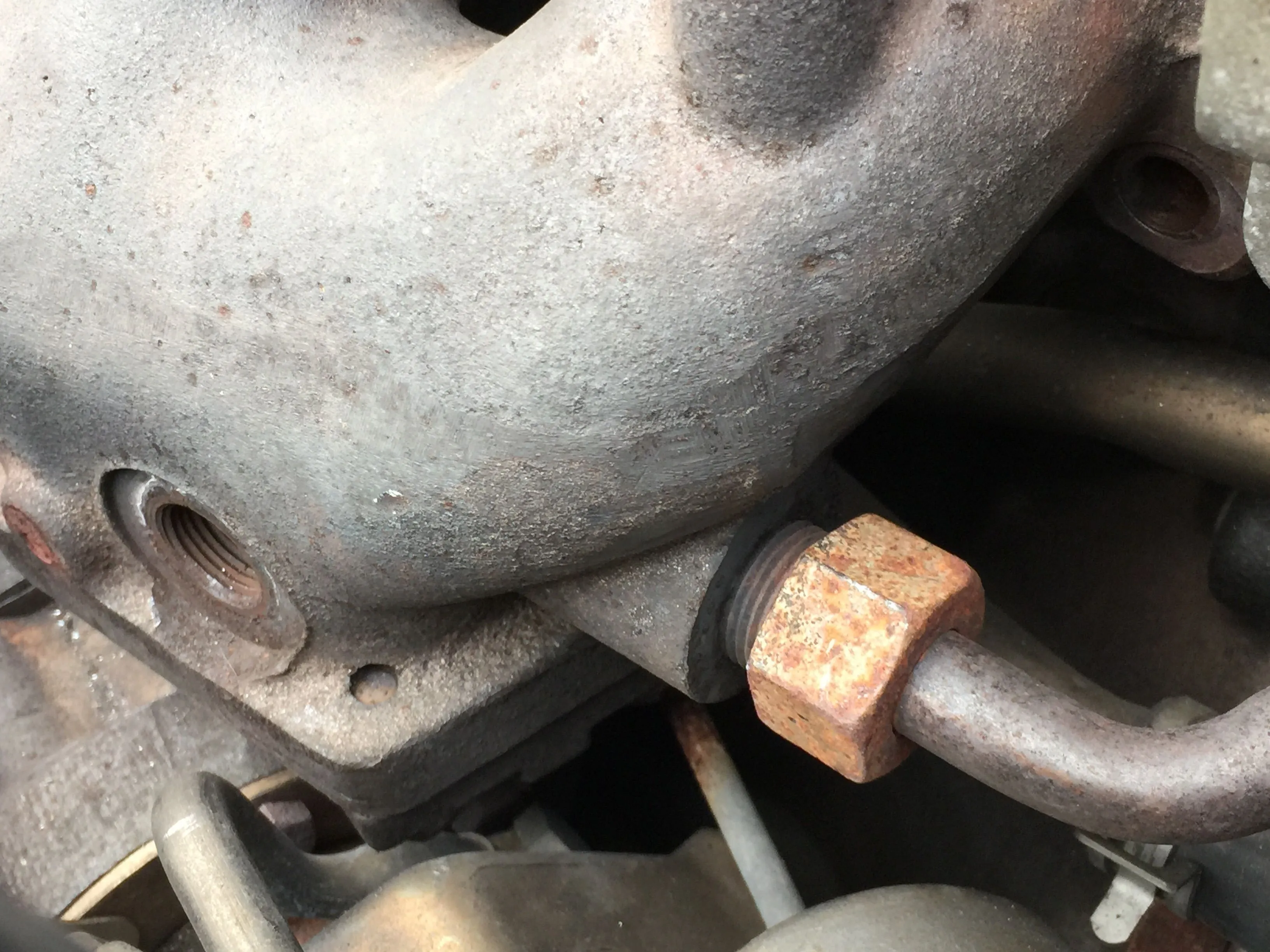

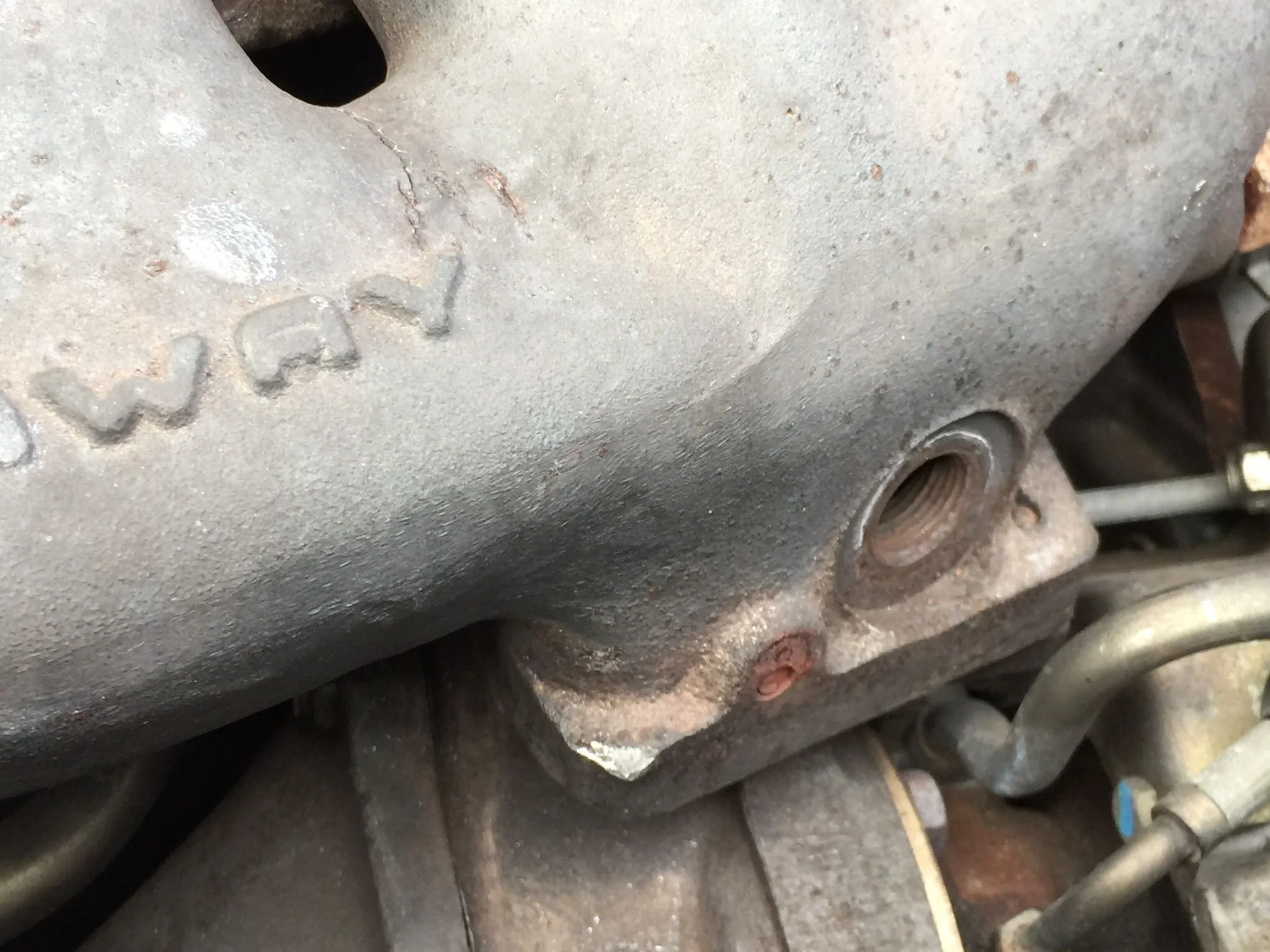

hey all I'm trying to remove my stock callaway turbo manifold but
Running into issues removing it due to the bolts on the flange
Connecting to the turbo. Any tips or advice or a walkthrough would
Be FAntastic!!! Thanks everyone! Here are some pics.

You need to pull the whole unit out of the car. Removing just the manifold and leaving the turbo on the car would take hours longer. Remove the manifold, turbo, and s pipe all together, just unbolt the manifold from the head, and remove the oil/coolant lines, Intercooler pipes, EGR tube, and 3 bolts on the S pipe on the bottom. Thats it. Comes out the top
EDIT: also dont forget about the vac line going to the wastegate
@mazdaguy. Just wanted to say Ty for the advice. I was hoping
Not to have to drop the turbo but guess going to have too!
I'll lift it this weekend and hope all goes well. Thanks again!
