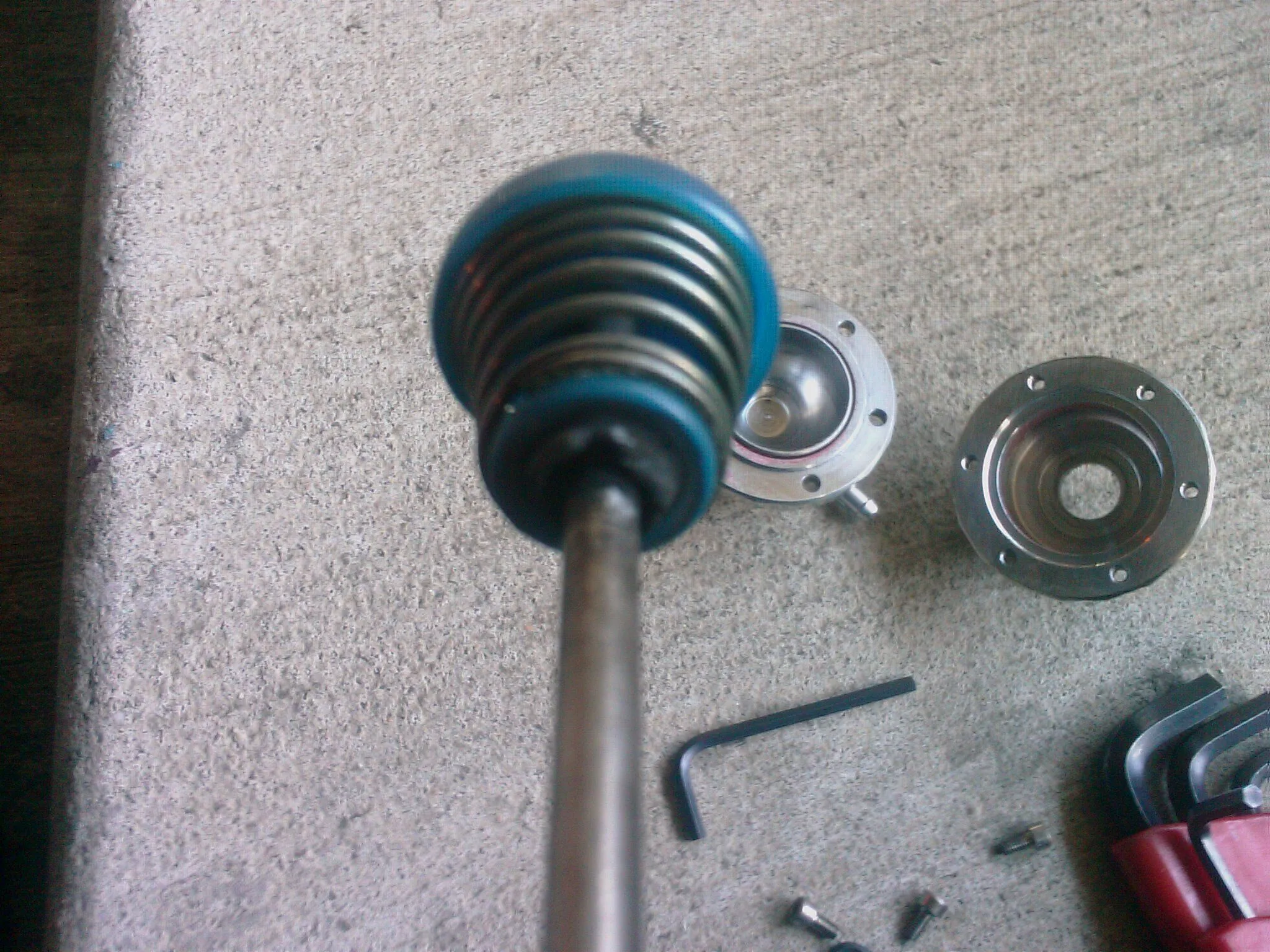

here are the pics. i have a green spring
To everybody who has opened their forge wga. Is the blue cap supposed to be stock to the metal piston or separated?
I've recently had spiking issues where the boost would hold at 4-5psi and spike anywhere to 9-14psi (forge thinks this is an artifact...)
that blue cap on the top is what I've been talking about. It's threaded on, so it unscrews.
Thanks, But I was asking if the metal piston is stuck onto the big blue cap or not. On topher's pics its together where as on my its apart.

My issue was that I couldn't get the boost down... Ken ordered me new springs thinking we had the wrong spring installed, didn't work....I ended up opening the cover and realized that the blue spring cap screws on adding more tension to the spring. I loosened it up and bolted the cap back on. boost was down to a normal 6 psi.
