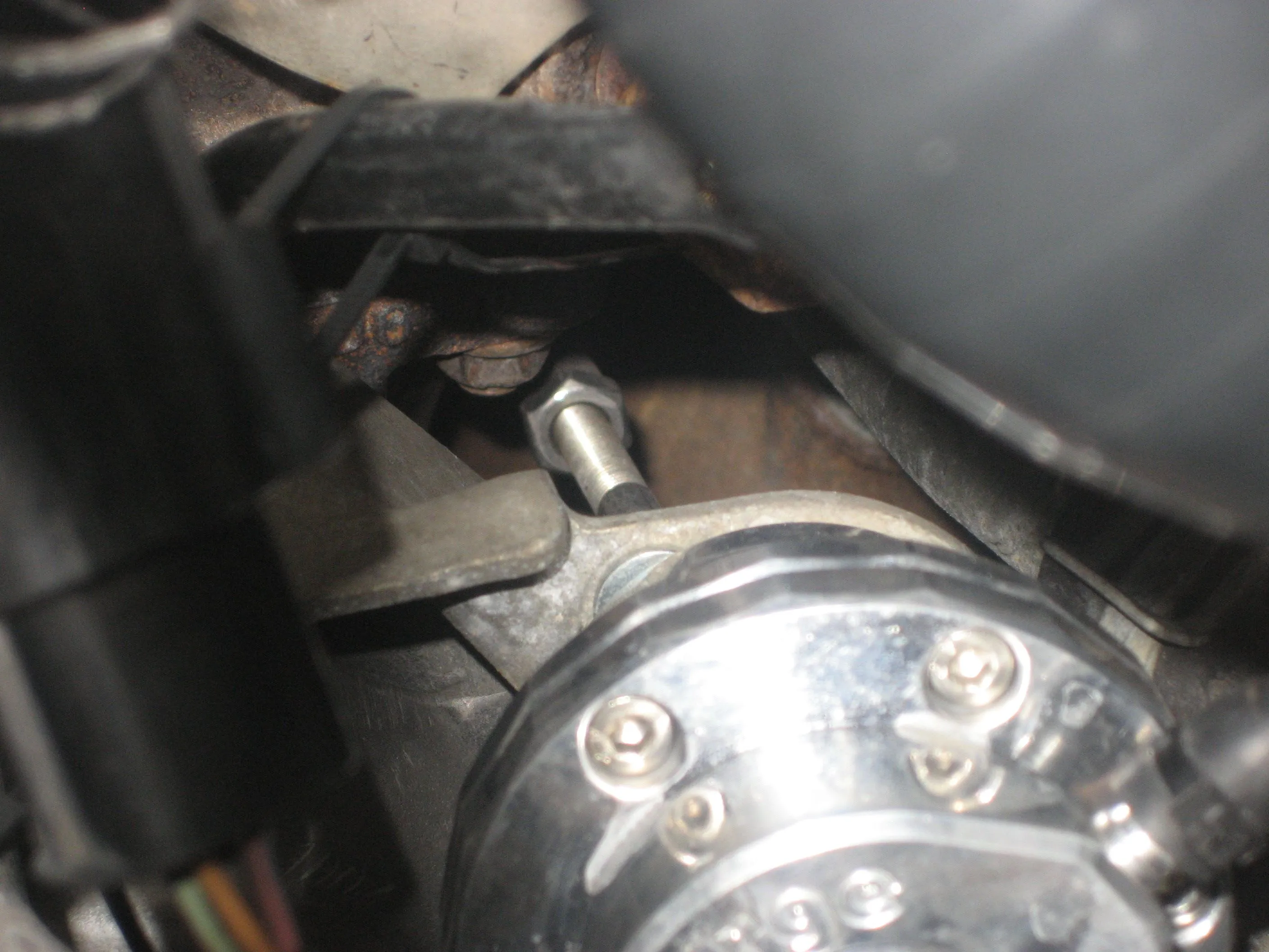

OK the guys at PG did my turbo swap (GT28RS) and installed a Forge WGA Tthey adjust the rod to the very bottom almost the very last thread before falling off to keep the boost at the minimum we though 5 PSI. When I left I was boosting 10-10.5 PSI. We all thought that the Forge unit must have come with the 10 psi spring in it. Ken went ahead and ordered up the 5 psi spring. When we went to swap then it turns out the 5 psi spring was already in it. What gives? If I have the 5 psi spring in and the rod is adjusted all the way down, how is it possible to still be boosting 10 psi?
Here's a pic of the unit on the car maybe someone has some ideas!
maybe the hose that goes to the WGA es bended a little...check that...
(ugh)(nailbyt)
if the rod is adjustable, maybe is too adjusted therefore is physically impossible for the WGA to open fully to liberate the excess of flow...

Ok thought I should update this seeing as I just fixed this issue!
I ended up taking it apart and swapping out the springs again. The unit supposedly came with a 5 PSI spring in it, and Ken at PG ordered another 5psi spring which came 2 in the package, we swapped one and it stayed the same.
Well today I swapped in the last of the three which were all green BTW, but when reassembling it all I realized that the Blue spring holder inside the WGA can be tightened down real tight or left fairly loose, The tighter it got the more load was put in the spring. So I left it kinda loose but stable and also gave the Rod a little less angle by the way it tightened it down. The way it was before it was at a real bad angle and seems to get stuck on itself. I bolted everything back together and went for a test drive in the local empty lot and sure enough 5-6 PSI at WOT!!! I can't tell you how happy I am. I drive it for about 10 min. to make sure it wasn't a fluke but sure enough never got passed 7 psi no matter how hard I tried!!!
when you remove the allen bolts and take off the metal top, directly underneith is a blue plastic cap that holds the spring in place it screws onto the rod that goes through the whole WGA. When I was thinking about how everything works I realized that the tighter you screw it in the tigher the spring gets...more load. I left it secure but rather loose. I didn't screw it all the way down. That solved my issue and I'm boosting 5-6 psi. With it fully tightened I was at 10.5 PSI. I will also say that I needed to adjust the vas hose. I did this by simply rotating the metal cover one bolt hole. It was facing down causing a strange bend in the hose, it wasn't kinked though. By doing this it gave the Vac line a straighter route which might have helped as well.

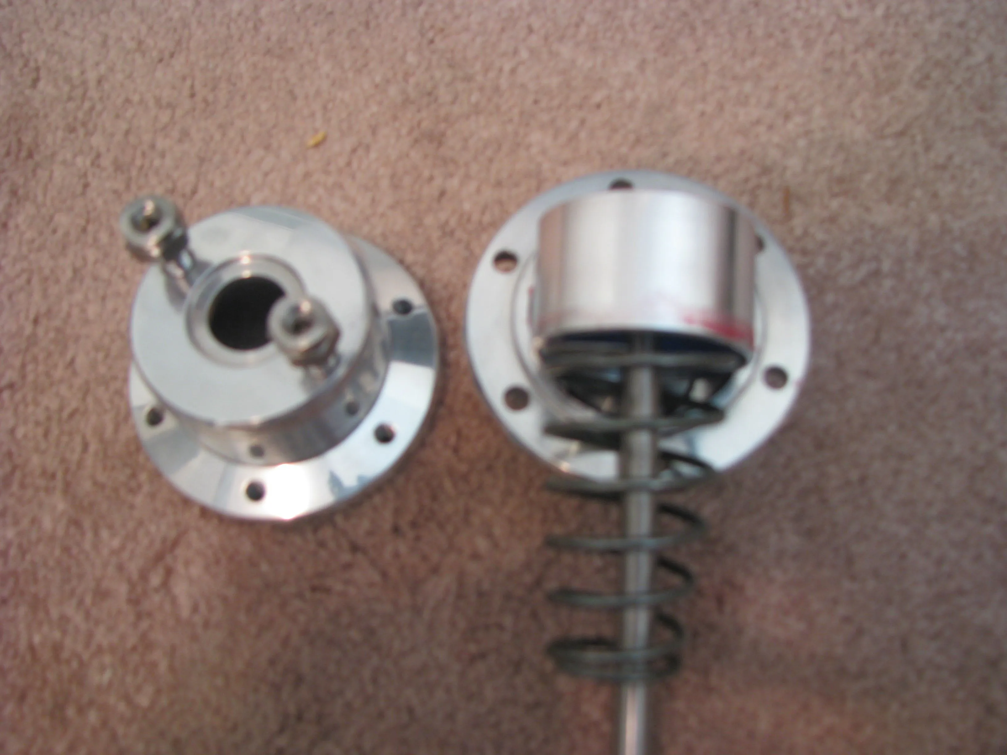

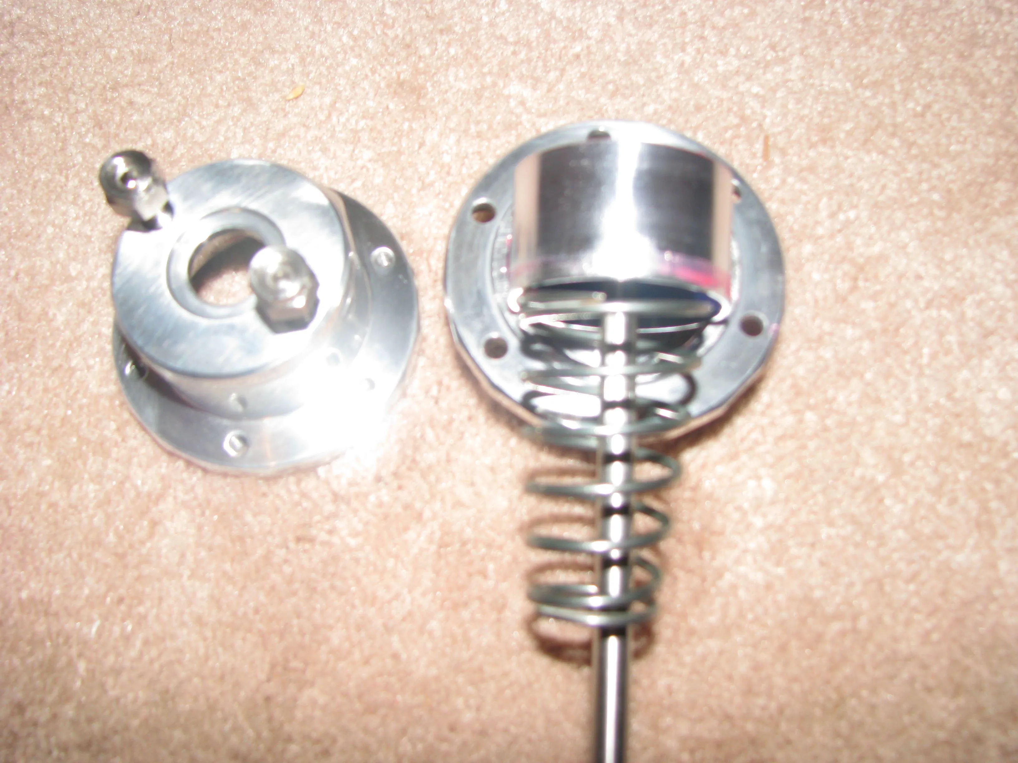

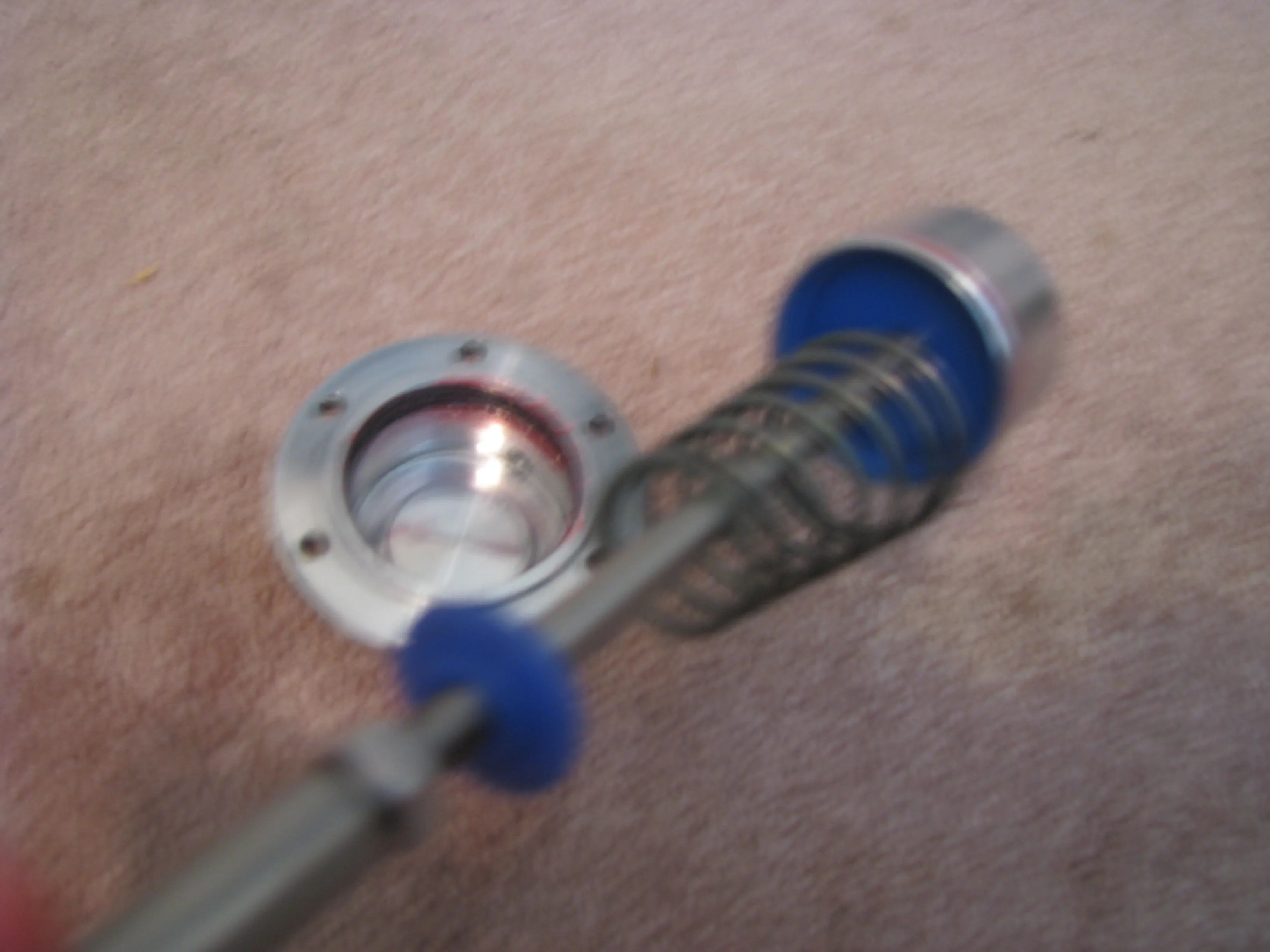

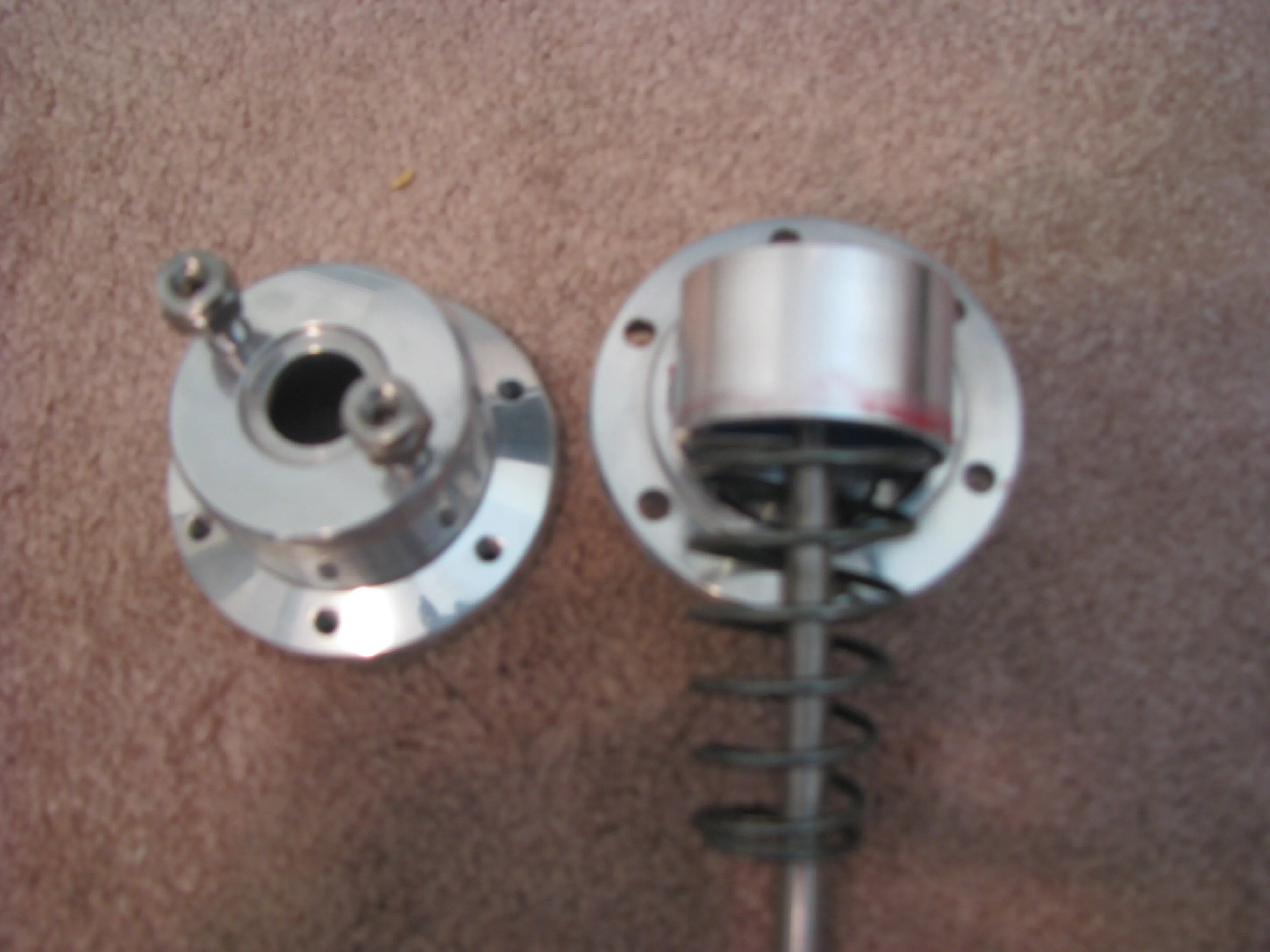

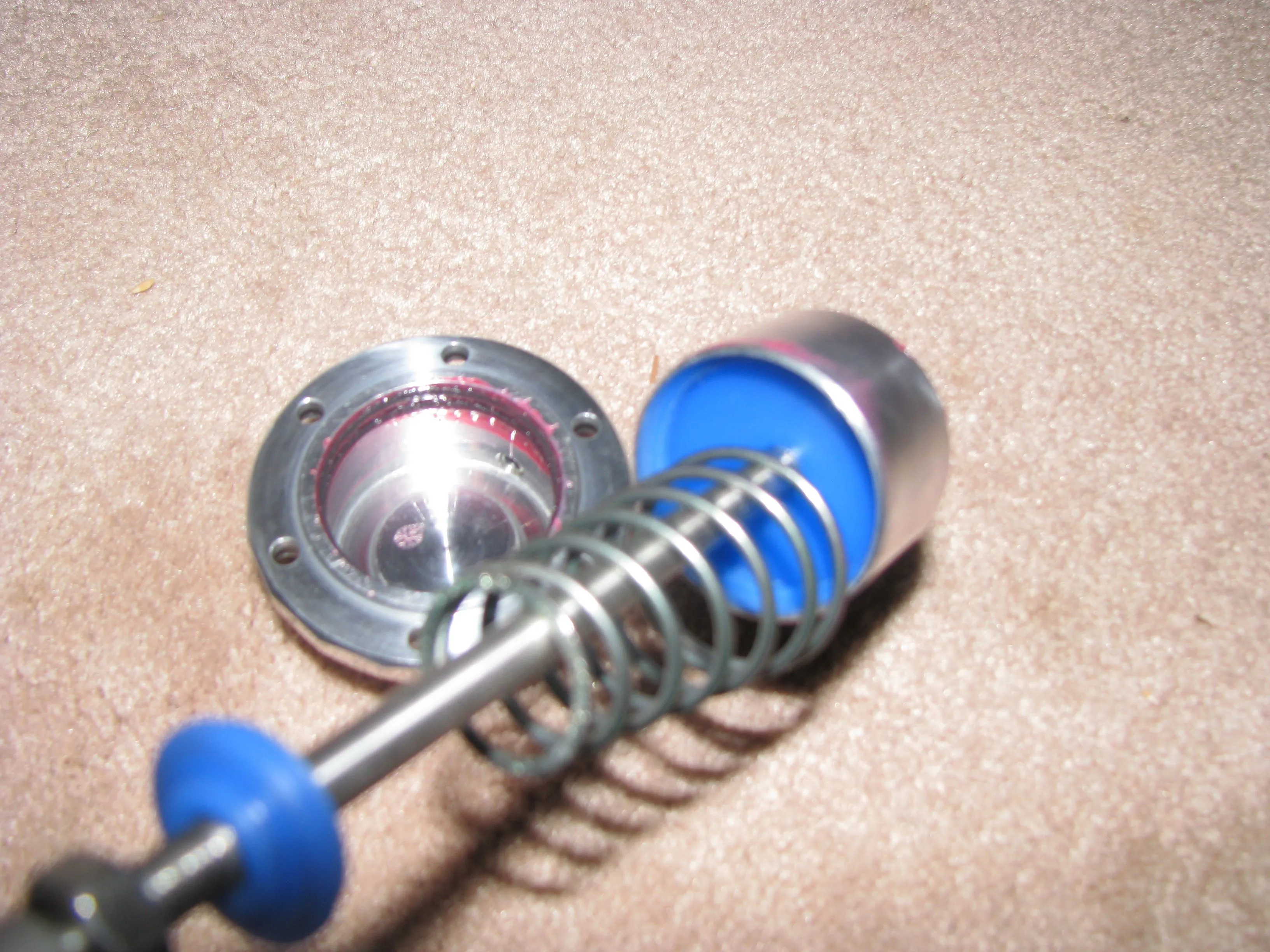

here are the pics. i have a green spring
For some reason I can't tell what's what. The green spring is the right one. But I think under that metal tip is the blue cap. It unscrews so you can remove the spring while still on the car. Non your your pics show it. Unless for some reason the metal cap over the blue plastic was removed. Either way that should unscrew so the spring comes off with the fatter end coming out first. when installing it onto the car you just don't screw that blue cap back on. Non of your pics show the spring removed
