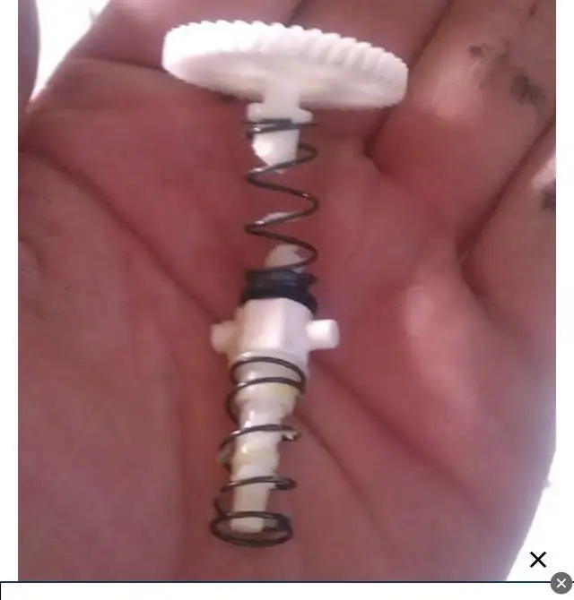

I am very new to the forum but am happy to have found you! I have a 2003 Protege 5 and need 2 of those stupid nylon cog gears for the door latch actuators. The motors work just fine. I hate to spend +/- $40 for each unit when all I need is that piece. I have looked online everywhere. The latest post I could find here was from 2019 but the link to Amazon doesn’t work.

My brother had two of these broken in the exact same way when he bought his Protege.
I came to the same conclusion after I took the old ones apart to see how they broke and wondered if I could just buy replacement gears or epoxy them, but couldn't find any options online and I don't know how well Epoxy would hold up. I did think about 3D printing replacements, but I doubt they'd hold up either.
I ended up going to the junkyard and getting two replacement actuators for like $20 total or something like that (didn't cost enough for me to remember exactly how much). $40 a piece is kind of stupid for what they actually are, but compared to prices for other cars, it's not too bad even if you just buy the whole assembly new.
Try car-part.com if you want to be double sure that your local yard has a Protege, or just walk in and ask. Sedan and Wagon actuators are the same, but keep in mind that there are two different actuator models used in the doors (I think it's A & B and they are just reversed symmetrically), so if you get the whole assembly, make sure to get the right ones unless you plan to just swap the gear only.

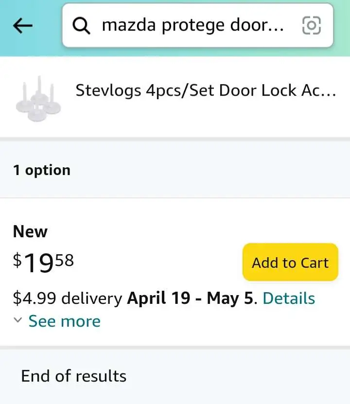

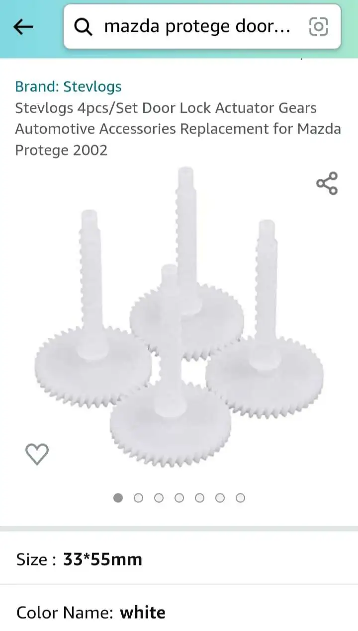

Thanks. I’m going to order off Amazon where someone found them and hope they work🤞🏻
Upvote 0
Well I couldn’t find that!!! Will check it out, thanks!

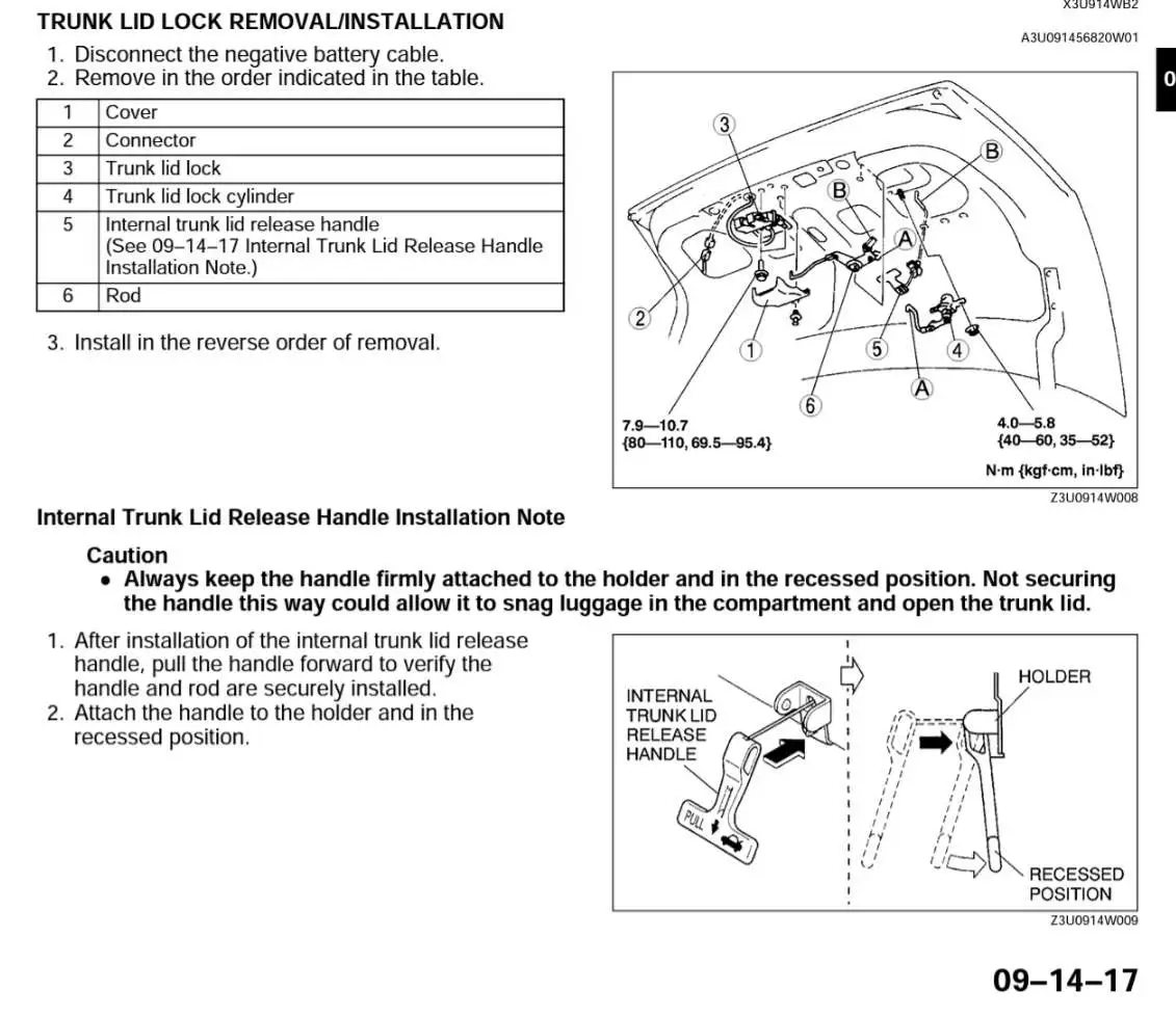

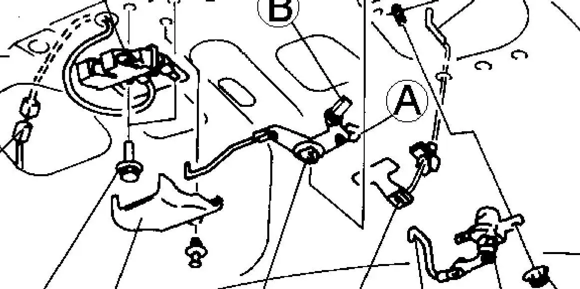

It's listed for the Protégé sedan and the Protégé5 has a fifth door lock actuator for the tailgate, but I don't know if the tailgate actuator uses the same gear or if the sedan has a door lock actuator for the trunk?
Upvote 0
,.. but I don't know if the sedan has a door lock actuator for the trunk?
It looks like the sedan doesn't have a door lock actuator.
It's got a release handle in the cab and an emergency release handle inside the trunk.
