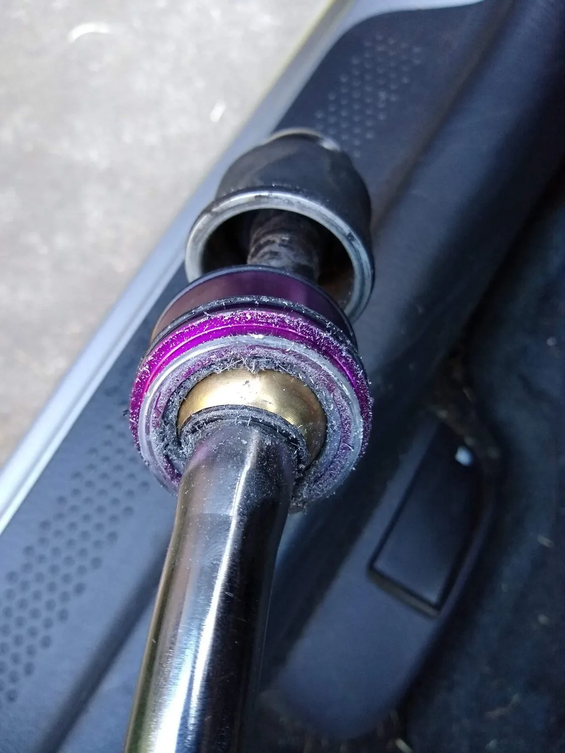

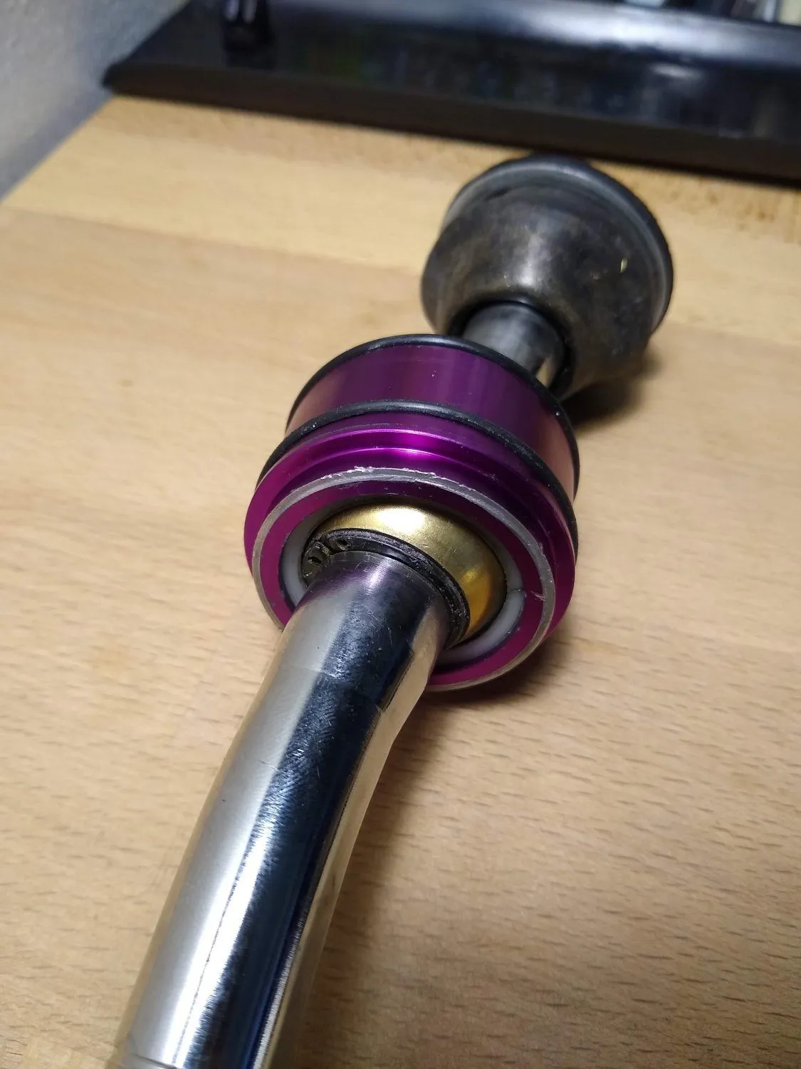

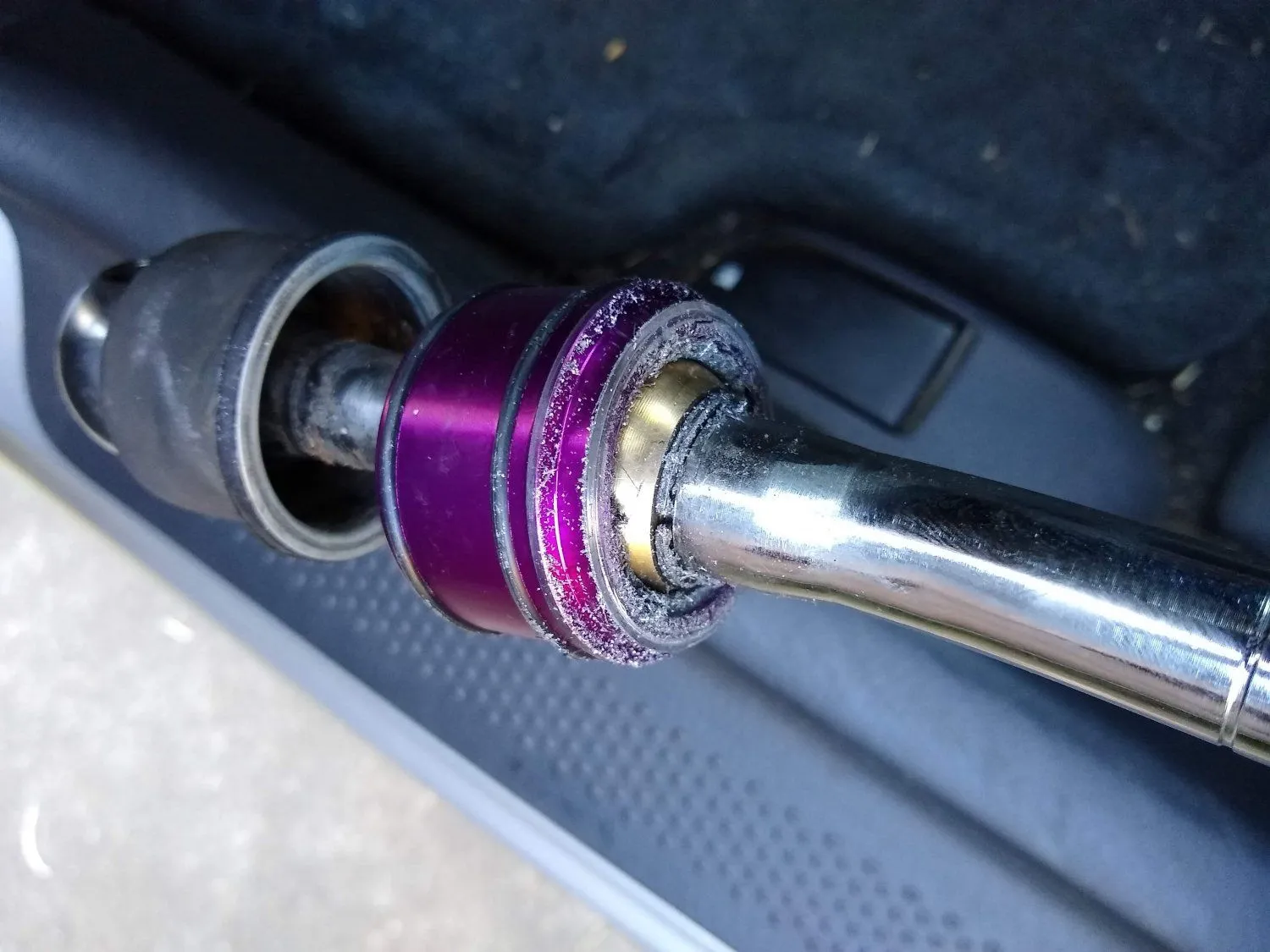

I took things apart this afternoon to investigate, and this is what I found:
...and after cleaning the metal shavings...
Soooo...that doesn't look particularly amazing. It looks to me like the snap ring has been rubbing or vibrating on the top of the shifter. Does anybody have thoughts on what's causing this and how I can fix the rattling and slop? I suppose I can file a warranty claim with Megan Racing, but this also doesn't help me much as I daily drive my car and can't just ship them the old shifter without having another one to install. I'd also like to understand and fix the underlying issue instead of trying to fix what it causes.

Eeeeeek, that's probably not meant to look like that
Definitely send Megan Racing an email and let them know about it. Even if they can't fix it the feedback is always good
Did the kit come with any grease or lube? Packing it full of grease might help with the slop and rattle

I'll try that and see what I find. I think the metal shavings were coming from the top snap ring rubbing on the shifter bushing holder thing. Not sure how one would fix that though.

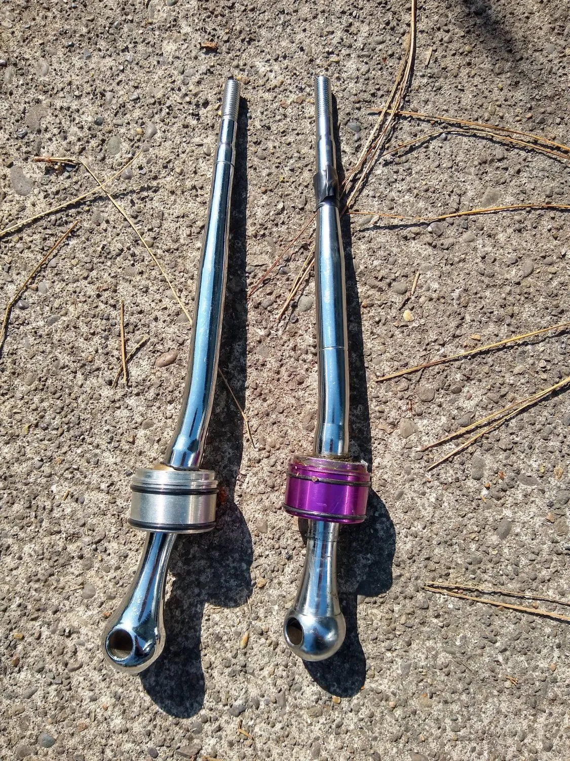

I'm just gonna casually update this for continuity's sake and because a few things have happened...
It took a few months of back and forth emails but I finally got a full refund for the shifter, no questions asked. I bought it off eBay through CircuitSpecR, so I had to contact both them and Megan Racing. I'm happy with the end result but also a bit annoyed that it took so long for them to even notice me. Anyways...
I had a problem to fix and money to spend! But, instead of buying something high quality, I decided to be lazy and take a risk by buying the cheapest no-name Protege short-shifter on eBay!! I paid a whopping $33 shipped, aaaannnnnnd...it's better than my Megan Racing SS. Now, I've heard good things about the Megan Racing SS, so I'm almost assuming mine was a dud, but it's still the product they sent me. Anyways, 90% of my rattling and slop have been eliminated by the proper tolerances in the cheapo shifter.
Side-by-side, the two shifters have differences in design, but are the same length and generally of the same design. No shift knob, branding or retail packaging with the eBay model but that doesn't matter to me.
I don't usually like to buy cheap knockoff junk on eBay, since the brand-name quality parts usually last in the long run, but I think this is an exception.
I'll just have to see how it hold up to the test of time. And now I have an extra Megan Racing short-shifter if anybody wants it! 10/10 excellent condition no issues no lowballs I know what I have.

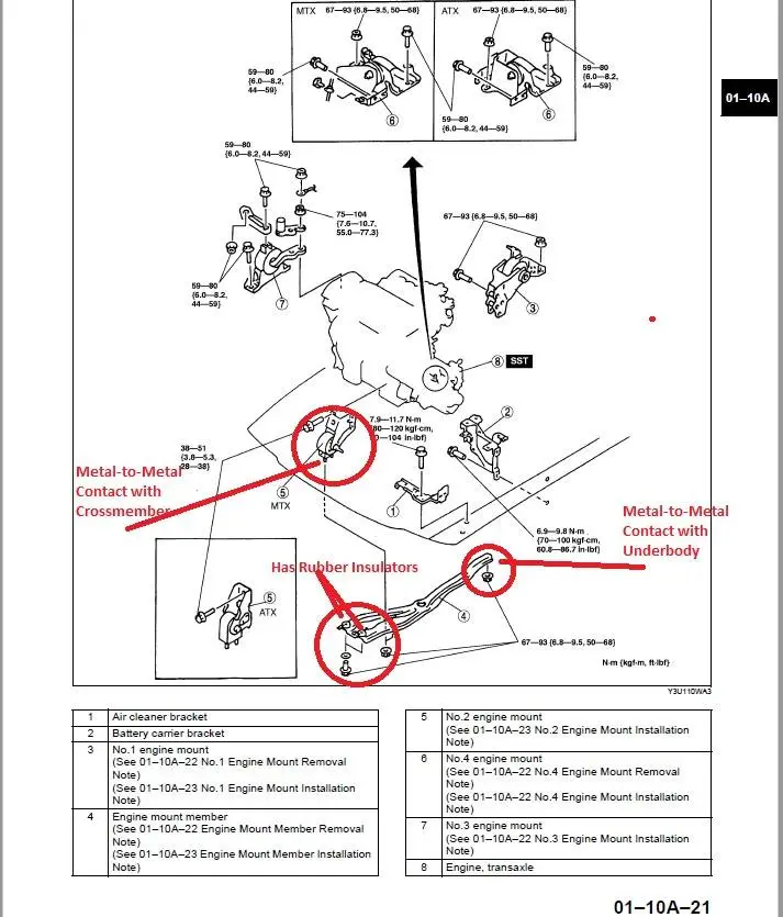

I had previously tried to insulate the engine/transmission crossmember (figure - below) from making metal to metal contact by wedging a hard piece of 3/16" vinyl matting scrap between the engine/crossmember but still not completely happy with that and would rather have an air gap or softer cushioning material installed there if possible.
It's likely over time, the engine crossmember has been used to raise the front end of the car while jacking on it and may have made reduced the engine clearance with that support.
When last under the engine I decided I will see if I can reduce any drivetrain to body vibration that may be coming from that area there by increasing the crossmember to engine/transmission gap there by:
---1- Putting some kind of rubber vibration damper between that crossmember and the underbody where it bolts up (especially in the rear-see illustration below).
(That rear single bolt mounting point seems very suspect to me as the front 2 bolts have engineered rubber insulators installed in/between the crossmember and the rear mounting bolt and crossmember surface does not = metal-to-metal body contact.)
---2- Loosening the front motor mount and installing a spacer UNDER the metal-to-metal motor mount base and the metal crossmember it mounts to.
A metal spacer will add some more clearance between the engine and the crossmember at the lowest point while a rubber spacer would possibly dampen vibrations with either or both options only raising the front of the engine only slightly.
I've got to raise the car again later this week to do other maintenance - install missing anti-rattle front brake clips and retainers (all 4 wheel calipers were missing them) as well as replacing the "new" aftermarket clutch master cylinder (that leaks at the top where the hose plugs in) with the original OEM one that never did.
