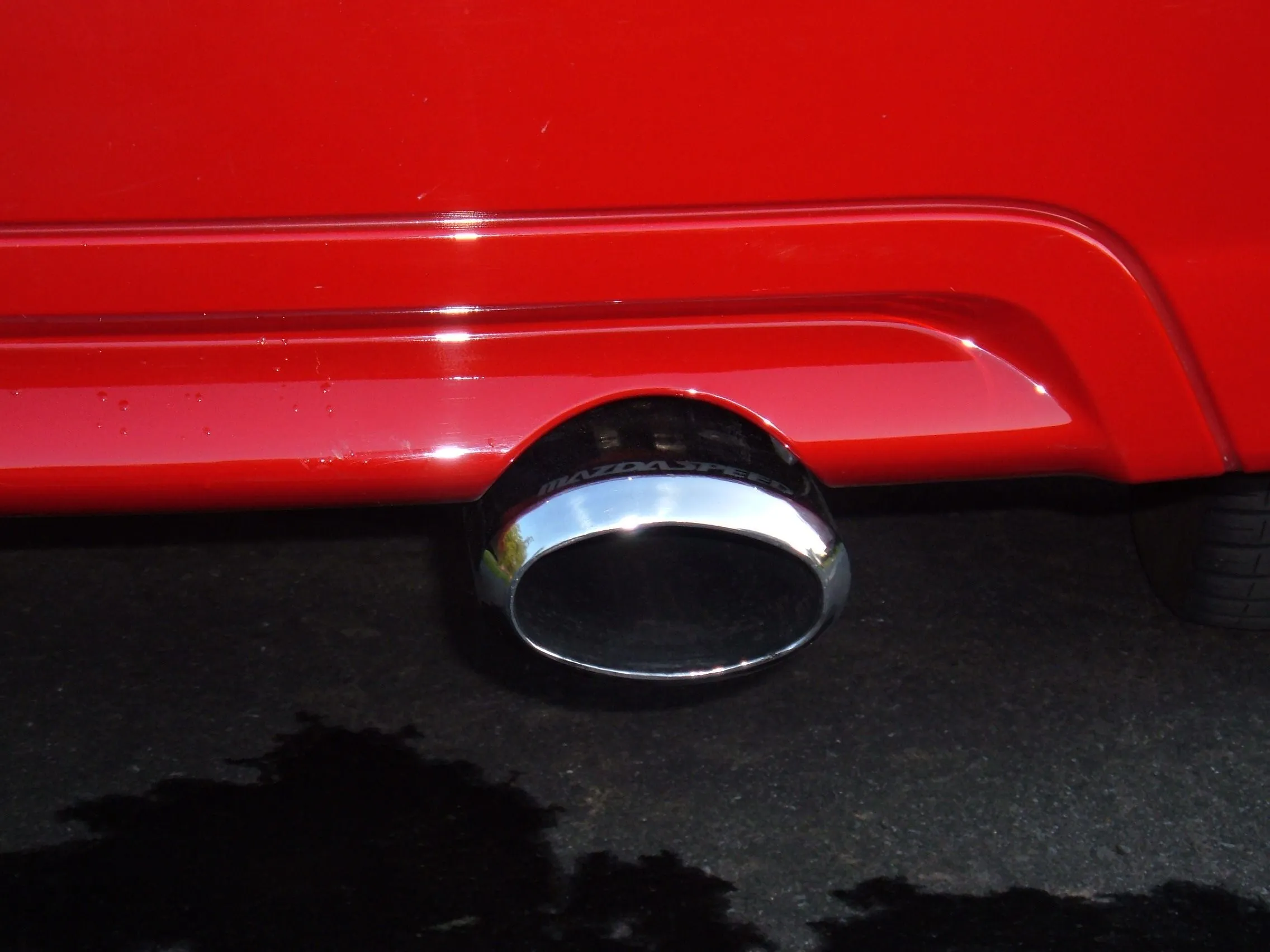

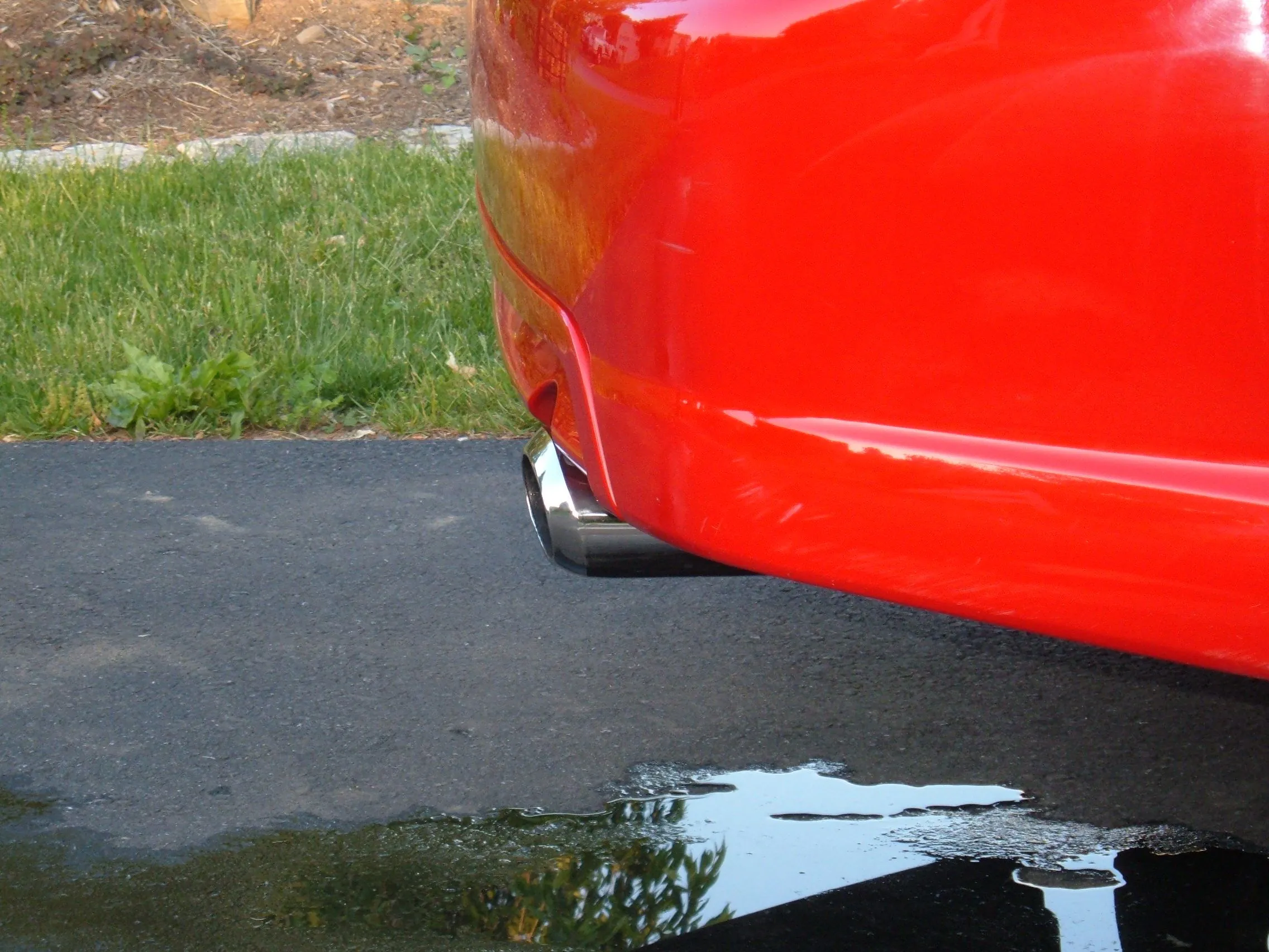

Oh it will drive just fine but the tip will stick out a good 4" past your bumper. Just be careful when backing up, parallel parking and walking behind the car so you don't burn your legs! Here's a couple pics of my former 03.5 (I bought it used pre-cut for the P5).
attachment.php
attachment.php

I'm thinking the same. And to clear up any confusion, the MS exhaust made for the P5 and sold by the dealer was made by Bosal whereas the MSP specific exhaust was made by Racing Beat.
