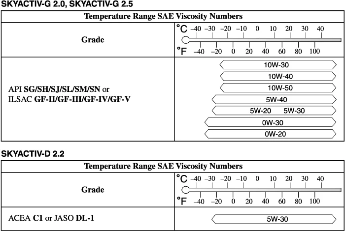

Mazda responds 5w-30
Agreed, it’s not even a suggestion. It’s in black and white that the manufacturer says it’s fine for the application presented. Pick a viscosity applicable for your use case out of your vehicle manual and I don’t foresee issues : )
We’re going to have folks in 10-15 years that are very happy our vehicles didn’t suffer an oil related failure. The two camps for the 2.5 NA will point to either the 0w-20 on the cap or the worldwide 5w-30, and there will be much rejoicing.

I think when driven normally, 0w20 should be fine. But, if you're pushing the engine with high loads in hot weather, its not.
Show us the chart, please
