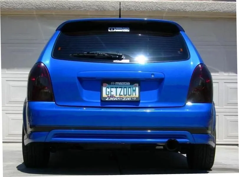

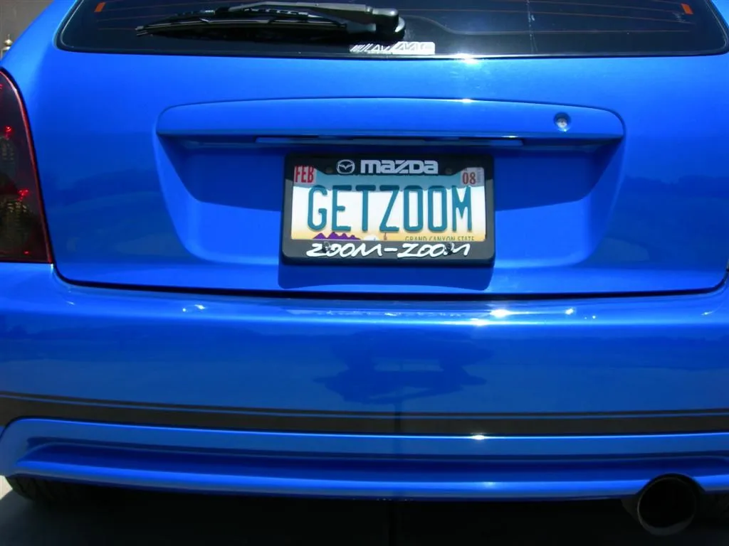

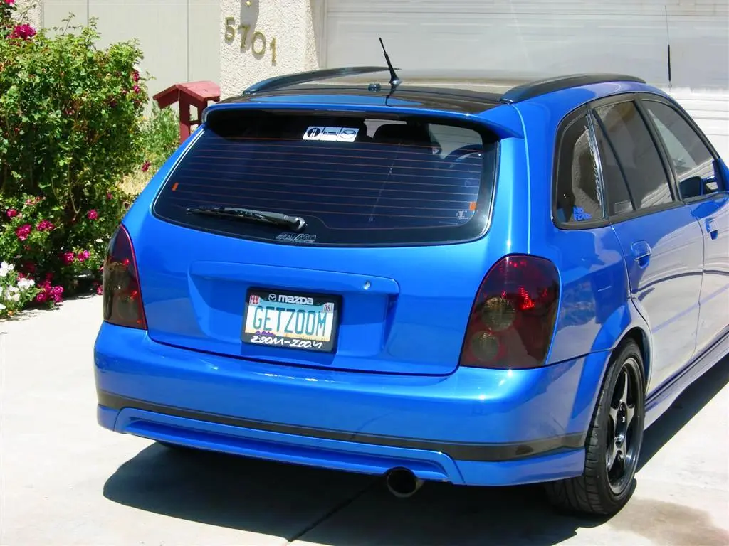

You would have to weld the holes closed then grind off the excess. Get it smooth before painting.

dsfah
hey thanks rednecks i'll prob see whats up wit my guys and prob do that in the far future when i get my other stuff done
but that helps alot and thanks dude
btw ur car look real clean
