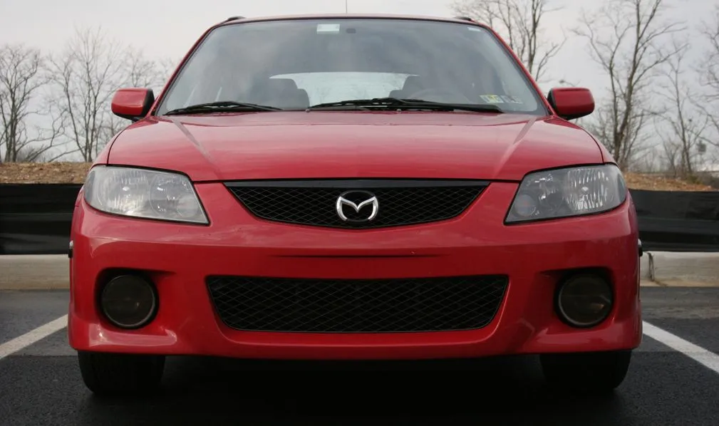

I pulled the front grill off the car to paint my front emblem....which is easy to do. Here is how I painted mine for a 'custom' look or you could use a dremel to cut off the areas I painted black.
I did this with a dremel and some black paint. I have one for the rear hatch as well, but I'm waiting to shave the back and fix the rust before i install it.
