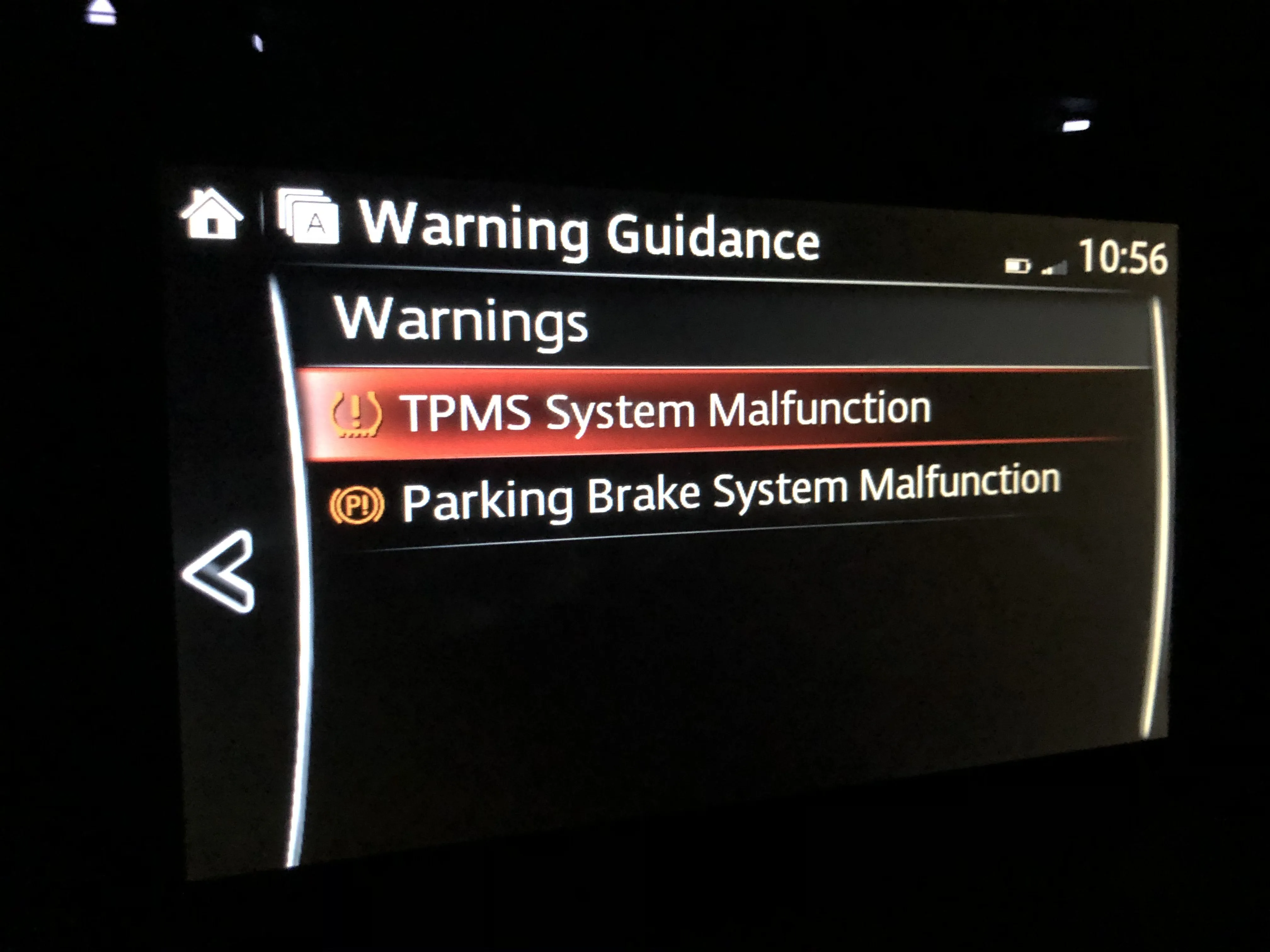

I replaced the battery in my 2016 CX-5 yesterday. After installing it, i got two new maintenance codes, TPMS System Malfunction, and Parking Brake Malfunction, along with the corresponding warning lights. Is there any way to make these codes go away, short of paying my Mazda dealer to do so? (the TPMS won't reset using the button on the dash, as would normally happen when refilling the tires.)

Yes, I tried, but there was nothing i could do in the maint screen but read the malfunction messages.

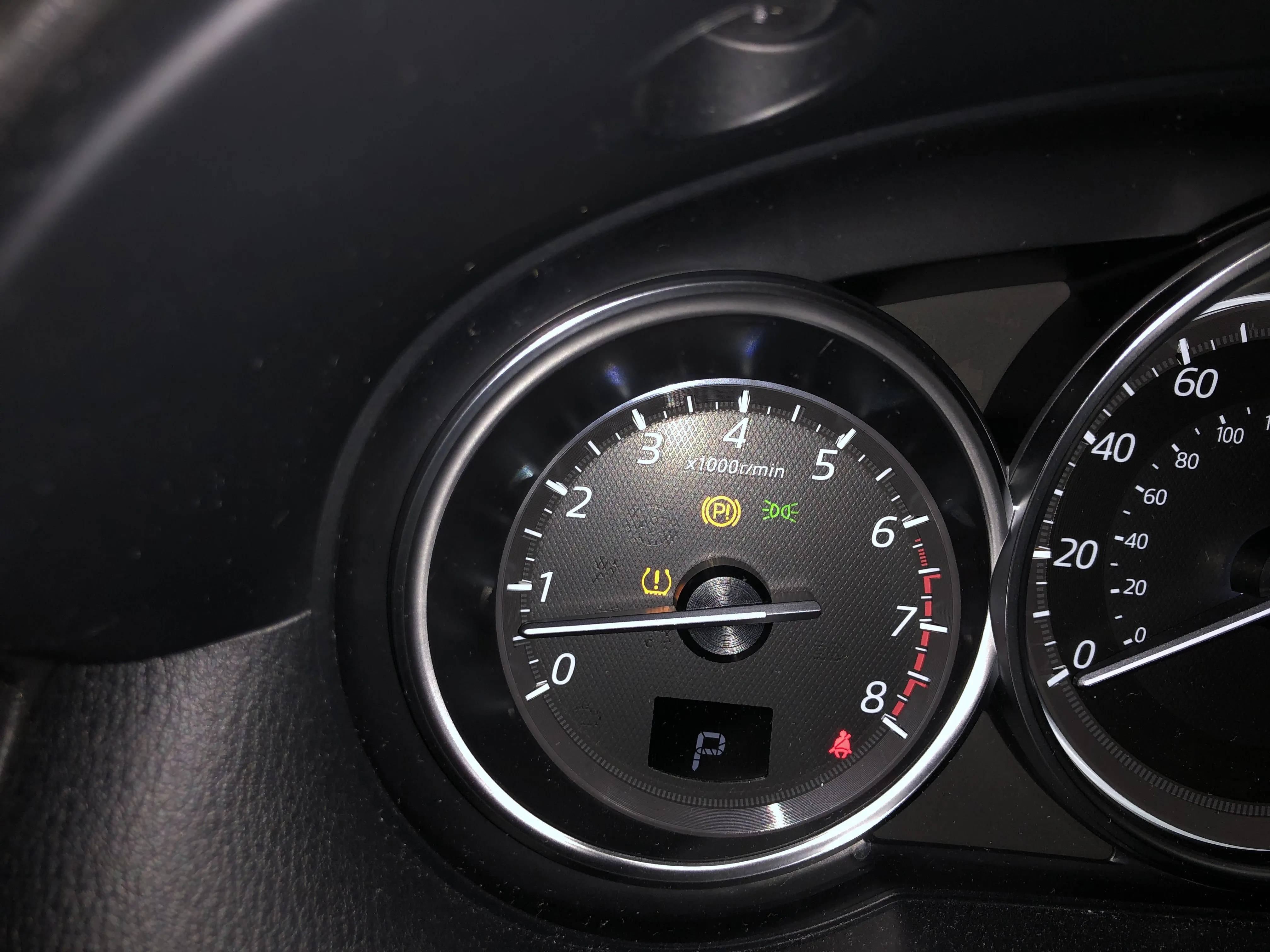

Bump. I have the exact same issue as the OP after a battery replacement that I did myself. I've tried removing the battery, letting it sit overnight then reinstalling it, removing the room fuse for a few hours and reinstalling, reinstalling the original battery. Nothing makes the TPMS System Malfunction, and Electronic Parking Brake Malfunction lights/warnings go away. EPB works just fine. Just the warnings and lights. Frustrating.
Anyone? Please?

Well...finally was able to put the car into EPB maintenance mode and out. Did nothing. EPB light still on and TPMS still flashing.
Frustrating...
