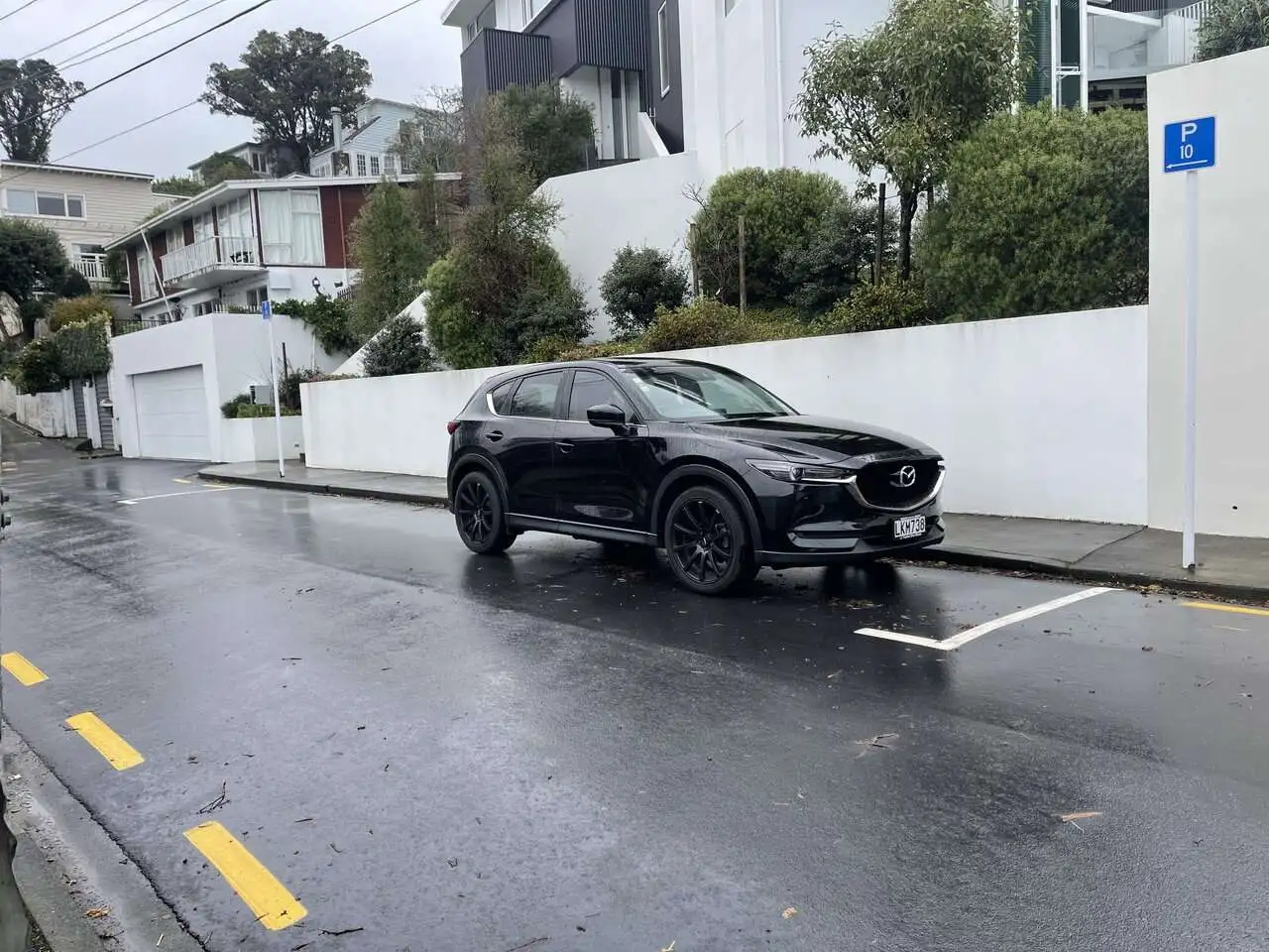

With constant wet weather this is the best shot I could get of my little car lately. I haven't done much to it aside from get an ECU update from Mazda to try and fix my CEL issue. (from installing a SRI) I had to change the airbox back to stock to get them to do it so haven't got around to trying the SRI again with the new software. I have bought a SRI and 'Boost Tube' for my CX9 too so will install these soon.
The CX5 just isn't the same without the SRI, I don't care if I keep getting CEL's, I will put it back on as it gives it just that bit more power and torque and makes it a lot more fun to drive.
I think I will try get rid of the CEL via an aftermarket tuner if it comes back again.
