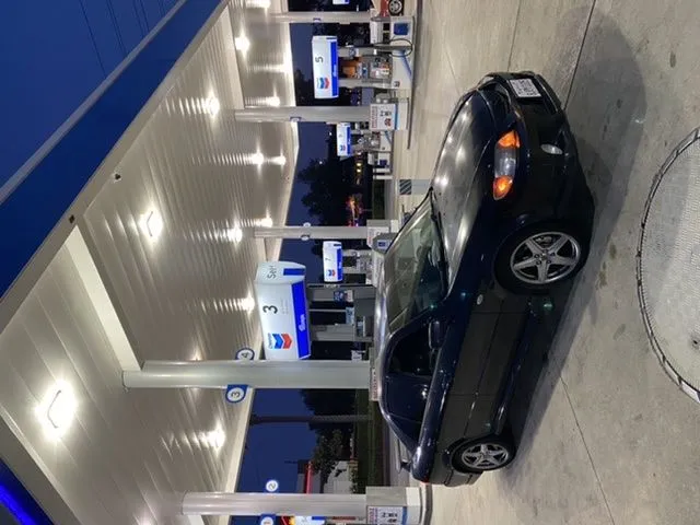

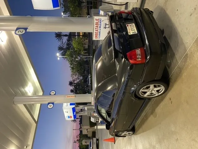

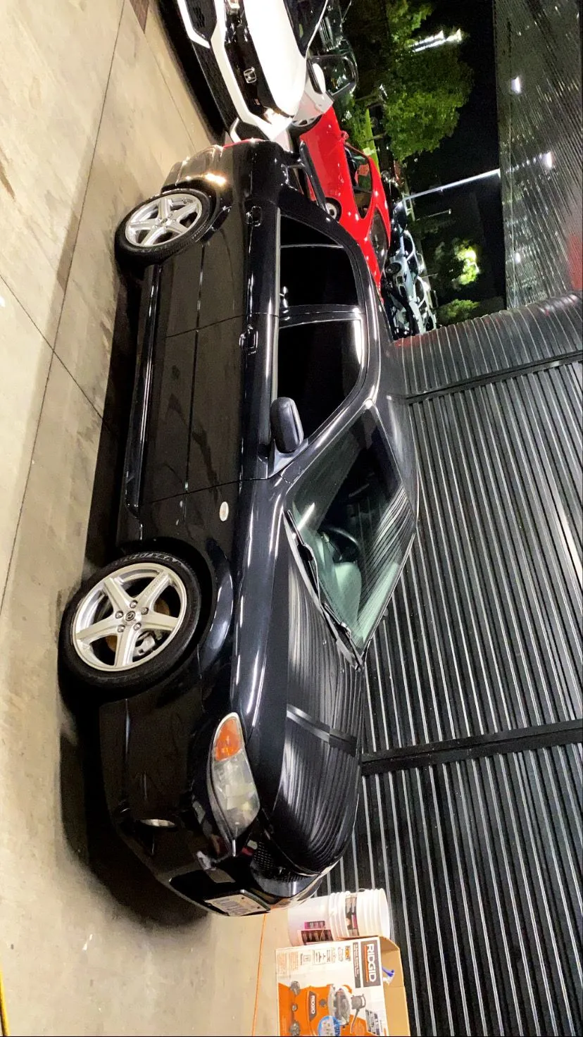

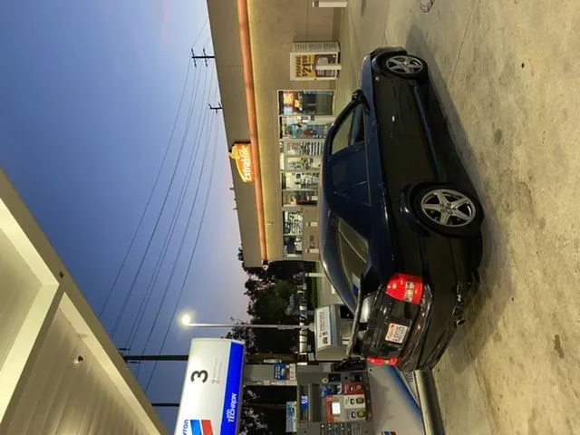

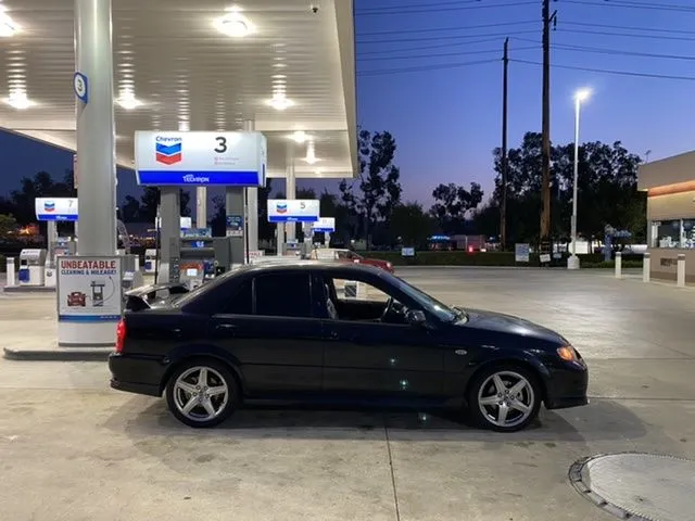

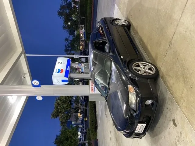

Thank you all for reading. BUT FIRST... PAINT CORRECTION (A kid at my dealer brought her back to life) Pics of when I bought it and after he cut and polished it.
