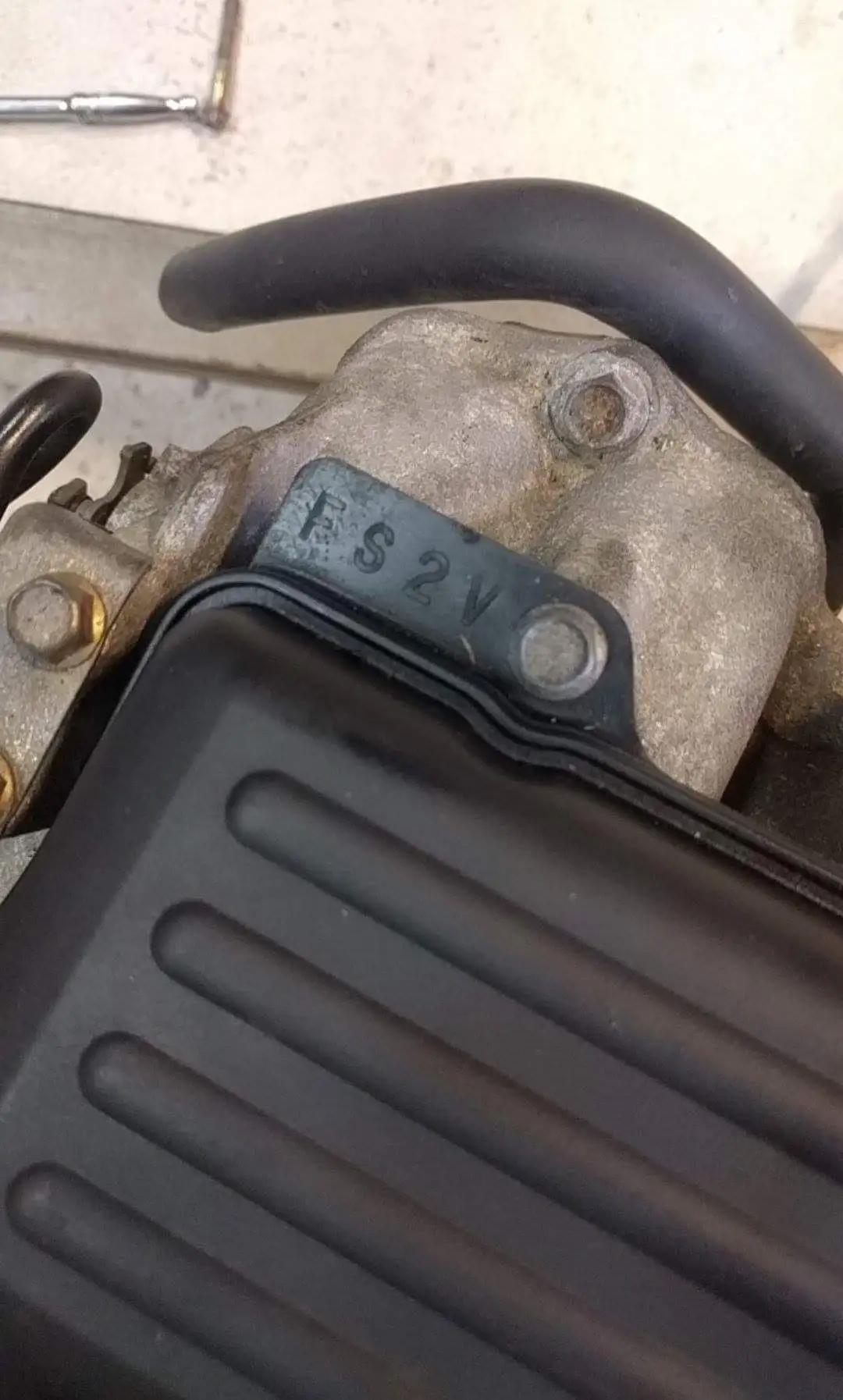

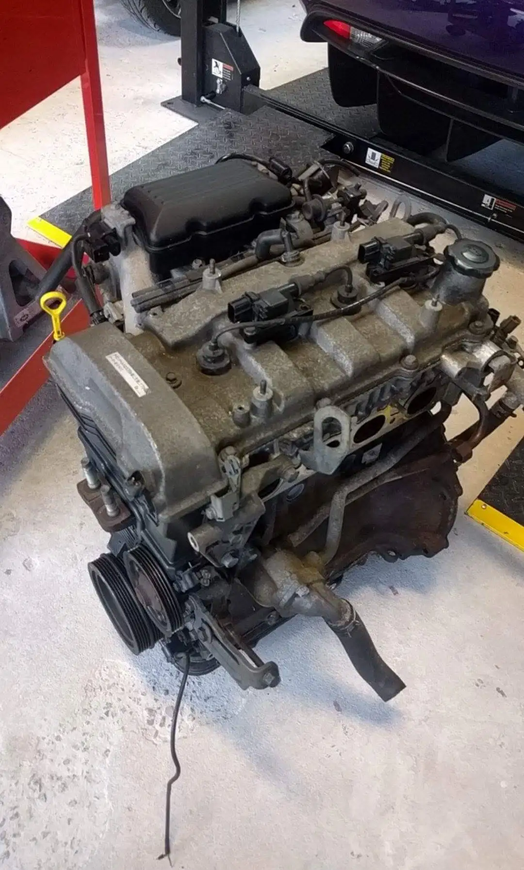

We have acquired a real JDM FSZE engine and are tearing it down and going through it before dropping it in our race car. Will post pics as we go. Enjoy

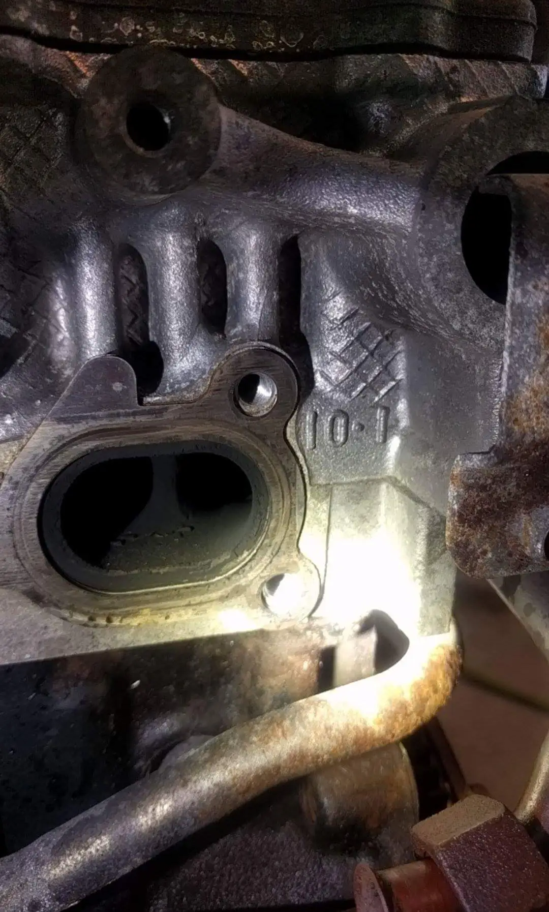

Done with the bottom we flipped the shortblock over and started on the topside. New headgasket after cleaning all the surfaces. Note the pistons ;) The head is also marked 10.1 ;)

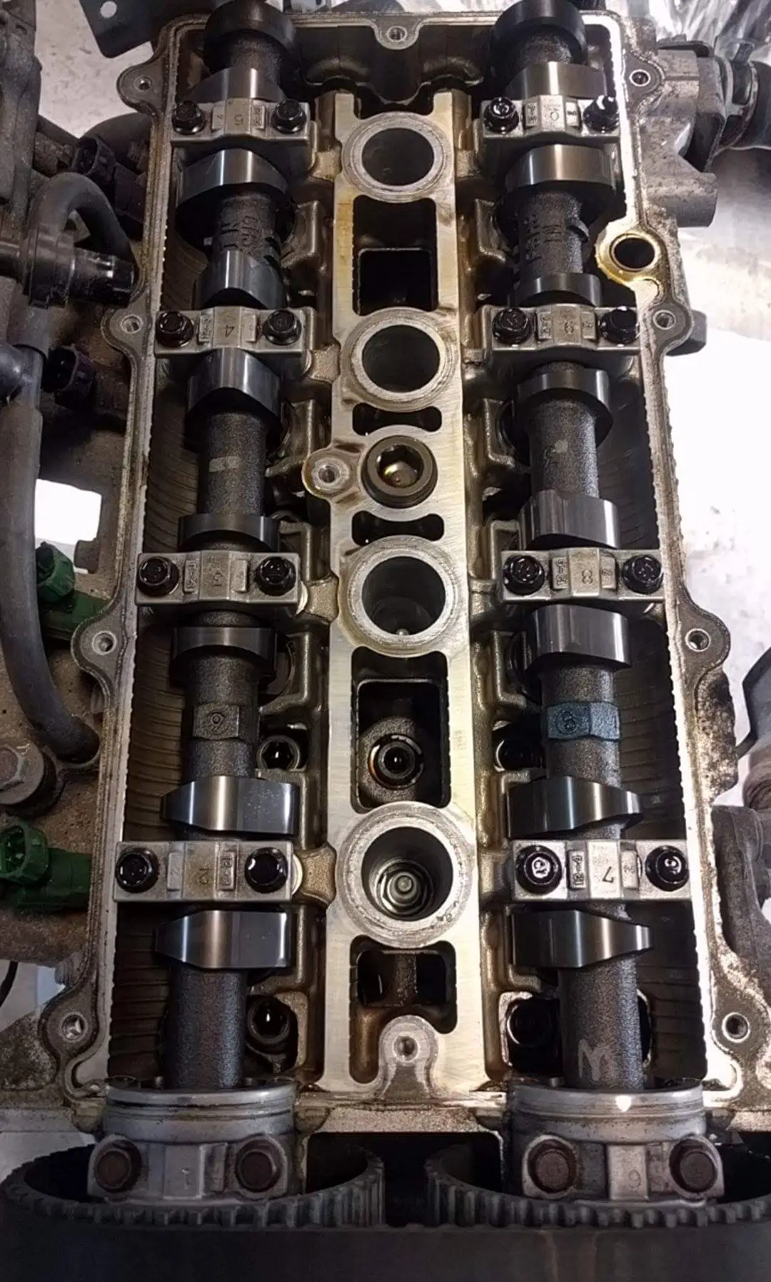

We pulled the dowls out of the head and put them into the block before lining the head up. They can be smashed all the way into the head and you don't even know they are there. This prevents correct alignment if the dowls don't get aligned correctly. After torquing the head down in 3 different steps it was on to the cams and cam gears. One interesting thing on this JDM motor was that BOTH cams are FSH9 intake cams just orientated differently. We did a double take on this when we first took it apart.

Interesting, my Fs-ze has 19.1 on the head near the exhaust port where yours has 10.1, Different casting run maybe?
Should be 10.1 or 9.1. 10.1 on the ZE stuff and 9.1 on the DE stuff. Both the block and head on ours has 10.1 19.1 might indicate the revised 9.1 head, not sure.
Does the exhaust cam say EX on it? Did you do the main bearings and thrust washers when you were in there for the rod bearings?

No, the cam says IN on it. We didn't do the mains or thrust washers based on the condition of everything else which was really good. In road racing the rod bearings will go before anything. We will run these a couple of races and then pull and check them.

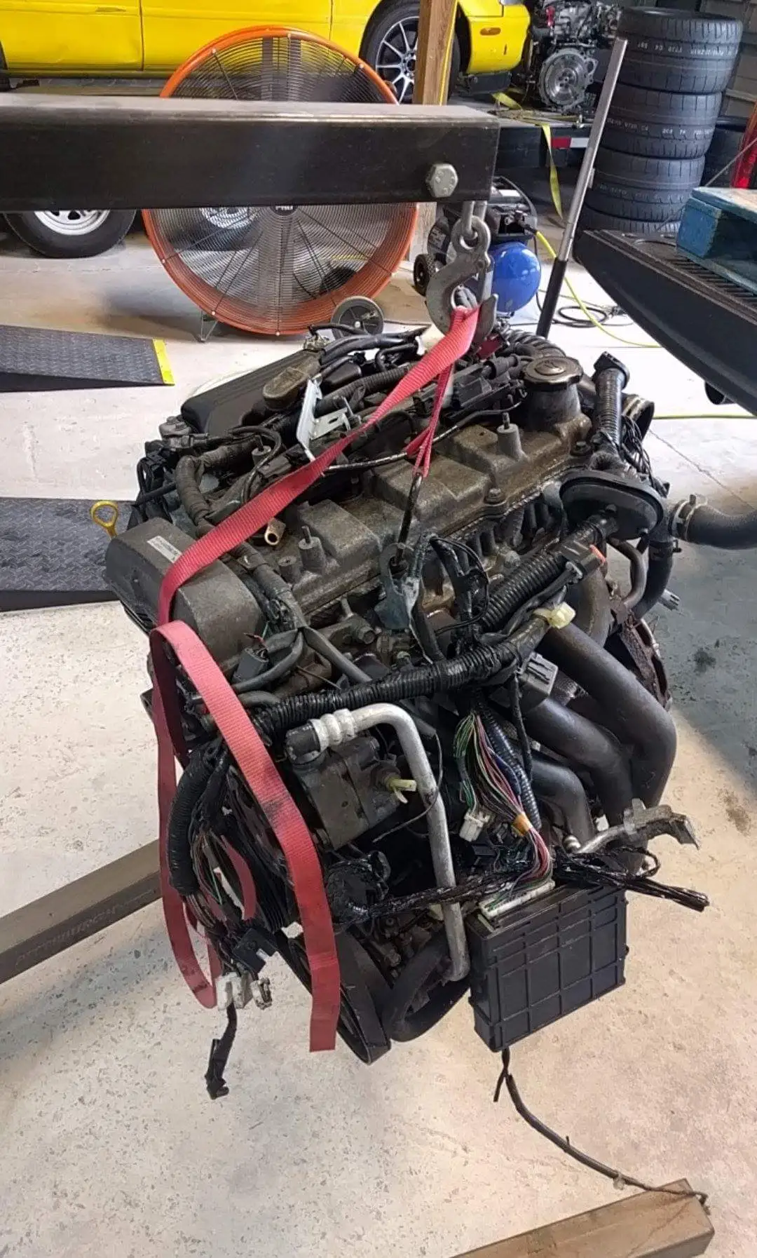

Test fit the ignition system and the header. Waiting on gasket. Should have the motor in the car this upcoming weekend. Believe we are going to go with the ZE intake that came on this engine. Not sure if we are going to delete the VICS yet or not though. Any suggestions?
