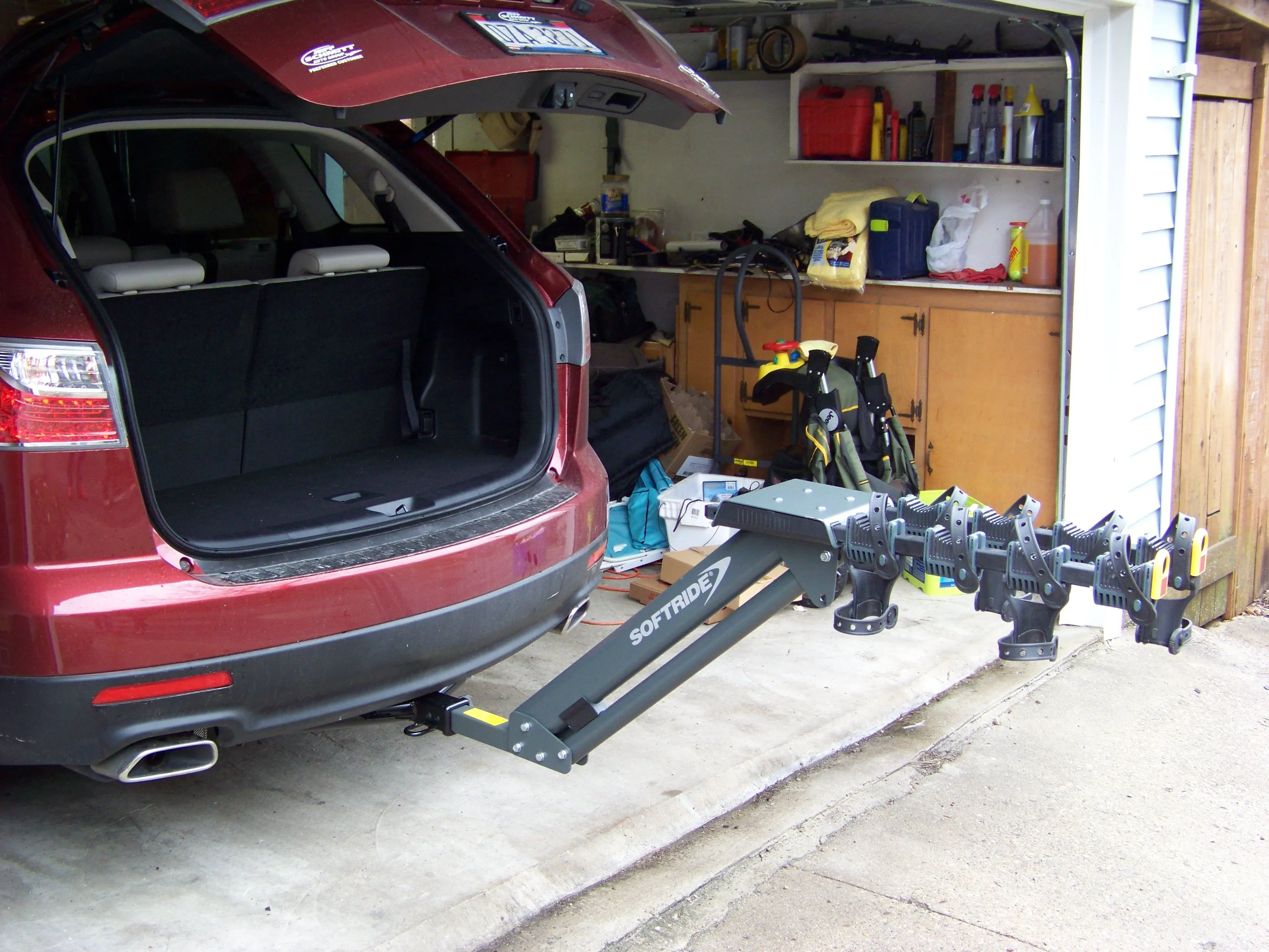

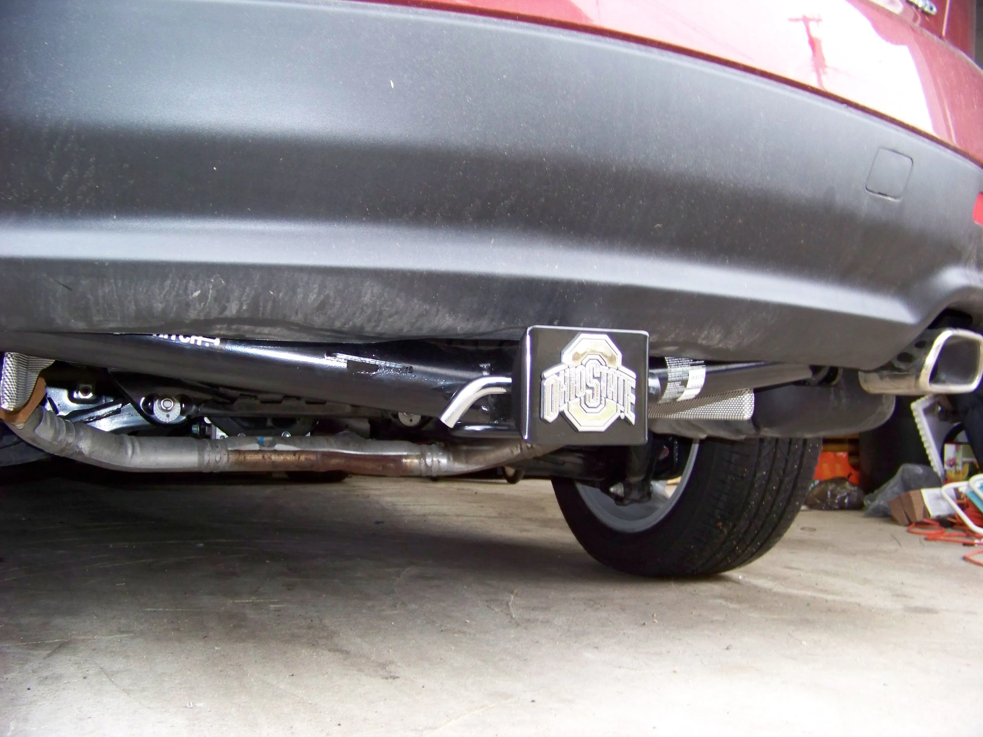

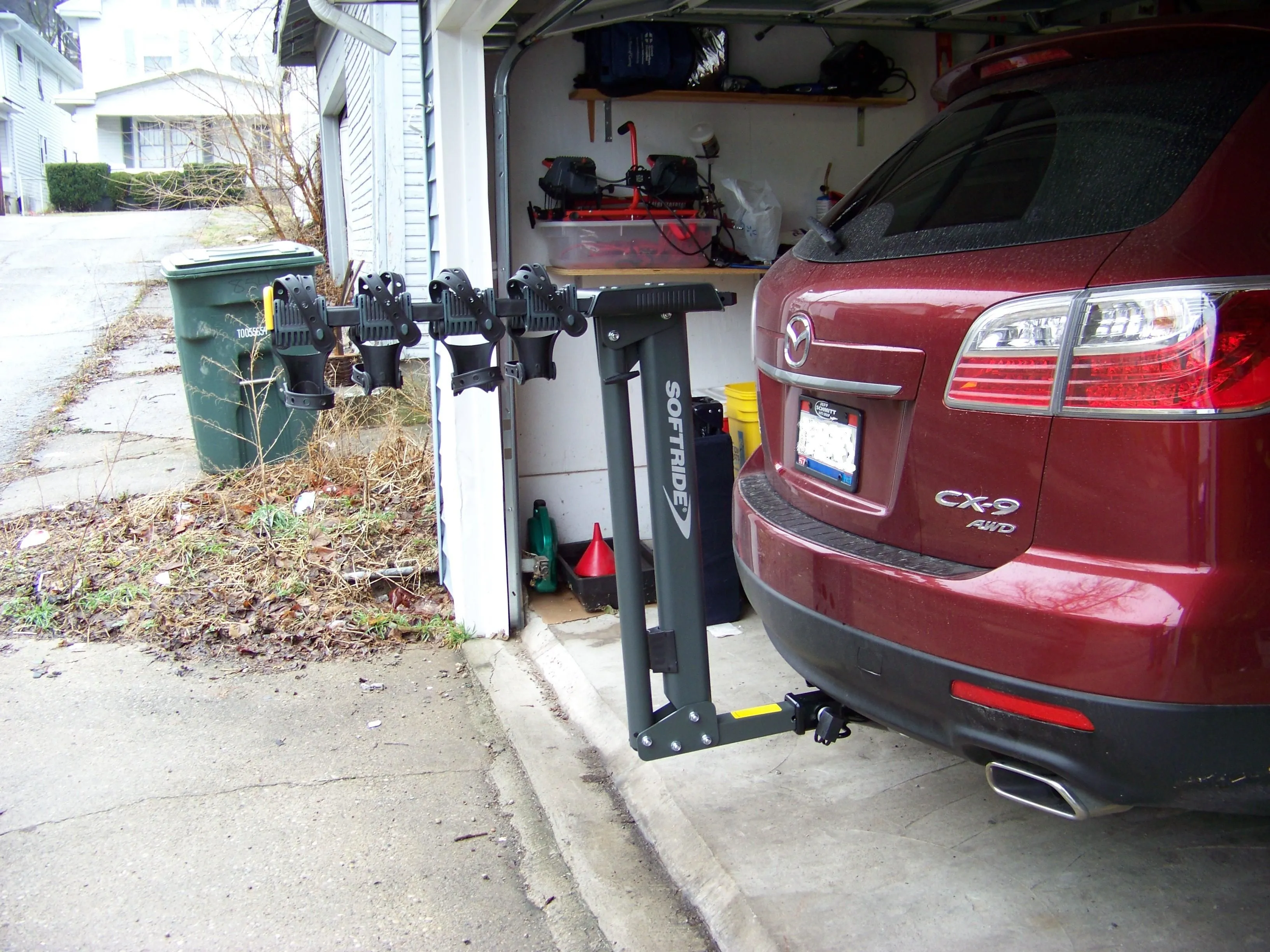

I put my Hidden Hitch on the truck today. And I put my Softride bike rack together. Can't wait to go on a bike ride once the rain stops and the weather warms up.

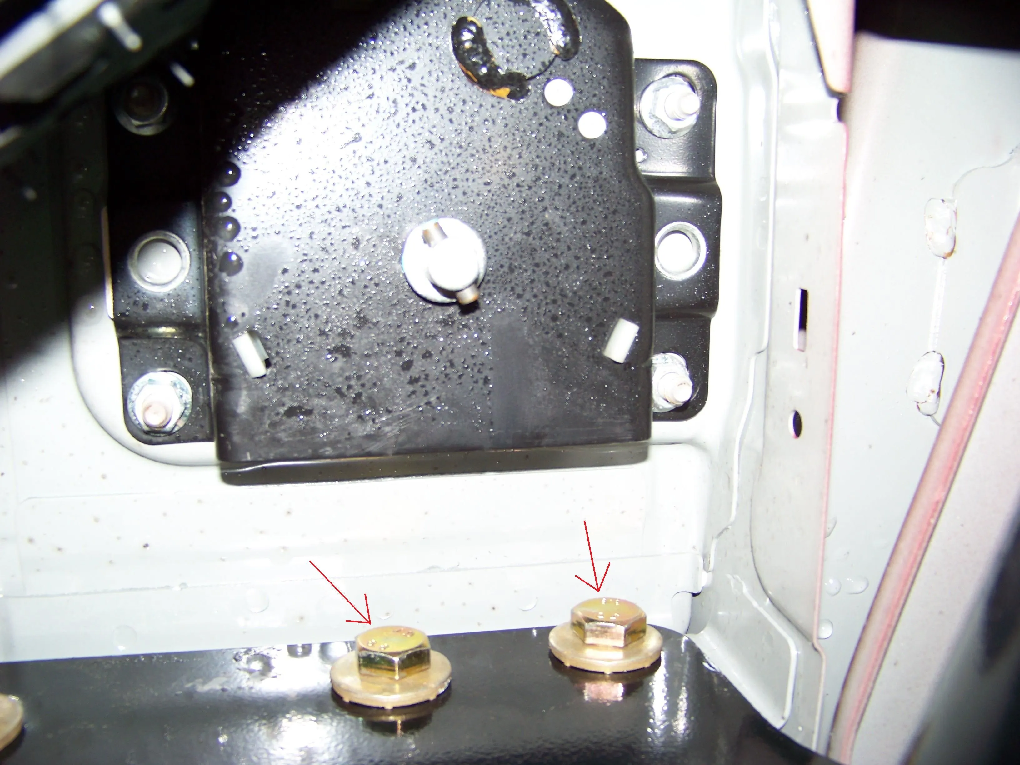

I have a question for anyone who has put a hitch on themselves. If you look at the picture of under the frame where the mounting bolts are, you see I drew an arrow to 2 of the bolts. These are the middle and farthest to the back bolts on the passenger side. How did you get a torque wrench with a socket on there to tighten it up? I am using the shortest 19mm socket I can find and I am about 1/4" to long and the box under there prevents me from getting the socket on there. I had to use a wrench to get the bolts on. If nothing else, I am going to cut a socket down to be able to get the torque wrench on there, but I would rather not to.
Any suggestions?

You are not alone.
The socket of my torque wrench is too long also.
I used a regular wrench to tigthen it as much as I can.
It is OK for me since it is only for bike rack, not towing.
I have Hidden Hitch also. Great pictures. Thanks for sharing.
I installed my CX-9 hitch myself, and in order for me to use a torque wrench, I had to loosen the screws of that black module thingy so I can move it out of the way. It was still a tight fit, but it did work. Looks good, good luck.
Thanks. I thought about that, but don't you have to loosen those from the inside of the vehicle? How much of a PTA is it to get to them? 4 of the 6 bolts are tightened to spec, and the other 2 I got as tight as I could with a wrench, so I am not to worried. I don't plan on hauling anything beyond the bike rack. If I feel the need to get those last 2, I'll just shorten the depth of a socket and do it that way.
I was impressed with how easy it was to install the hitch. Took me and my dad about 20 minutes to put it up. Bike rack took 15 minutes to put together.
Any suggestions?

I just installed my new Class III Hidden Hitch last evening and had the same issue. Once I tightened it down a little with an open ended wrench though, I was able to get my torque wrench in the space between the spare tire crank module and "frame." I was so pleased with the ease of installation of this hitch-this is how things should always work. I'm also pleased with the way the unit looks. I was surprised to see how concealed it is. Now, I just need to purchase wire harness and re-read postings on this site for trailer wiring.

I recommend getting someone to help you when you do it, makes things easier. I tried it by myself using a jack stand, and the hitch is a little heavy to try and balance while manuevering it into place. If you don't have a bike rack yet, I really recommend the Softride rack, also from etrailer.com. It is a little more pricey compared to some basic ones, but it works great. Especially when getting into the back hatch when you have bikes on the rack. We have a Burley bike trailer for our boys and it's easy to get into the hatch without the bikes laying on the ground.
