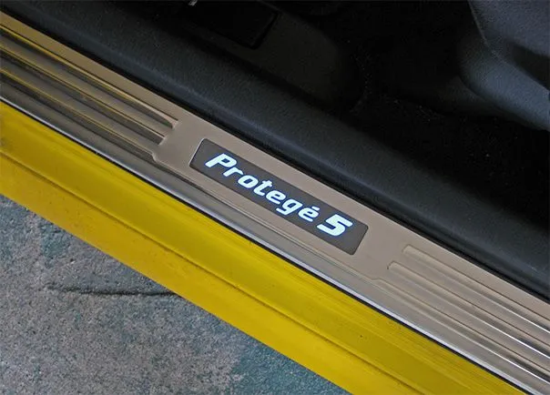

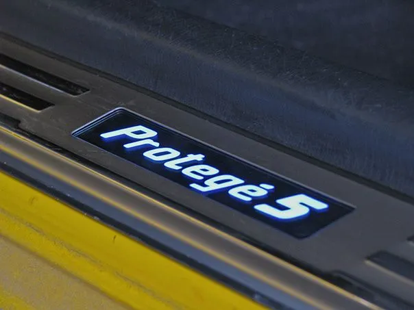

Oh yeah for sure, here you go. Forgot to clean them before I took the pics! lol.
