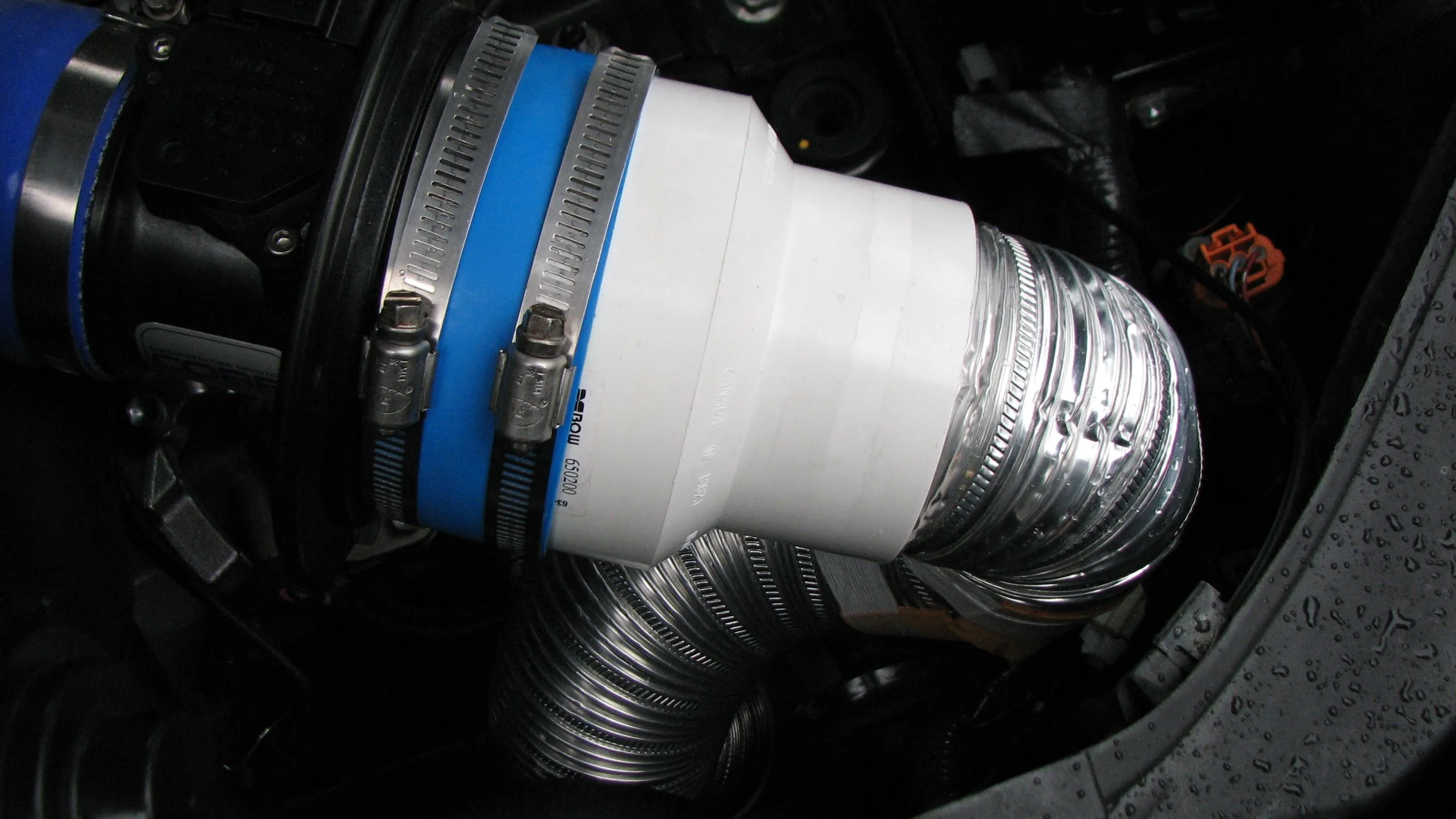

Homemade CAI!
I just wanted to try the Cobb as CAI before I bought the AEM.

I've seen guys cut the stock MAF meter housing from the stock airbox and mount a conical on the end if it. You could do that along with an aftermarket elbow, but for all that work, you can just spend $150 with PG and have the whole setup. Keep your stock parts for when you sell the car, and sell the SRI here in the marketplace some day.
