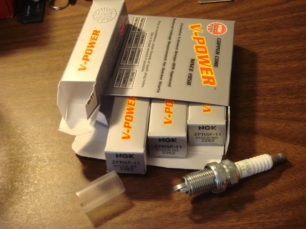

It doesn't seem like the long reach ones I bought have the crush washer on them. Am I supposed to buy them as well?
See the photo.
Josh
Look closely at the plug where the thread stops and the hex starts. That little silver thing IS the crush washer. Look at it closely and you can see that it is shaped like a D (crossection). When you tighten it they will deform to be flat and seal all around the edge. When you take out the stockers you'll see what they look like crushed.
