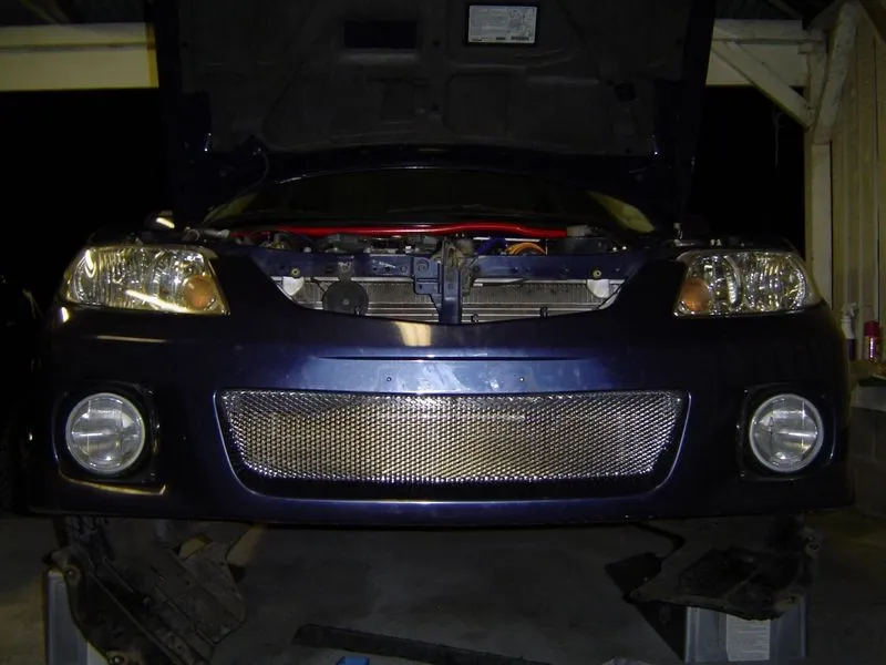

Bottom grill is tough..
you have to jack up the front of the car.. take off the top grill..
from there on.. it should be pretty easy..
Take off the air dam on the bottom. (the 'L' shaped plastic thing)
I forget from there..
I have a aftermarket grill on mines.. had to take off the old one to do it..
