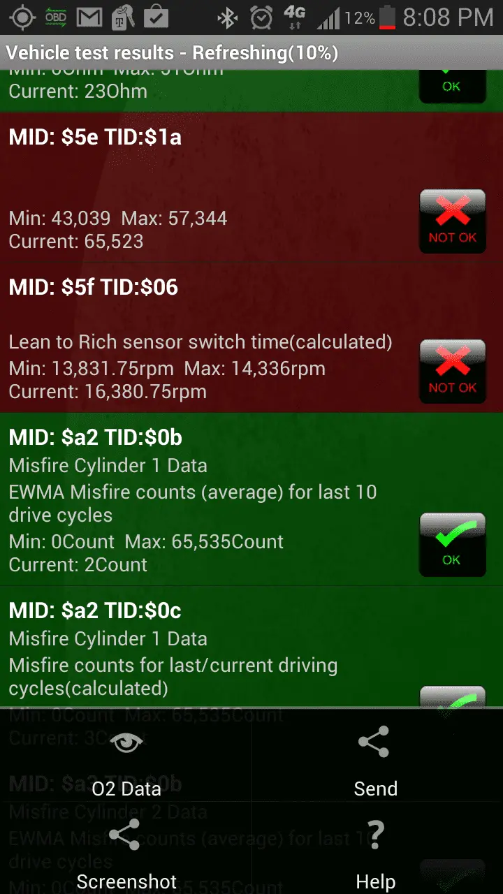

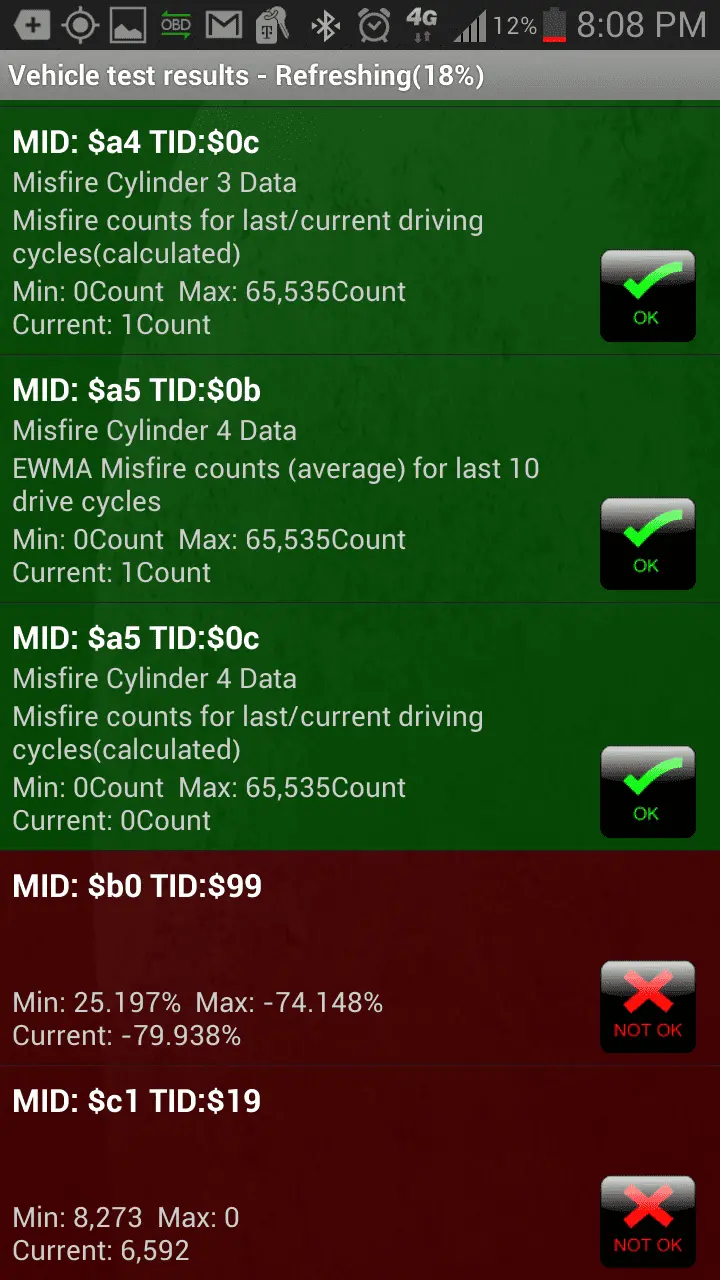

Apologize if this is the wrong place to post but need help. I own a 2011 Mazdaspeed 3 50k miles. Its stock and I've been having this issue whenever I give the car gas. The rpms seem to either stutter or sluggish sometimes when I try and give it gas. I ran the torque app with an obd reader and came out with these readings which I attached.
Spark Plugs-Brand New. I read this meet have been the reason behind the sluggish/stuttering rpms but installing news one didn't help.
Air filter-Changed less than 1000 miles ago.
Fuel Injector service-done at 44k

you should try to get your hands on an Accessport and see whats going on. could be a lot of things. maybe low fuel pressure?
Take a look at your turbo inlet pipe mine cracked rite near the turbo and I was getting a random misfire cel also felt like a bad spark plug when I was In the throttle
